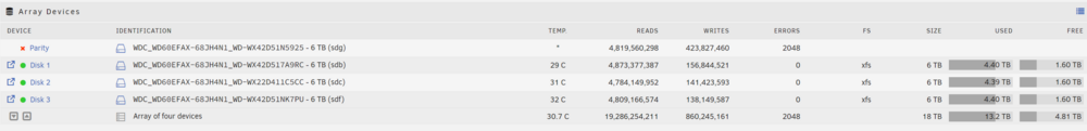

I woke up this morning with an email from the unraid tower :
Event: Unraid Parity disk error
Subject: Alert [FORTRESS] - Parity disk in error state (disk dsbl)
Description: WDC_WD60EFAX-68JH4N1_WD-WX42D51N5925 (sdg)
Importance: alert
Parity disk - WDC_WD60EFAX-68JH4N1_WD-WX42D51N5925 (sdg) (errors 2048)

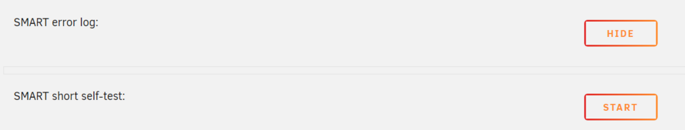

And I can not show the SMART error log as there is nothing to show:
I can't start a SMART extended self-test.

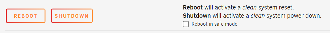

Dumb question What do you mean by "Full Power Cycle"?
Does the GUI Shutdown button perform a Full Power Cycle?
That's probably enough, but to be sure after the machine shuts down, I'd turn off the PSU if it has a switch, or pull the cord, then push the power button to drain the motherboard capacitors.
A full power cycle is when everything is totally shut down and started from scratch, as opposed to just a restart or reboot.
Sometimes parts need to be taken totally offline to get going again, they can get hung in a state where just a reboot doesn't do it.

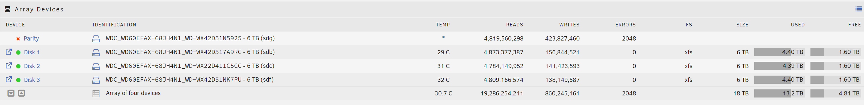

After a full power cycle and verifying all connectivity, I have acces to SMART log and a full SMART test is successfull but the disk is still in error state.
How can I recover this disk in a proper state?
