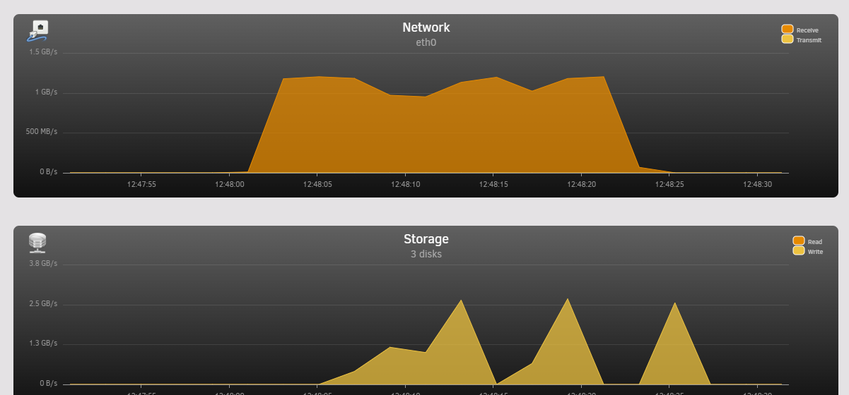

I just turned on Disk shares and copied same file to the main NVME cache and achieved ~700MB/s.  See below image.  What does this point to as the issue? I've created user shares on the main server that only have the same NVME drive for the share and get get the same slow speeds.
Going through FUSE (user shares) is always slower, whenever possible use disk/exclusive shares for better performance.
Why does the test transfer on the other server using user shares achieve the expected ~700MB/s but my main server does not?
