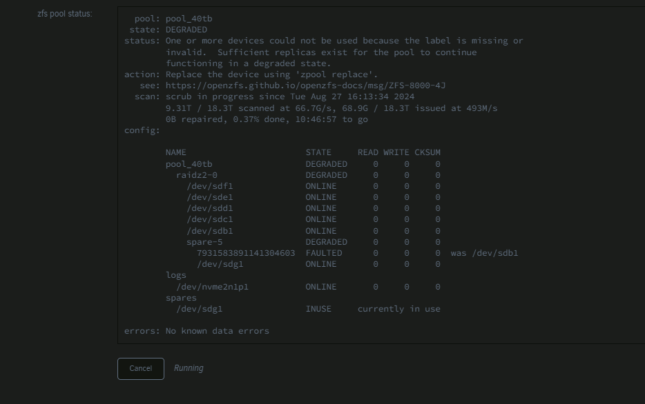

August 27, 20242 yr GUI does not yest support removing sub pools, it needs to be done manually, since the pool will need to be re imported and it's degraded, I would recommend you fix that first: NAME STATE READ WRITE CKSUM pool_40tb DEGRADED 0 0 0 raidz2-0 DEGRADED 0 0 0 sdf1 ONLINE 0 0 0 sde1 ONLINE 0 0 0 sdd1 ONLINE 0 0 0 sdc1 ONLINE 0 0 0 sdb1 ONLINE 0 0 0 spare-5 DEGRADED 0 0 0 7931583891141304603 FAULTED 0 0 0 was /dev/sdb1 sdg1 ONLINE 0 0 0 logs nvme2n1p1 ONLINE 0 0 0 spares sdg1 INUSE currently in use I can then post the instructions to removed the slog

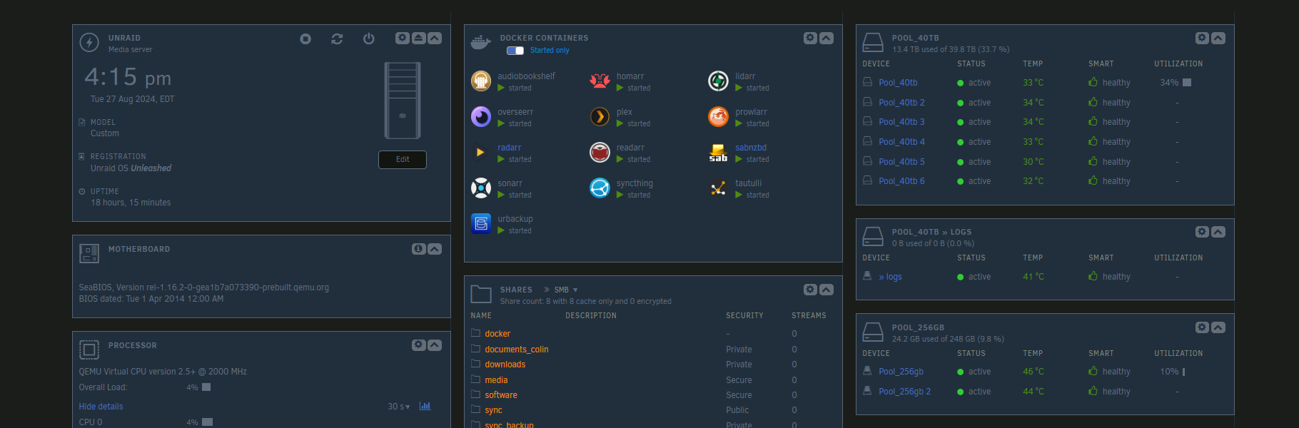

August 27, 20242 yr Author So I just got home and re checked and it still says the pool is degraded when I click on it. But on the main page it shows all the drives green and healthy. Which is correct?
August 27, 20242 yr 2 minutes ago, cmoney said: Which is correct? Zpool status is the correct one, GUI won't currently show most issues, do you have a spare to replace the faulted disk? Or do you want to use the spare permanently and remove it from the spares pool?

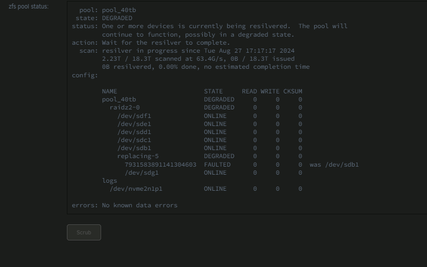

August 27, 20242 yr Author So I had a "Hot spare" already assigned to the pool when the drive failed. When the system didn't automatically swap out the faulted drive for the spare, I just removed the spare, and added it as the 6th drive in the pool. I figured it would re-silver and be all set. So there should be 6 good drives in the pool right now, and no hot spare. So to answer your question I thought I already did replace the faulted disk, with the hot spare. Did I do something wrong?
August 27, 20242 yr There's still a spare, see if you can offline the spare, then remove the spare, then use it to replace the faulted disk, I'm don't have a chance to confirm the commends at the moment, but it should be: zpool offline pool_40tb /dev/sdg1 then zpool remove pool_40tb /dev/sdg1 then zpool replace pool_40tb 7931...etc /dev/sdg1
August 27, 20242 yr With the array running, or if you stop it you need to import the pool manually, either way, pool needs to be re-imported after, same procedure described above.

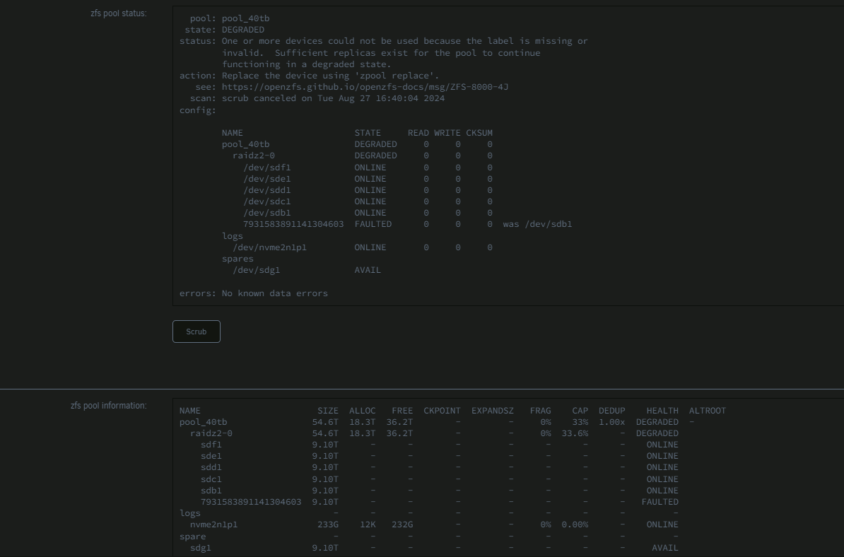

August 27, 20242 yr Author Roger that. I did it with the array started and The first command was fine. The second is kicking out this. "cannot remove /dev/sdg1: Pool busy; removal may already be in progress"
August 27, 20242 yr Author OKay now im getting this "cannot replace 7931583891141304603 with /dev/sdg1: already in replacing/spare config; wait for completion or use 'zpool detach'"
August 27, 20242 yr Author Yes I ran that command but it doesn't seem to give any feedback on if it was successful or not
August 27, 20242 yr Looks like it, you should then be able to remove the slog following the post above.
