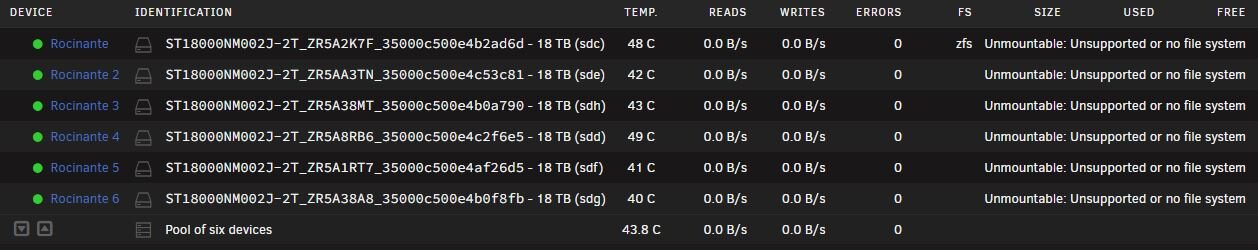

I have restarted my server and found that one of my ZFS pools is marked as degraded.

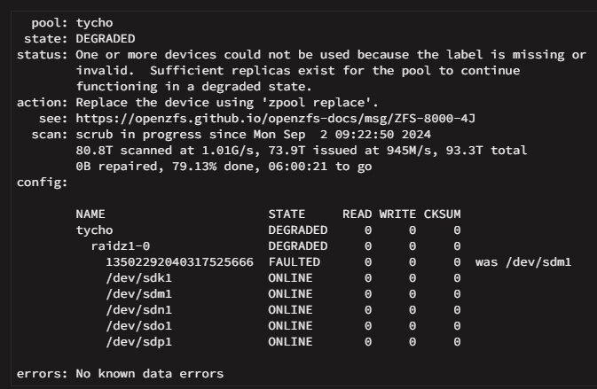

I have looked at the pool detail, and although Scrub is running (no apparent errors), one of the disks has a message stating “was /dev/sdm1”.
Because of all this, the pool is marked as DEGRADED.
How can I solve this problem?
This is the first time I have had such an error using ZFS.
Thank you very much.

Not sure how that happened but you have a device from one pool being used to replace a device from another pool:
NAME             STATE     READ WRITE CKSUM
    rocinante        ONLINE       0     0     0
      raidz1-0       ONLINE       0     0     0
        replacing-0  ONLINE       0     0     0
          sdc1       ONLINE       0     0     0
          sdl1       ONLINE       0     0     0  (resilvering)
        sde1         ONLINE       0     0     0
        sdh1         ONLINE       0     0     0
        sdd1         ONLINE       0     0     0
        sdf1         ONLINE       0     0     0
        sdg1         ONLINE       0     0     0
    cache
      sdc            FAULTED      0     0     0  corrupted data
Wait for this resilver to finish then post new diags, there's also a problem with the the cache vdev.
