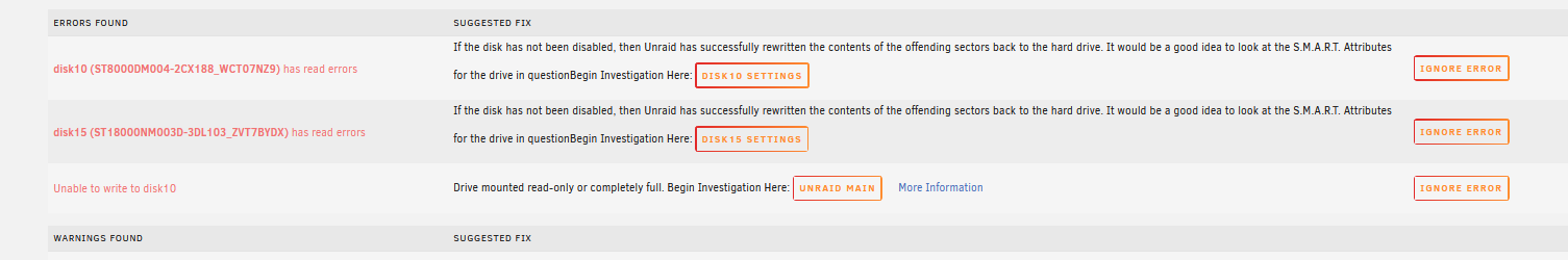

Seems I lost my shares when disk10 said it was unable to write to it
After reboot. disk10 seems to not have any data on it even though it shows nearly full. other drives I'm able to navigate to the data

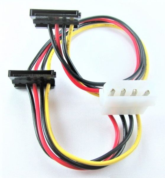

I try to avoid splitters as much as possible, but I do use them with some server, but never to split one plug to more than two, like this:

So the shares disappeared again!! I don;t know what to do manmedia-server-diagnostics-20240906-1822.zip
One drive with read errors knocks my whole array out (shares at least). Read errors are sata data or can be power too? Confused
