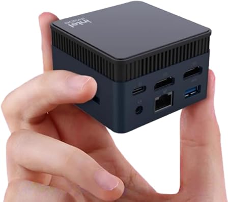

I'm new to this and I have something to ask before purchasing.
I wonder if it will work if I install it on the miniPC below? I will connect 2 SSDs and 1 HDD to this miniPC via USB.
Am I doing it right or am I doing something wrong that I don't know about?
It says Intel N100, 12gb LPDDR5 ram, 512gb M.2 2242 NVME SSD

As for the OP, it doesn't sound like you're trying to build a traditional NAS, more like a mini PC that happens to have additional storage attached. Considering the hardware you've mentioned, yes unraid does not appear to be a good fit and I feel like you've limited yourself in your hardware choice. I would never trust a server that's supposed to be on 24/7 that's dependent on detachable storage let alone USB connections. What if a child/pet manages to unplug that storage while it's miduse? Feels like a recipe for disaster to me.
A SFF PC with enough space for 2-3 drives internally would be a better option but I foresee this being outgrown over time but that bridge can be crossed when necessary. Regardless, I do wish you check out unraid again in the future since it truly is a versatile option for a dedicated server at home.
