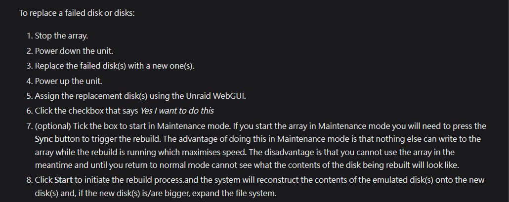

Not seeing where the rebuild option is?
As step (8) said, click "start", then it will rebuild.
And you may need an extra step, stop array then unassigned the emulated disk and start array, then stop.

I have the server stopped and  I see the box to put in maintenance mode, but where is the other box I select for sync?
Could you capture the array screen after " unassigned disable disk ( disk 4 ? ) then start and stop array "

If your disk is good and you are rebuilding on the exsisting disk
1. Stop the Array
2. unassign the disk with the x
3. Start the Array
4. Stop the Array
5. Re assign the same disk
6. Start the Array
The rebuild will start and rebuild on the disk

For reference the procedure is documented here in the online documentation accessible via the Manual link at the bottom of the Unraid GUI.  In addition every forum page has a DOCS link at the top and a Documentation link at the bottom.   The Unraid OS->Manual section covers most aspects of the current Unraid release.
