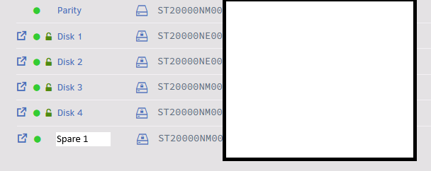

It's been discussed in a few threads but I don't see an actual FR thread for this.
I'd like to propose the creation of a 3rd disk type for an UnRaid array. Presently there are data and parity disks but I'd like to see spare get added as a type. This would be a disk which must be equal to or less than parity and it would sit idle/spun down until needed. My request is a single Spare but I suspect the logic to do 2 x Spare wouldn't be vastly different. This would also coincide with the array supporting 2 x parity.
Upon array drive failure within an UnRaid array:
  • The system would perform two checks
    • spare's capacity is equal to or greater than the failed disk
    • spare's capacity is equal to or less than installed parity
  • The system then modifies the array config to remove the failed drive and replace with the spare. This concept sort of already happens when a disk fails while array is up with emulation taking over automatically.
  • The system begins a data disk rebuild and the user can now decide whether to replace the dead disk as new spare, reinstall the dead disk as spare, or do nothing.
