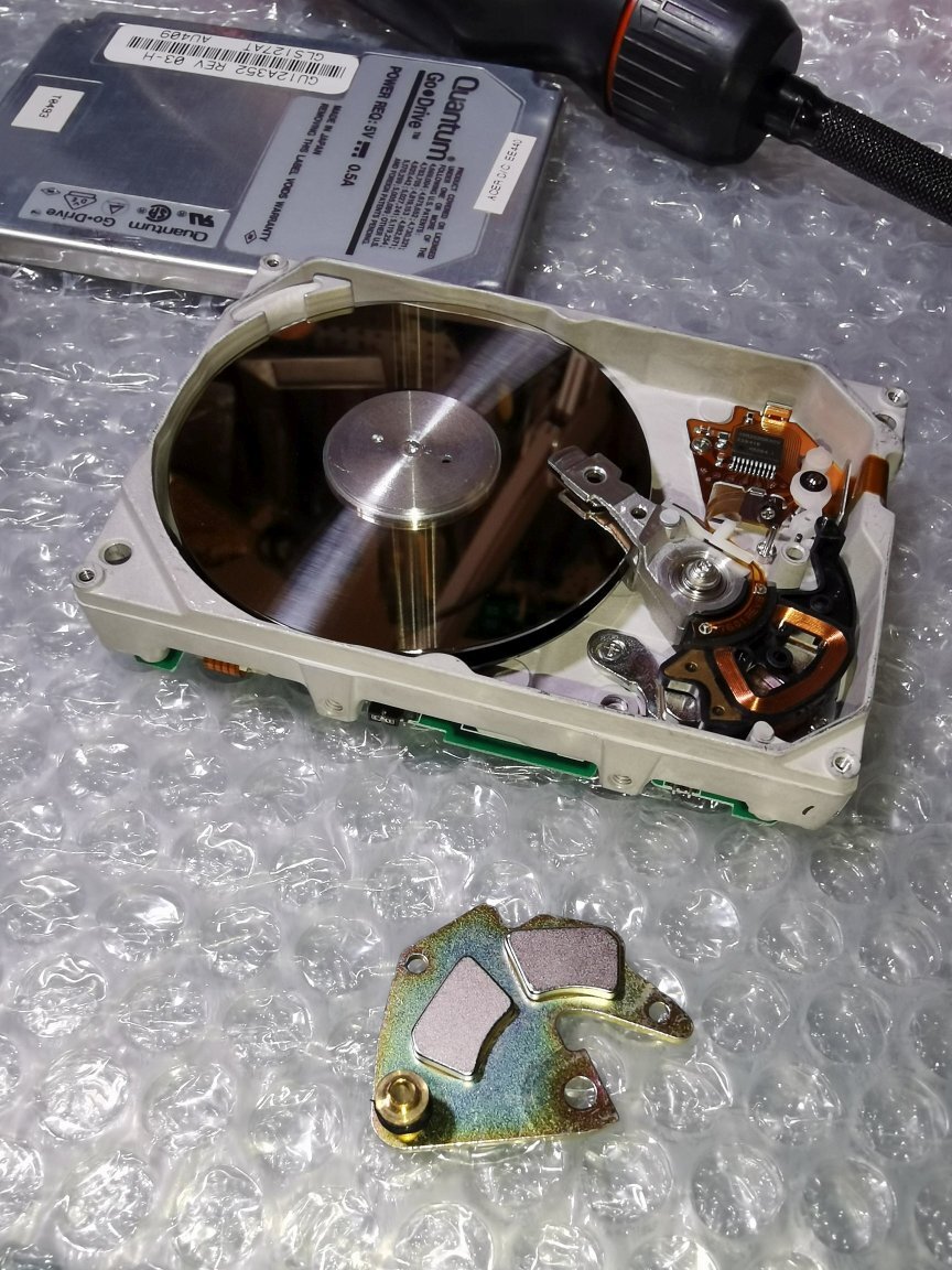

I would imagine that the lubricant used on the spindles has hardened which prevents the spindle motor from being able to spin the platters up.  Exercising the hard drive by periodically spinning up the drive may prevent this from happening.  Any mechanical device that moves will eventually seize up without periodical movement of all its moving parts whether it is a steam engine or a pocket watch.

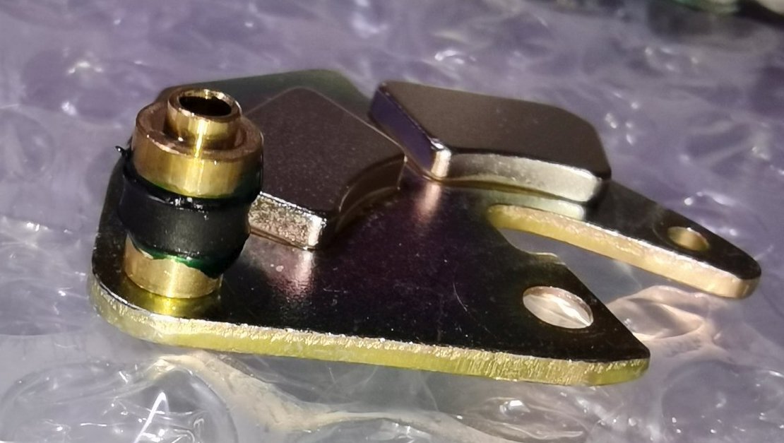

More common in drives of that era is the rubber damper for the head actuator end stop degrading and turning into sticky goo, then the actuator isn't strong enough to free itself from it. Fixed a few drives with that issue.
@Kilrah, thanks for another failure mode from inactivity.
