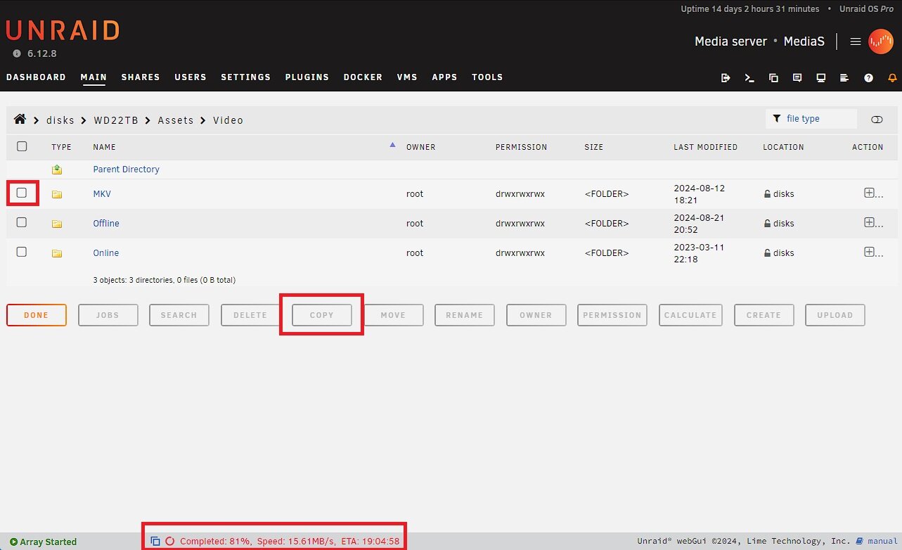

After some research I discovered I could use Unassigned Drive package for Unraid and plug my external drives directly into USB 3.2 port on my UnRaid box ... thinking this would be faster than going across my LAN from another PC.  Installed UD, mounted external drive, selected folder on it and selected destination on my share and hit Copy.  Sadly it mimicked exactly same performance as I experience via using my PC going thru my LAN ... starts out at 200 MB/s and then soon drops to 50 MB/s.
Puzzled, USB 3.2 is rated at 2500 MB/s ... so why am I at 50 MB/s?

Interesting, thanks for the suggestions.  Now, how do I stop my transfer so I can test this out?  I can’t seem to find any place where I can cancel my copy?  I can see the copy status if I click on the Unassigned Drive in Main but can’t find any UI area to stop/cancel the copy?
What app are you using to make the copy?
From USB PC via LAN to Unraid, I've tried standard Win11 Copy and Paste, cmd line xcopy, and a 3rd party tool called TeraCopy.
Direct USB on the Unraid server I use the following:
And
You can cancel that, not sure about DFM since I've use it very little.

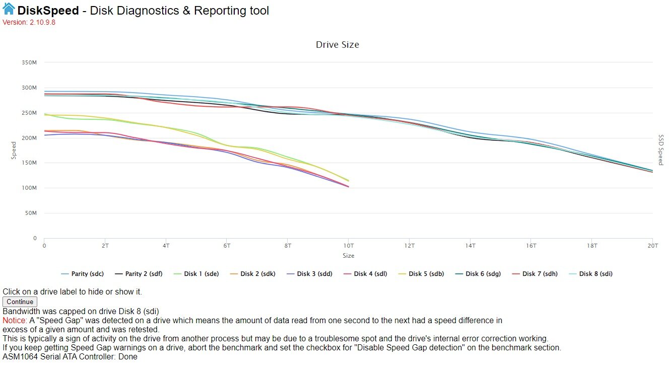

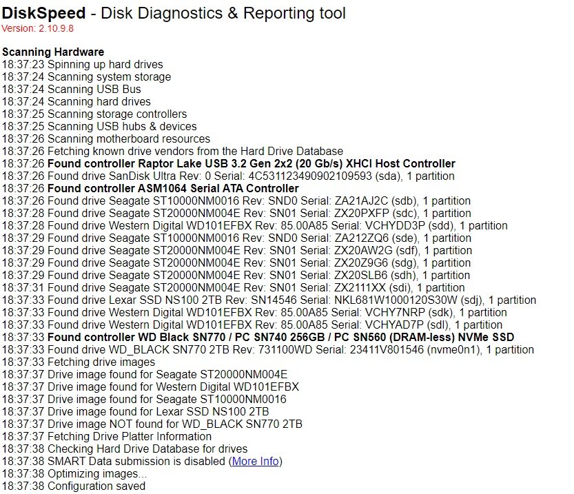

I will give that package a try and report back.  I do have 12 drives - 2 largest ones set to parity.
Here are the DiskSpeed test results.  I don't see anything unusual except some warning about a "gap"?
Drives:
