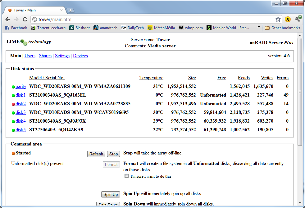

I regularly check my unraid for errors and today I end up with this (see attachement). I have 2 drives that had errors (one had 49 errors and the other 14).. both drives show a temperature of 0*C. The one with 49 errors has a green marker and the one with 14 errors has a red marker. Not sure if I should've done this but I stopped the array and started it again. Now both those drives show as unformatted.
I know that 2 bad drives in an array is normally pretty bad. So I'm asking, what would be my next step to recover the data? Anyway to tell unraid that one of the drive is fine so I recover that one and then the other? I'm just not sure what to do from here on...

Ok, so I shutdown the machine, removed power cord, waited and started it up again.. I heard one of the drive ticking (normally an HD Ticks once but here I'm talking multiple ticks). It stopped after ~10 ticks or so... I waited out but unraid never got online (couldn't ping the machine). So I decided to shut it down and unplug the ticking hard drive (of course it was one of the faulty drive, the one with the most errors). Now unraid gets online but of course its saying I'm missing a hard drive and the other one is still a red dot but now has a temperature reading. I attached the syslog from this bootup.
I also attached the smart report of the drive that has a red dot now that it responds to it. I'm thinking the failing drive was messing up with the data from this drive, hence why unraid saw errors from it as well.
So I'm thinking, is there a way to tell unraid that this drive is fine so I can swap out the failed drive and rebuild it?

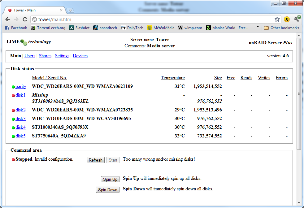

There might be, but I do not know how at this point. Does this drive say Unformatted?
Can't start the array, Too many wrong and/or missing disks!
So here's my plan:
Change the failing hard drive
Follow instructions at http://lime-technology.com/wiki/index.php?title=Make_unRAID_Trust_the_Parity_Drive,_Avoid_Rebuilding_Parity_Unnecessarily
Start the array, this should rebuild the failing/new drive and leave the other hd untouched... unless I'm wrong and there was actual errors on the drive.
What do you think?
Can anyone confirm that my plan is going to work or not?

The plan may work and I don't think you have any other options. What you need to first do is get the drive properly partitioned once before rebuilding since unRAID will only rebuild the data on the partition and not the whole drive. Likely, the best plan would be to make a new temp USB stick and boot that just so you can assign the new drive as a data drive and start the array once. You can format it too if you like but that's not necessary.
You would then use the trust my parity procedure but instead of using 99 you would use the number of the disk you want rebuilt, in this case 1. This command basically tells the unRAID whick drive to rebuild so the initconfig will reset everything to be good to start and then the set invalidslot command will tell unRAID to rebuild the partition on disk1 when the start button is pressed. The reason the disk needs the partition is that the partition command is normally given by the interface code before starting the rebuild but you have bypassed this.
You will likely have to run reiserfsck and do some fixing on both disks once they are back green and it's still possible you will not get back your data.
Be careful because it you do something wrong you can hose another disk.
