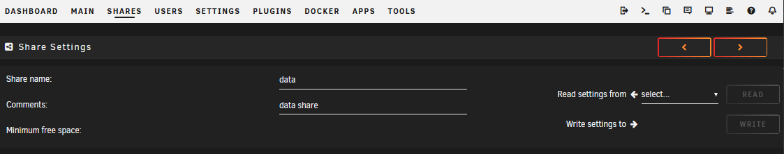

Share Settings does not show up in /data [Unraid 6.12.13/WebUI Error]
My sharing settings in /data no longer show the options.
This happened after changing the option from High-Water to Most Free, as one of my disks was always full and the others remained below half full. Can anyone help me?
Solved by JorgeB
Floor setting is invalid:
shareFloor="10GB"
Did you enter this using the GUI or manually?
To correct the issue edit /config/shares/data.cfg and set it to 10000000

Gotha
I edited the file and now the settings are showing.
I enter it using the WebGUI.
Thank you very much
Do you remember what value you entered exactly? '10GB' would be converted to 10000000
