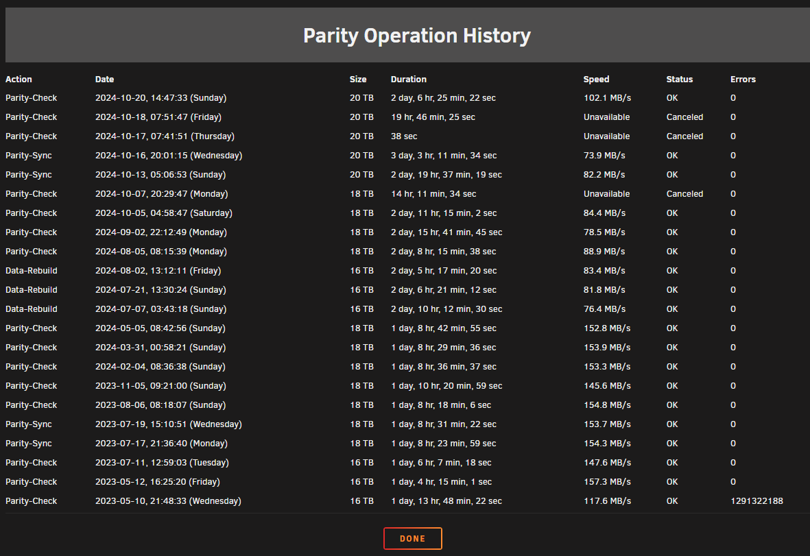

Parity check/rebuild speed halved going from 9211-8i to 9207-8i + Intel RES2SV240
I just swapped one of my 18tb parity drives for a 20tb and damn, it took a long time...almost 3 days.

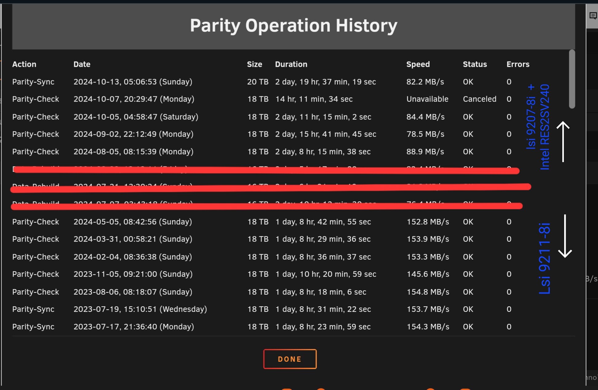

When i was looking at the history, it looks like around the time that i swapped from a 9211-8i to a 9207-8i with a RES2V240 sas expander my speeds dropped quite a bit.  Those red strike outs were 16tb disk rebuilds due to a bad connection, those rebuild speeds were 76-83MB/s.  figured i'd look into it before i swap the second parity for a 20tb and start the rebuild.
I'm using dual link cables between the hba and the expander card and sas to sata breakout cables on the other 4 ports of the expander.
Is this expected speeds or is something that i can look into.
The server isn't doing a crazy amount of work during this last rebuild of th 20tb drive, normal arr's and plex.  I did have the syslog server running since i was having an issue, but its now fixed (fingers crossed).
One last thing, when i did the parity rebuild with the new 20tb drive it said "Data Rebuild Complete (0 errors) and next to it under Description it said "canceled", is that normal?  I didn't cancel anything so it should have finished just fine.  On the Main tab both parity drives are green.

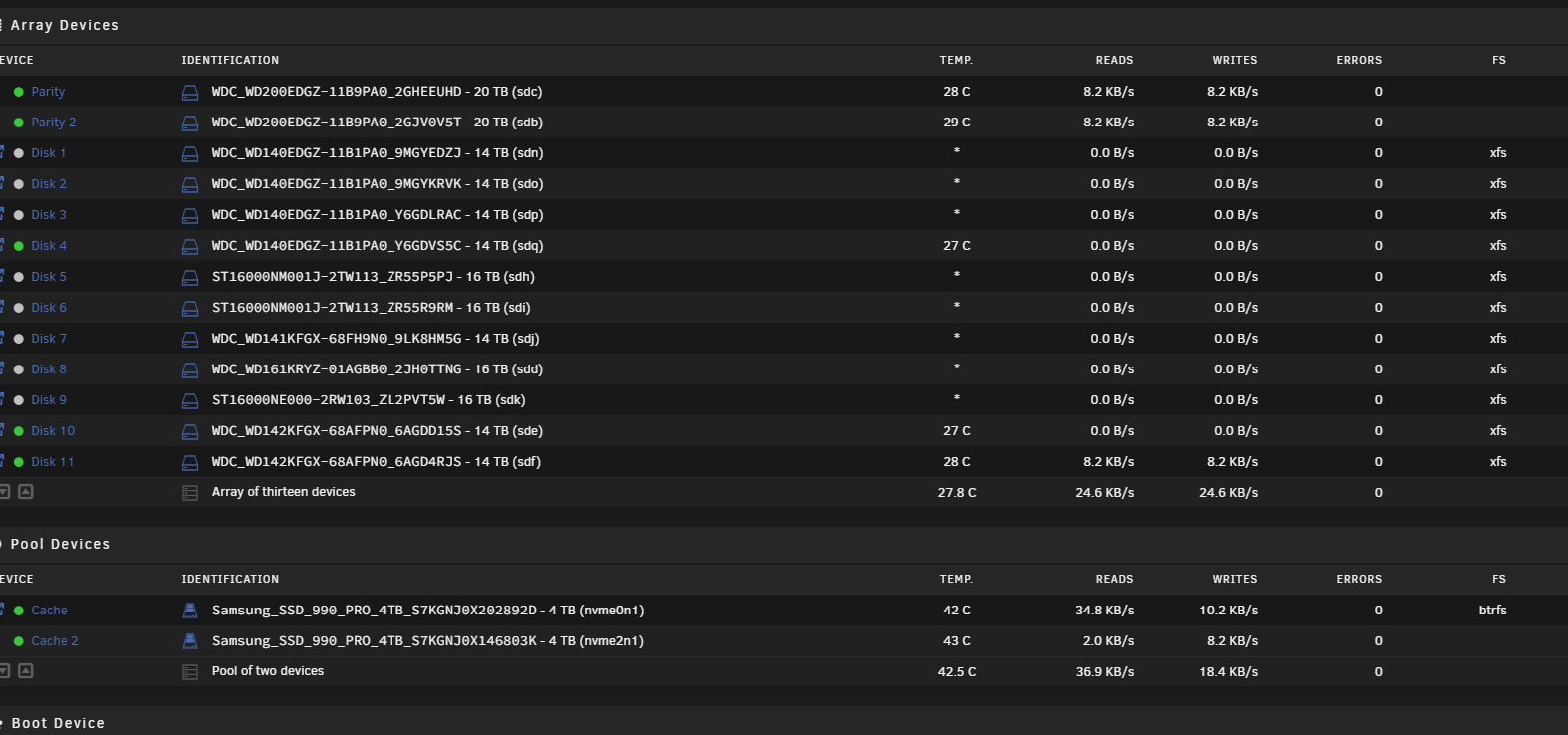

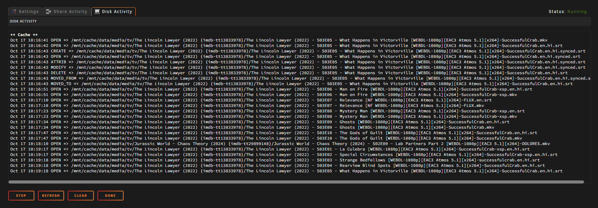

I'm trying to figure out why something is reading/writing to my last drive or 2 and the parity about every 3 seconds.
I thought it bazarr looking for subtitles since there are so many .srt files in the disk activity but i stopped the bazaar docker and its still doing the same thing of read/write to both parity and disk 11 and File Activity (shares activity and disk activity) is just blank after i cleared it.
Got any tricks to figure out what the hell keeps writing to disk 10/11 and parity drives?  i'm sure a constant read/write isn't helping my speeds any.
I attached an updated diag in case it would help
tower-diagnostics-20241017-1031.zip
Try stopping the docker service, if it helps, then stat one container at a time.
So i just stopped all the dockers one by one and it might be tautulli...it definitely helped with the read/write of both parity and disk 11 but didn't fix it completly.  I'm still seeing the read/write but its like a few minutes apart instead of every 3 seconds.  still not enough to let the drives spin down after 15min
One thing i'm noticing is that when i start/stop all dockers, its pretty dang slow.  I dont remember it taking this long to start/stop 9-10 dockers.
Edit: i just started up all my normal dockers, except tautulli and its back to reads/writes every second or so.  Frustrating!
Edit2: I figured it out, i had the docker image on the array for some reason.  I moved it to the cache and it seems like its no longer spinning up disks.
Edited by danimal86
22 hours ago, JorgeB said:
A parity check should be a good test, especially for the disk/controller errors.
So i let the parity check go overnight, hoping it would be faster than it was before but it seems like my issue is not fixed.
Over the 14.5hrs its been running, its checked 4.21tb.....so around a speed of 60 MB/s
I've gotten 3 crc errors on Parity 1 drive (sdc), i hadn't had that happen before.  I believe that i have the two parity drives plugged into the mobo not through the hba.  I'm sure the diag shows disk errors, are there errors on disks other than sdc?
I'm thinking i'll go ahead and stop the parity check and try reseating the cables to sdc and switching the port on the mobo.  think thats a good idea?

I used brand new Sabrent sata cables for parity 1 and disk 2 and plugged them directly into the motherboard sata ports.
Parity check didn't start automagically so i started a new one.  I'll let it run for a while an post up a new diagnostic.
