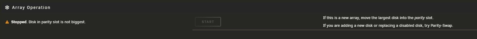

Stopped. Disk in parity slot is not biggest.
I have two identical drives and have been pulling my head out trying to get this sorted.

Solved by Hypnosis4u2nv

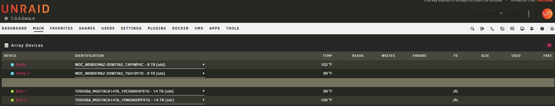

I missed that in the screenshot you have 14TB as data and 8TB as parity, that won't work, it will need to be the other way around.

Any parity drives must be at least as large as the largest data drive.   If you want 14TB data drives in the array then both parity drives would need to be 14TB.
Seems I misunderstood how the parity settings works on Unraid. I thought assigning two drives to parity and parity 2 would sync between the two, instead its Parity + Disk Slot. Duh. Thanks for the help.

It's good thing that I have a few spare drives around to play with different NAS OS's to find one that works for me the best while I'm on a trial license. All my issues were user error and because I didn't understand how disks are handled in Unraid even though I did understand that parity only works with drives of the same size or larger. The biggest contributing factor was that I was totally wrong on how Unassigned disks work in the OS. I assumed that they HAD to be assigned to the array in order for me to use them. Once I figured that they didn't have to be assigned, I could use the 8TB drives in parity while also using the 14TB drives outside of the array and it wouldn't give me the issue of the biggest disk not in the parity slot.
