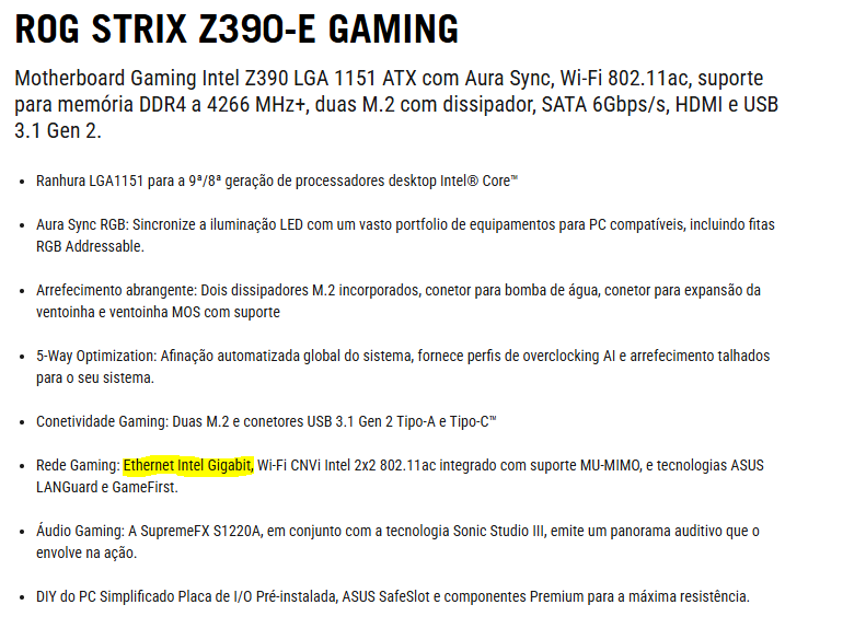

December 12, 20241 yr Author the motherboard has a 2.5 GBS ethernet port. I also bought a 2.5GBS switch and my computer also has one. I was expecting more speed.
December 12, 20241 yr Solution 2 hours ago, Punisher said: the motherboard has a 2.5 GBS ethernet port Then you posted the wrong diags: 00:1f.6 Ethernet controller [0200]: Intel Corporation Ethernet Connection (7) I219-V [8086:15bc] (rev 10) DeviceName: Onboard - Ethernet Subsystem: ASUSTeK Computer Inc. Ethernet Connection (7) I219-V [1043:8672] Kernel driver in use: e1000e Kernel modules: e1000e
December 18, 20241 yr Author Thank you for your reply. I got my facts wrong regarding my ethernet port. sorry about that. In the futur is it possible for me to add a 2.5GB ethernet card ?
