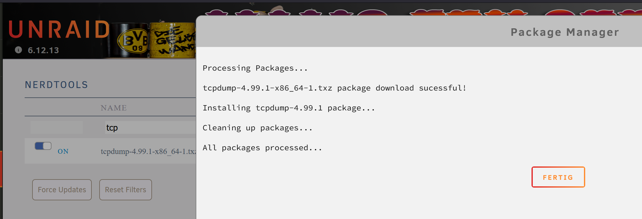

This would be quite tricky because some of those docker networks may not be accessible from the main unraid. Also, tcpdump needs interfaces in special ("promiscuous") mode, again, some of those pseudo LANs may not offer this mode.
But I agree, tcpdump is a very helpful tool for network problems. But it also is a complicated one, not suitable for the normal user... I don't believe they will ever include it into the os.
But you can use either nerd-tools (as long as it still exists) or drop the package manually into the /boot/extra folder to get it installed automatically after a reboot.
