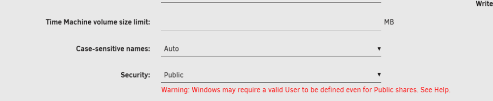

I am at a loss here. I created a share in Unraid. I can access the share with the username and password given from my computer with no issues. I typed the same IP address, username, and password in Protect and I keep getting Failed to connect to server.
Has anyone been successful connect Protect to Unraid for backup? I see a bunch of stuff around Synology but not much around Unraid.
To add, the username and password have no special characters or uppercase, everything is lowercase.

Export: Set to Yes (SMB)
Security: Set to Public, Secure, or Private:
For testing, start with Public to rule out permission issues.
If using Secure or Private, ensure the correct user permissions are set.

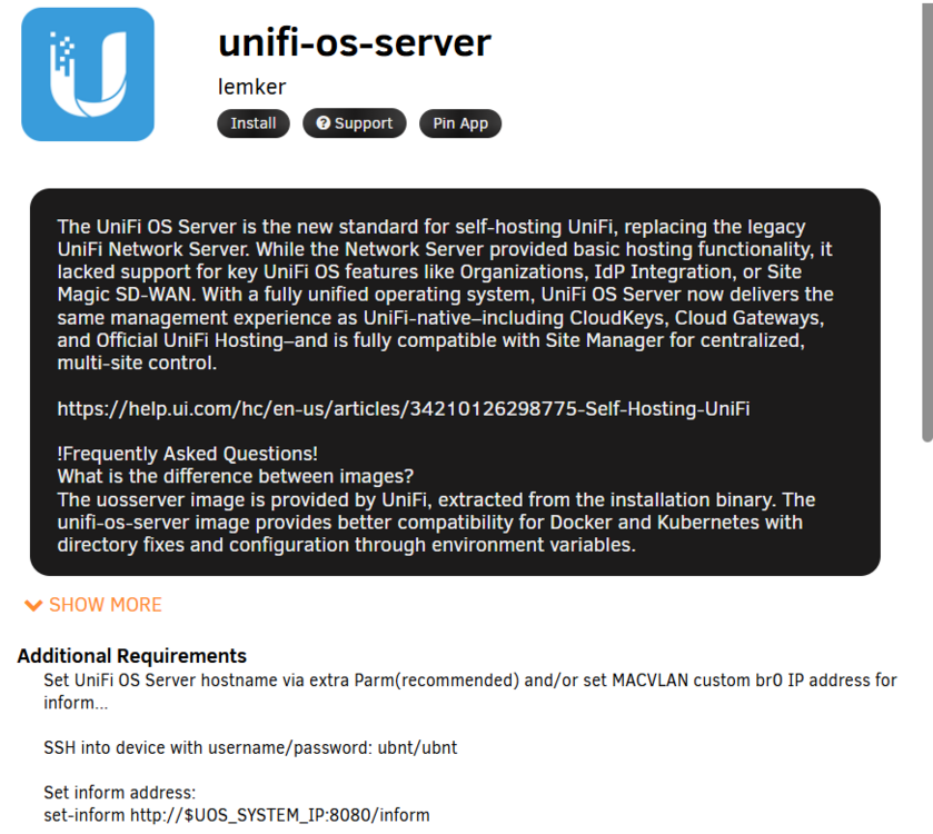

with the release of unfi OS for a VM I would recemd runing a debain VM and ther unfi stack there any more...
ITAdOn IT Solutions
No image preview
Ubiquiti introduces UniFi OS Server for self-hosting
Ubiquiti has just launched the UniFi OS Server in Early Access, enabling users to self-host the full UniFi network stack on their own hardware.
And data here
GitHub
No image preview
GitHub - lemker/unifi-os-server: Run UniFi OS Server in D...
Run UniFi OS Server in Docker or Kubernetes. Contribute to lemker/unifi-os-server development by creating an account on GitHub.

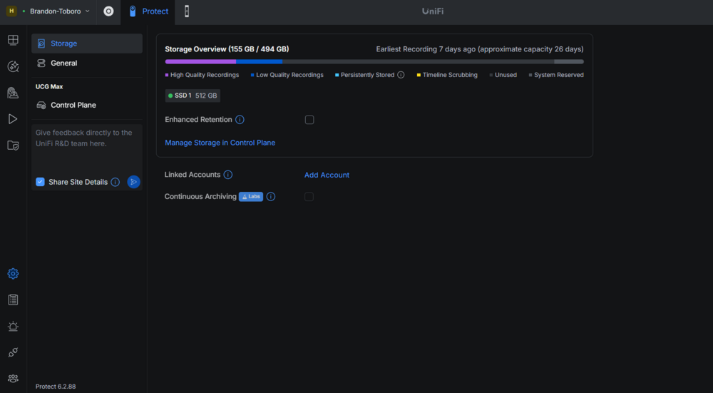

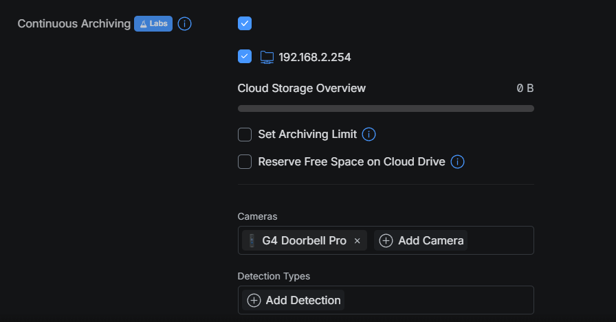

Hi hi!
Thanks for your reply.
I've added this line in unraid setting (see screenshot)
Uploading Attachment...
For Unifi protect, see attach screenshot, seems like it can connect to unraid and select share folder but it just reflect as 0 b
So im not sure what is wrong.

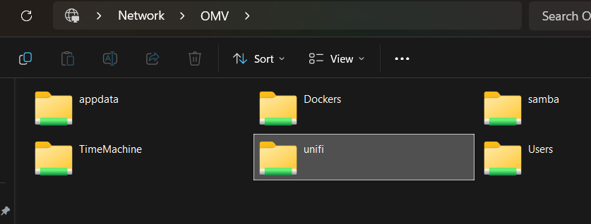

so now I have a share called unifi from my unraid system...
Since your seeing a connect but no data... you may need to fix / set permissions...
root@OMV:/host# chmod 777 -R unifi-protect/
root@OMV:/host# chown nobody:users -R unifi-protect/
You should now see a unifi share in unraid:

in unifi protect go to settings:

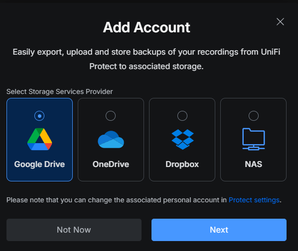

I first go to add account
then select nas:

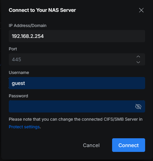

and fill in data:

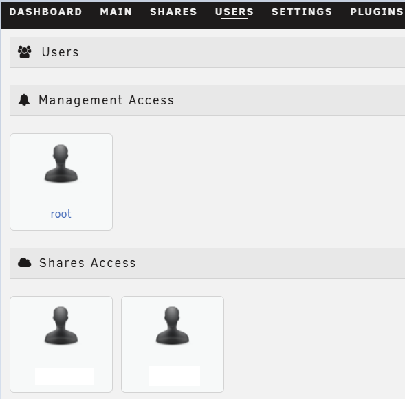

*Connect with a made unraid user.. made in the users tab in web ui:

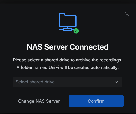

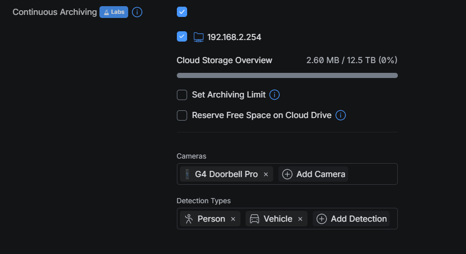

choose the share:
with that the nas folder is linked:

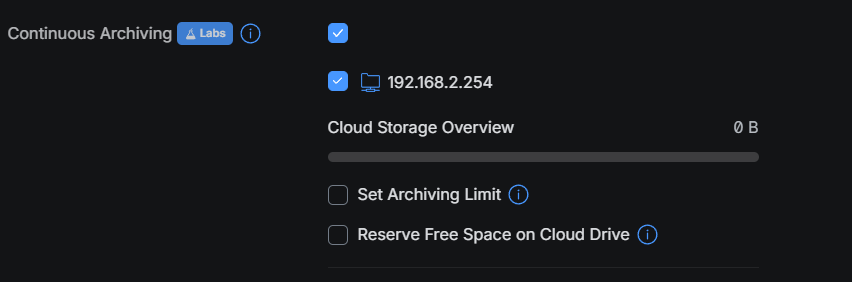

then enable Continuous Archiving and add the cameras you want data saved to protect:
select dection....
click apply
0b is normal to see...
as the Continuous Archiving kicks in once the unifi device hits its limit on space / quota..
see

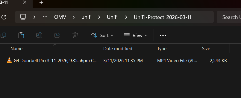

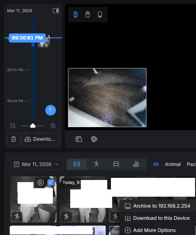

you can test archive by foring a archive...
go to playback and select a detection..
and with the selection hit archive to nas ip / unraid...
{AFE45036-33C2-468B-AE0E-91BE4FF8ECAE}.pngit...
thats it you will then see the detection on the unraid nas...
so the 0 bytes is noraml .. and current detections need archived and new should auto once quot/retention is hit.
takes a while for it to report and update data... if you manualy sent detections...
