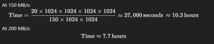

The time it takes to build a parity drive on a 20TB HDD for the first time depends on several factors, including the speed of the drive, the controller, and the CPU performance. Here are some key considerations... Typical Speed: Modern drives average between 150 MB/s to 200 MB/s during sequential writes (parity calculation is sequential)
min of 7 hours...
example:
Plan for 10–12 hours: For most systems with average modern drives, expect the process to take about 8–12 hours.

When Replacing a 16TB with a 20TB HDD
Parity rebuild times are proportional to drive size, not the amount of data stored. If your system performs optimally:
*Expect 18–22 hours for a 20TB parity rebuild, assuming speeds of 150–200 MB/s.
