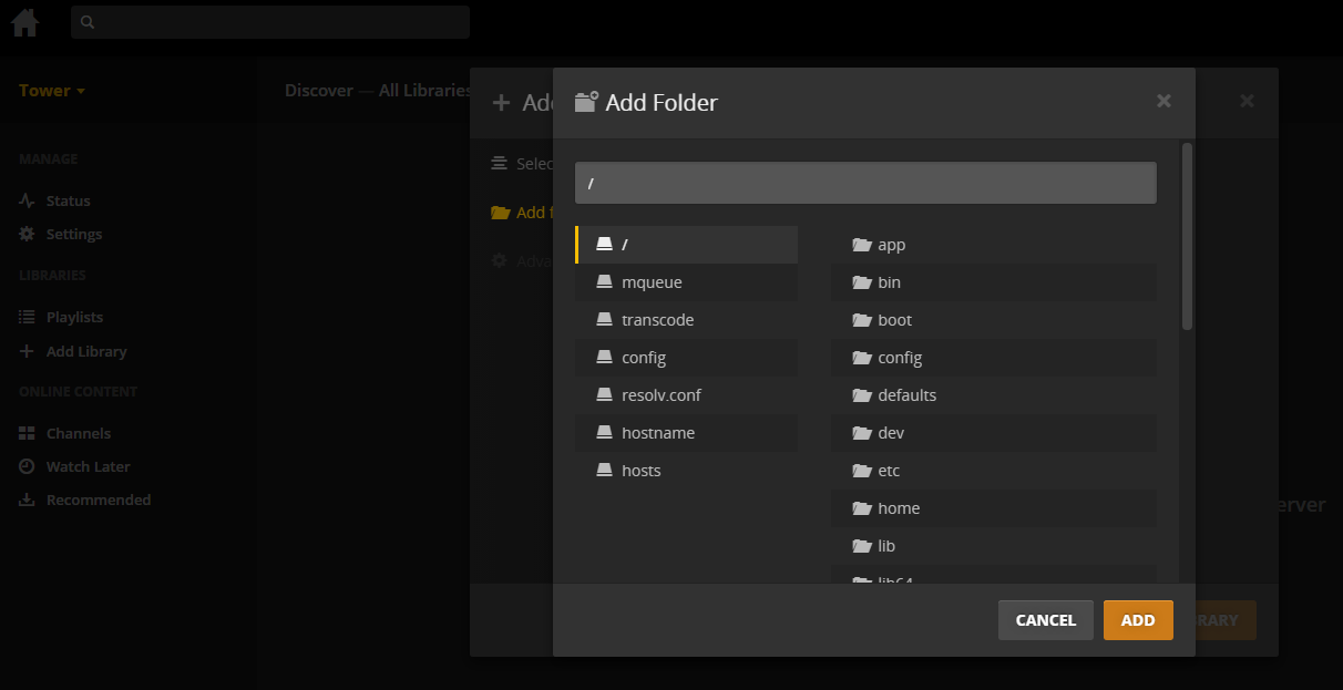

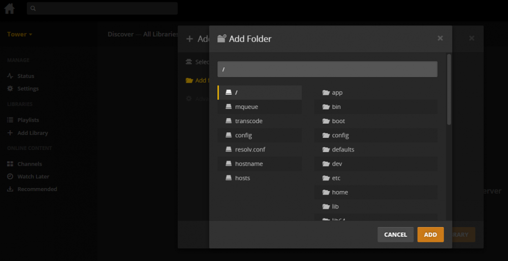

  7. I am trying to get Plex to work, and I am having difficulty getting the folders added. When i click to add the folder it is not giving me the "Tower", but appears to be giving me the root of the USB drive. I had this working before, but now it seems to be different, and I haven't been able to get Plex to see the folders. The only other place I saw was on Unraid where it says "add another port, path or variable"...this is when I edit the Plex Docker. What am I doing wrong, please?
