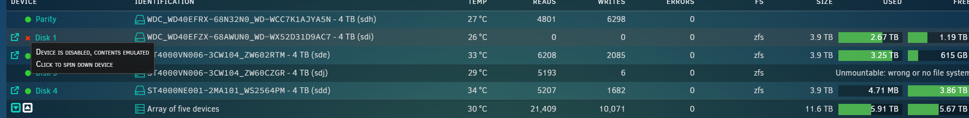

Hi, untill this mornig was all ok.
I had upgrade my system from 7.0Beta4 to 7 RC1 and now i have this error
Disk 3 ----Unmountable: wrong or no file system
how can i solve, without any data loss?
thanks

1 hour ago, Lordbye said:
Could be the cable?
Looks like a filesystem issue, not hardware, likely it won't work but try:
zpool import -o readonly=on disk3

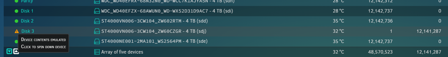

now i have also that
Unraid is not a backup, you should have backups of anything important, if you don't have one, try UFS explorer, and yes, you can run it with a Windows PC for example, just connect that disk to it, the free trial should show you if/what it can recover.
You can also try the emulated disk like mentioned, in case it works, but most likely it won't, but if you want to try that you first need to rebuild disk1

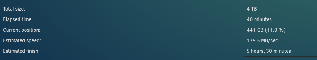

i have finish scan, but it doesn't copy files to my disk :(
on pc disk i have enough space for files :(

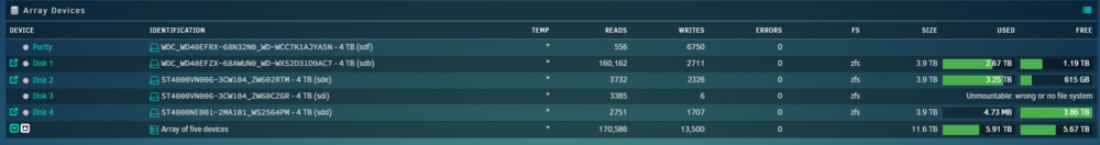

now disk 1 is rebuilding correctly..or it seems
Disk3 i'm trying like this..
I start in maintenance mode and tried to mount as unassigned device..no luck.
i put it back and now i'm in that
Hope to recover data...

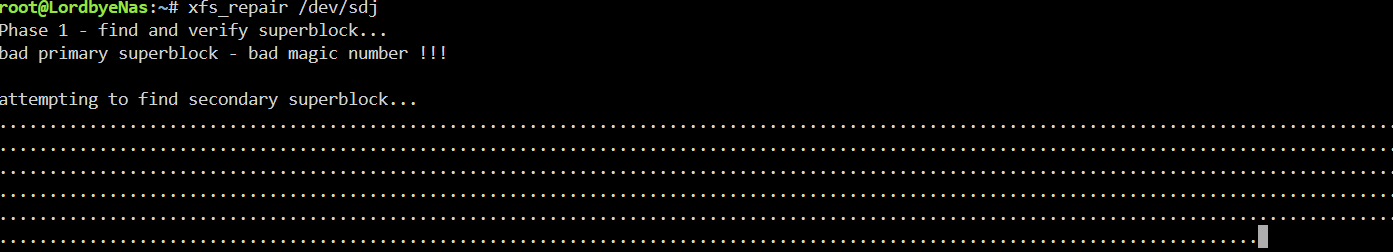

You used the wrong command when you tried the xfs_repair  via the CLI as you got the device name wrong (a not uncommon mistake)!
You should try again doing the check filesystem via the GUI (to avoid a mistake in the command) and let us know what the output of that is,
/dev/sdj was disk3

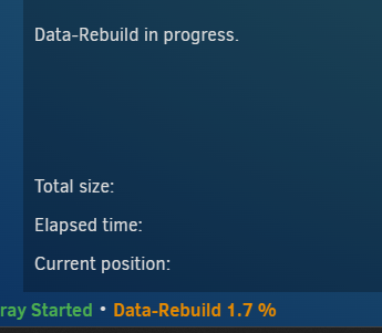

now system is "rebuilding" data on disk3...hope after it will be ok...

1 minute ago, Lordbye said:
/dev/sdj was disk3
now system is "rebuilding" data...hope after it will be ok...
Note that if a disk shows as unmountable before starting a rebuild it will show the same at the end and still need you to run a check filesystem to rectify this.  WE typically recommend that is done before starting the rebuild for this reason.
ok so try to chek disk with
xfs_repair /dev/sdj (disk3)
or xfs_repair -v /dev/sdj
The disk was formatted with zfs, xfs_repair won't do anything.

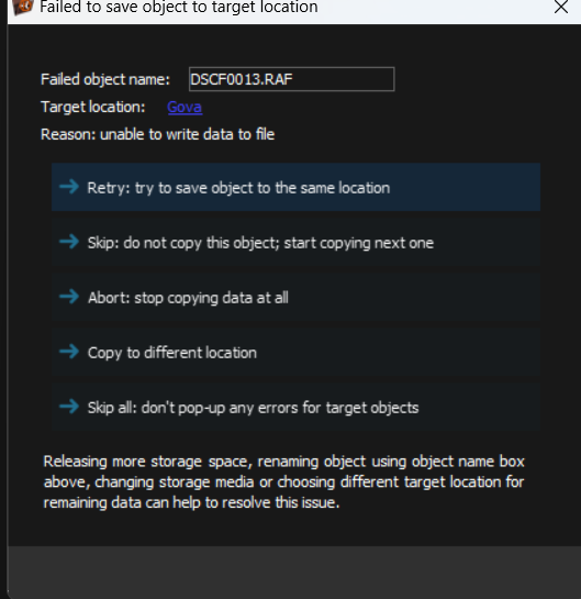

I assume that's from UFS explorer?» You would need to contact their support.
i  tried but i'm still waiting an answer

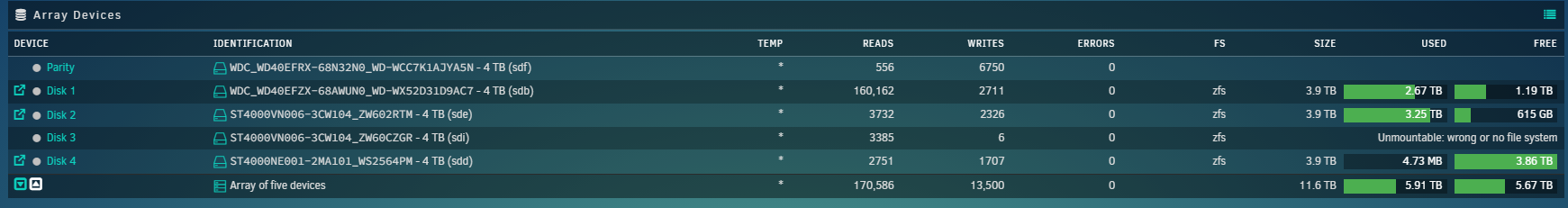

it finish now and
in the disk if i try scrub, i can't because it is greyed
Edited by Lordbye
40 minutes ago, Lordbye said:
it finish now and
Did you miss this?
Scrub only works with the filesystem mounted, so it cannot help, your best bet for data recovery in this situation is UFS explorer, or another similar data recovery app that supports zfs.
