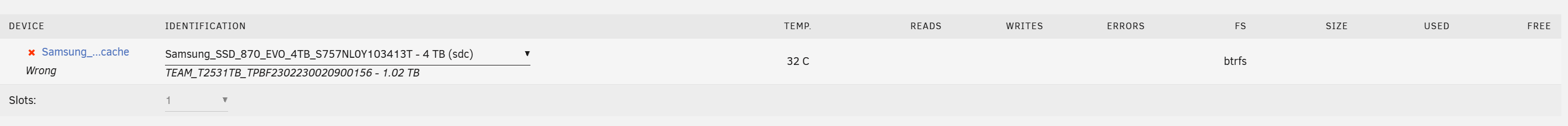

When I tried that it told me I was "wrong" and prevented me from starting.
I copied ssd cache ->nvme cache using file manager
stopped the array
unassigned the ssd cache and assigned the nvme cache to the prior SSD slot.
When I did that I get a red X and it says "wrong"
It wont let me add a different drive to a slot used by a prior drive.

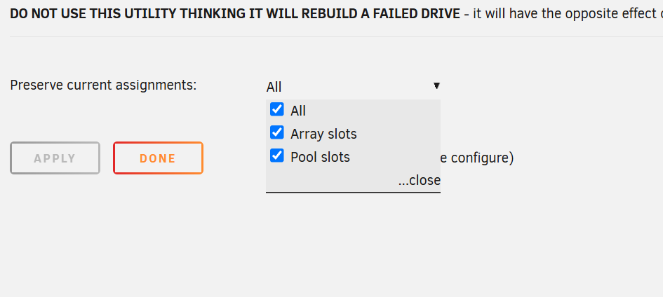

I am way past the easy fix at this point and I created a "new config" to allow me to assign the new cache drive.
Once it complete I'll post some pictures hopefully it makes it more clear.

I wish it would have been that easy but it would not allow me to do that. When I tried their was a big red X next to the cache drive and it stated "wrong"
You just need to check the "I want to do this" box next to array start button, again assuming v6.12

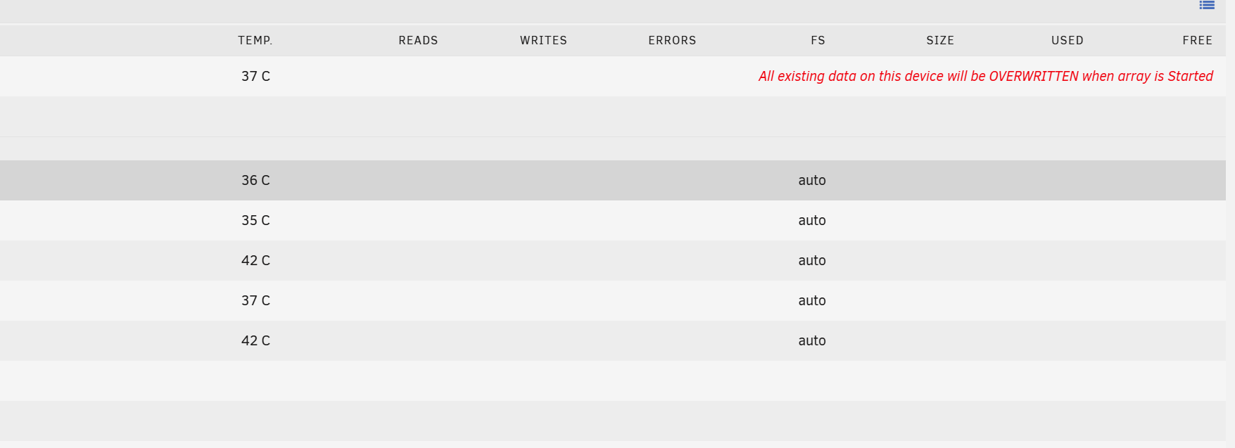

No way to change cache drive without rewriting parity
So this is annoying. I want to change a cache drive and I MUST recalculate parity
I swapped in a larger cache drive
Chose preserve current assignment
Then go to start the array
For those saying you can swap out the parity drive without a costly parity rebuild IDK know how you folks are accomplishing that. That information does not seem correct.
There is, something is not correct.
You must check the "parity is already valid" checkbox nest to array start button.
It still says "will be overwritten" on the parity drive line but that's not actually going to happen in this case.
Edited by Kilrah

The message about overwriting parity when formatting needs some slight rewording to make it clear it only applies to formatting a drive that is part of an Unraid parity protected array - it does not apply to formatting a pool.   It was originally introduced when the only use for a pool was as a 'cache' drive and to stop people thinking that if a drive showed as unmountable in the main array it needed formatting when instead the correct action to take was to try and recover the file system.  When formatting a pool the existing contents are simply overwritten (no matter how many drives make up the pool).

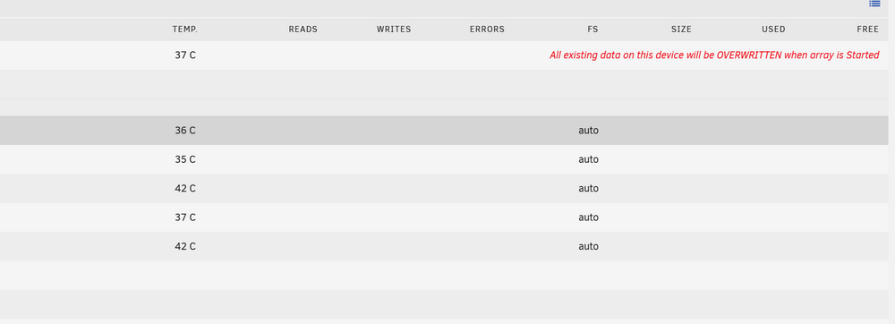

This has bit me twice when swapping out a cache pool for a larger cache drive. 1.3 days to rebuild the parity. Hopefully you folks can improve this in the latest update (wether that is improved documentation or a more user friendly GUI IDK). I didn't see anyway to proceed without rebuilding the entire thing. So sucked it up and rebuilt the parity. I couldn't restart the array without agreeing to restart parity.
