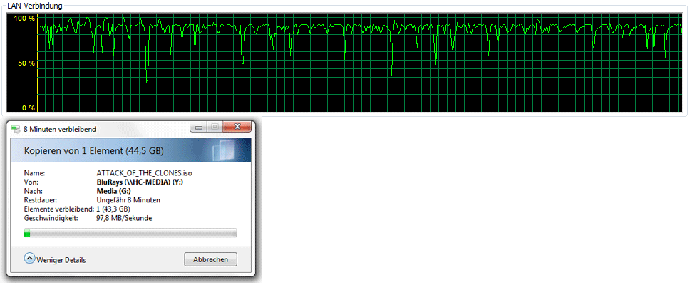

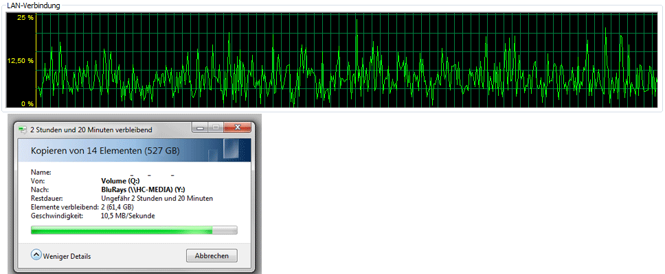

The system is working, but the write-performance to the server is bad. In average I am getting 10.5Mb/s when writing to the server. Reading gives me an average of 90-100Mb/s, so I think it is not a problem with the LAN or something.
I tried writing with Windows 7 on SMB and also tried writing with Ubuntu on NFS, both gave me the 10.5Mb/s average.

The only thing that changed something was option 5. With the second NIC on the board I get a better performance now (about 25Mb/s). BUT at the moment (the only data drive is quite full now, 200Gb free), I am getting always an error when copying new files to the server: "There was a problem with the network resource." Any idea about that?
