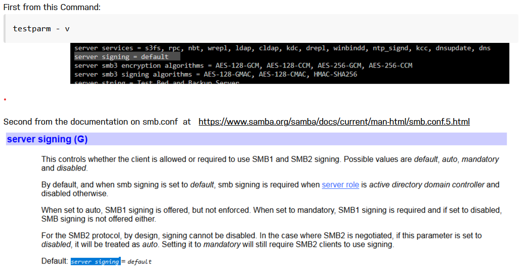

 It may not be what you think is happening.  This is from a series of private messages from myself to another Unraid user discussing this problem:
This message was written on May 31st of this year so the version of Unraid was fairly recent as of that date.  You can see that the setting is 'default' and the description form samba.org indicates that signing is only supported in the when the server is in the Active Directory mode which most Unraid users would not be using.  With the 'auto' setting in Samba Extras and Unraid version 6.12.14, testparm gives this as the setting:
I understand that SMB signing requires substantial CPU overhead and that is why it was not forced previously.  However, with the increase in CPU processing power, MS  (apparently) was decided that forcing support would not cause a substantial performance hit.
As mentioned in that text, for SMB2, server signing cannot be disabled, if the client asks for it, i.e., Windows 11 24H2, it will be used.
I've also tested this myself, running Unraid 6.12.0, a new Windows 11 24H2 install, and it connected fine after adding the user to the credential manager, no need to add/change any SMB settings.

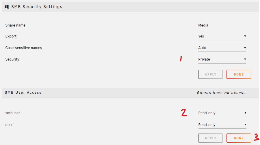

SHARES   >>>   {share_name}     It takes about one minute per share to make things private:
Don't see how Unraid could make it less simple!  (Unless you have 50 shares then you made things complicated...    😊)
Thanks for pointing out that SMB signing is implemented in Samba for SMB2 and higher when using the 'default' signing option.
There are still a few-many(???) folks still using SMBv1 on their Unraid systems.  (That is a major problem with trying to provide help for SMB issues.  So many users have hacked Windows in an attempt to avoid using any security on their Unraid server that you never know what type of setup you are dealing on the Windows client end. Plus, there are subtle  differences in SMB between the various versions of Windows----  Home, Pro, Enterprise, Education, etc.  And this doesn't include what MS does when they silently do their monthly updates on, or soon after, the second Tuesday.  Most folks just let those updates 'happen' and then can't figure why things stop working.)
