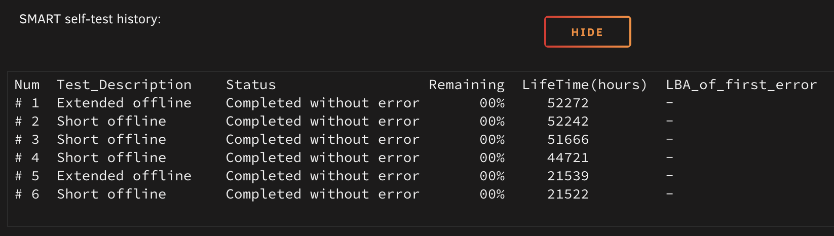

I've ran a SMART extended self-test which completed fine. The "current pending sector" count didn't reset and is still at 72, but the "raw read error rate" is back at 0. Would it be recommended to still replace this disk?
shadow-diagnostics-20250103-1423.zip
You could try rebuilding parity to see if those pending sectors would become reallocated.
Or you could replace it then see if preclear would make it do the reallocation.
If pending is increasing I wouldn't trust it in my array.

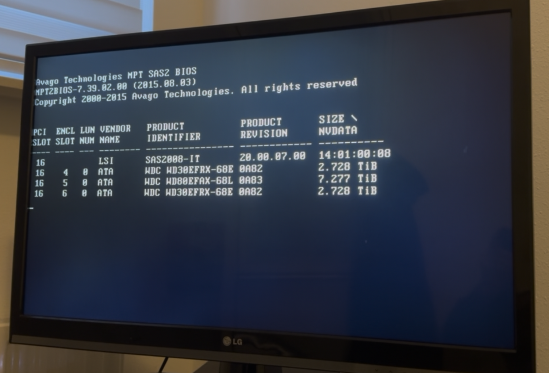

Interestingly at first the WD Red Pro didn't show up in Unraid as unassigned drive when I connected it to the port where the old drive was previously. When I connected it to a different port it did show up. The first port is on a H310 Dell Perc HBA (IT mode) where as the 2nd port I tried is a SATA port on the motherboard. Is there a chance that the H310 doesn't support (newer) WD Red Pro drives?
It should.
I've just tried again, still no luck. Hooked up a monitor to the server during the boot process and the HDD isn't listed in the list of devices when the SAS controller initializes.
The other WD Red drives (2x WD30EFRX, 1x WD80EFAX) initialize just fine.

Is the power source the same, i.e., are you just changing the SATA cable?
Correct. I've left the SATA power plugged in and the harddrive in the same "tray". Only switched the cables.
I did notice that the firmware of my H310 is from 2015, so I wonder if it's an incompatibility with the newer "advanced" firmware on the WD Red Pro drives.
That's the latest firmware for those HBAs, but don't remember seeing any other reports of not working with some drives.
