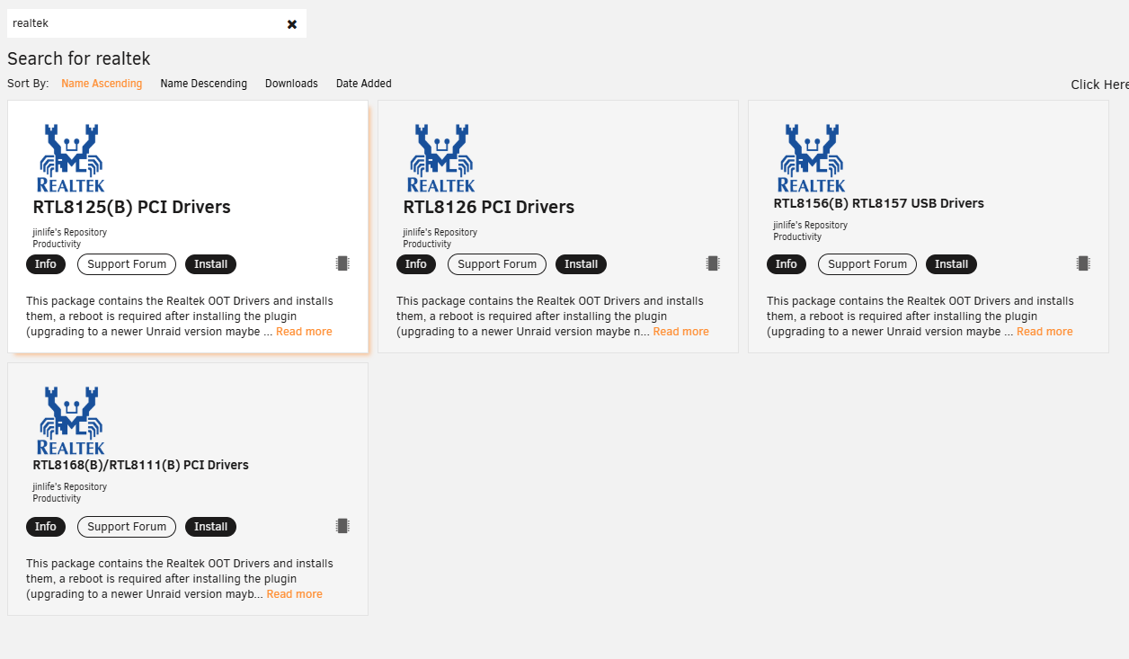

known realtek driver issues and defautl unraid behavior. Your not usiung 2.5 your using 1..
you may even need to install a driver:

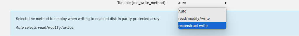

OK then general optimizations may be needed.
Enable "Tunable (md_write_method)" for Turbo Writes
Turbo Write, or reconstruct write, significantly improves write speeds by reading from all drives in the array to calculate parity, avoiding parity recalculations.
Steps:
Go to Settings > Disk Settings.
Find the "Tunable (md_write_method)" setting.
Set it to "reconstruct write" for maximum write performance.
Note: This increases drive activity and keeps all drives spinning, which may increase power consumption.

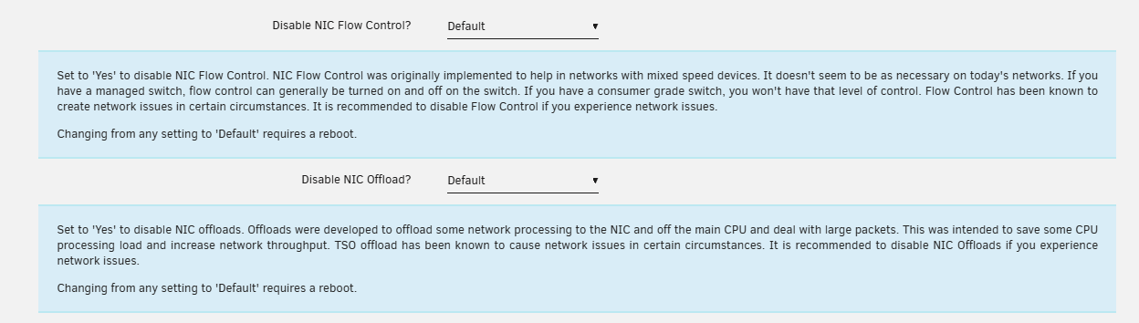

I see you have the plugin tips and tweaks.
Turn Off Flow Control
Flow control can introduce latency and bottlenecks in high-speed networks.
Steps:
Go to your NIC settings via the Unraid web GUI or your switch management interface.
Disable "Flow Control" for the NIC.

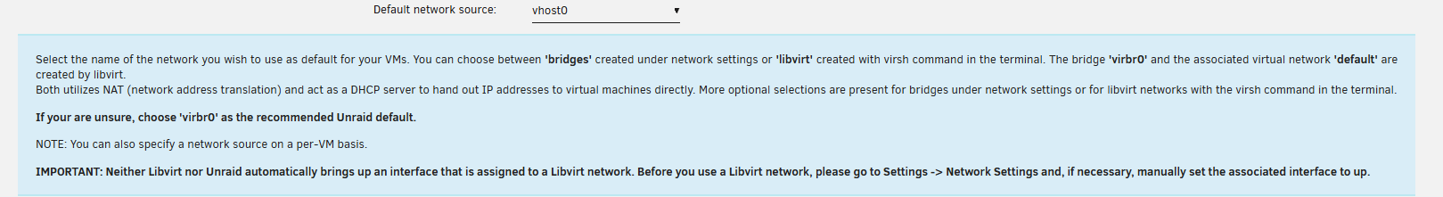

next lets review some vm and docker setting in unraid:
Web Ui > Setting > VM Manager
Defualt Network Source should be set to vhost0
*This is more for VM having access to you Lans Subnet for VM comunication.

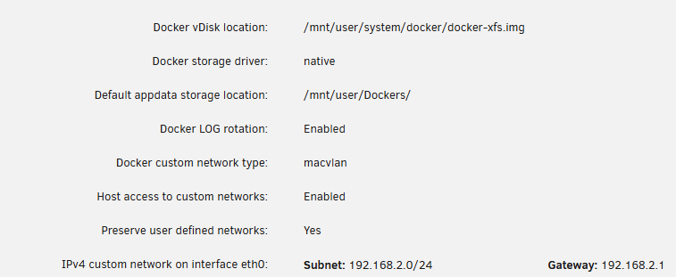

Next lets edit and review some docker configurations.
Web UI > Sewttings > Docker
Its more to set host custom netowoks and preserver user defined networks.
For Future compatibility. It is recommended to use the docker xfs image option. You may need to delete the Vdisk and recreate the Docker Vdisk
*Warning this is will empty/clear your current docker tab. (This done't remove or delete docker app configuration data)
-- to re-add existing docker after docker image created, go to docker tab add container in the drop down list select the name and click apply to bring your dockers back.
You don't have to change to macvlan. nor changed you Default appdata storage location its better to kepp /mnt/user/appdata for docker templates.
With these set you should now see eth0 as the only interface br0 and bond0 will be no more. if you had any docker set to a custom ip they may need netowrk recofigured to use use the correct network:
with docker defualt using vhost0 and vm set to vhost0 depending on ISP dhcp snopping and rouge dhcp server setting you may need a user script to treat teh vhost tab like a service and give it a different IP at first array start. see a work around script here:
Steps:
never!!!
This is the worst you can do to your machines. Read the Text carefully! "Meant for mixed-speed networks". And guess what he has here? 2,5 to 1G
If this is not mixed what else should it be?
Also, 2,5G alone is "mixed" already because it is just "10G with pauses". It cannot work without flow control.
Turn it back on.
And make sure every device on the LAN does honor it, else there will be strange lockups, blocades, pauses...
Unmanaged switches do not honor it, they just pass on the request in the hope, the next device will be more clever. So this is not reliable. If you daisy-chain even more unmanaged devices it will become even more risky.
30 minutes ago, MAM59 said:
never!!!
Turn it back on.
I've put it back to default and rebooted my system

there have been reports on this forum with 2.5 and reltek where turning off flow control increased performance.

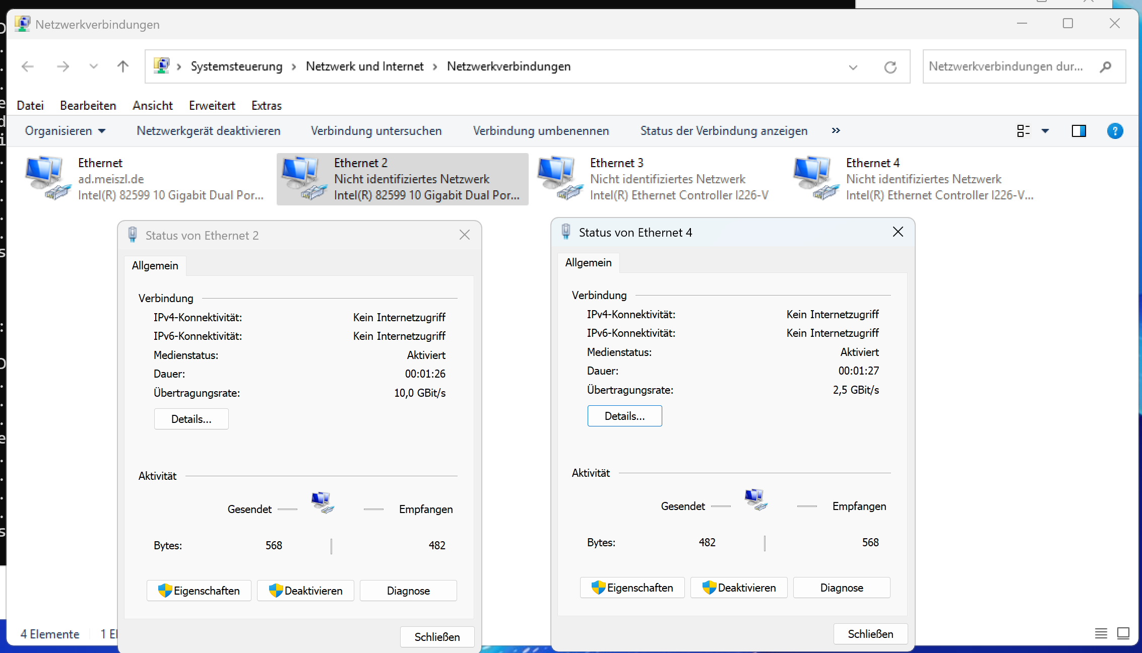

Look at this sample setup:
Cards 2 & 4 are just directly connected to each other. But look at the stats...
#2 thinks she has a 10G connection (thats correct, because 2.5G does not exist) and #4 knows that its 2.5 only (because she can do no more)
This would produce a big mess. And here is where flow control comes in. If #2 as a sender uses the "wrong" slot, #4 halts her. This happens until the right window is guessed and repeats over and over again.
In the other direction (2,5->10) it never happens because the 10G card accepts data on every slot.
