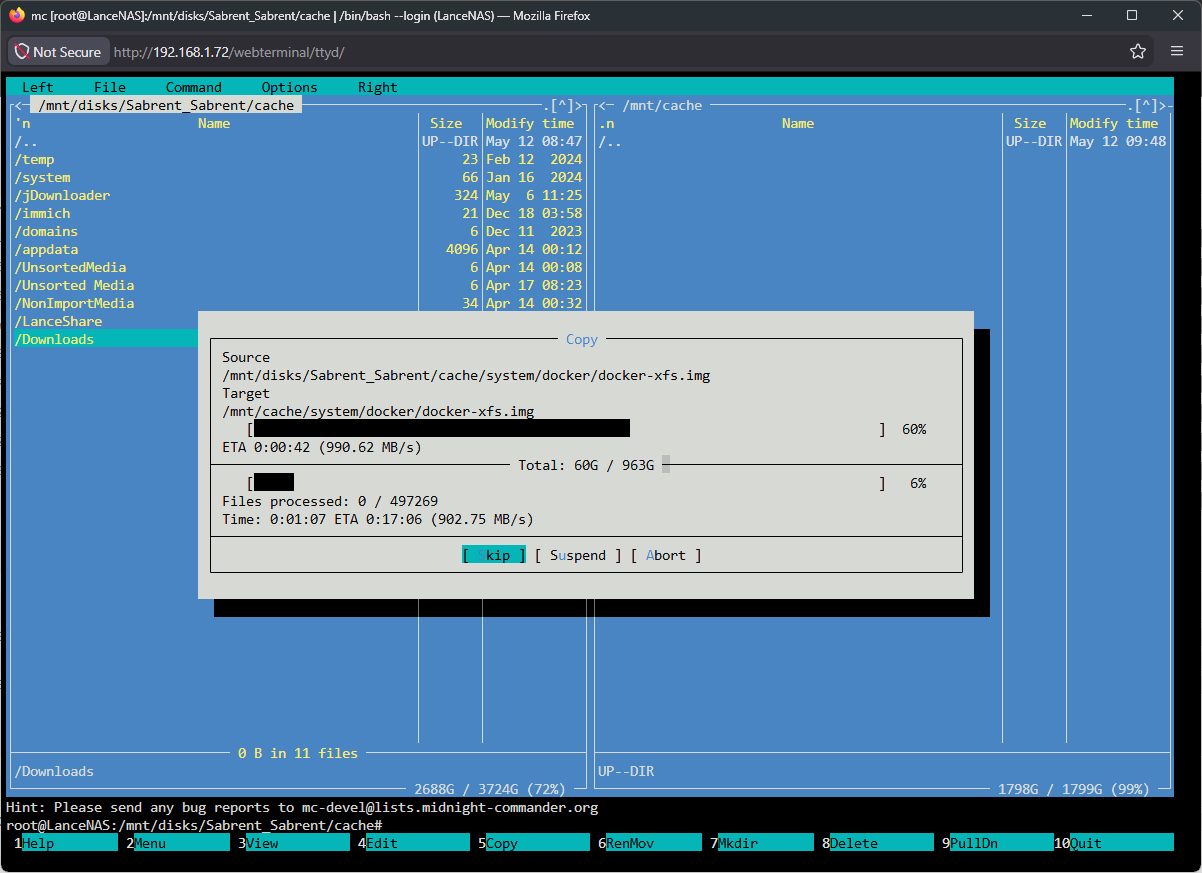

  2. Yup lol, it is copying the files without restart when the samsung drive is removed from the pool.

  8. I waited a bit and was able to run the command. It's now formatted and when I try to copy the backup into the new /mnt/cache, unraid just restarts. I've attached a new diagnosticslancenas-diagnostics-20260512-0021.zip

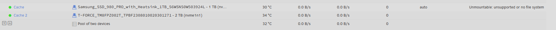

  9. I'm getting the above error

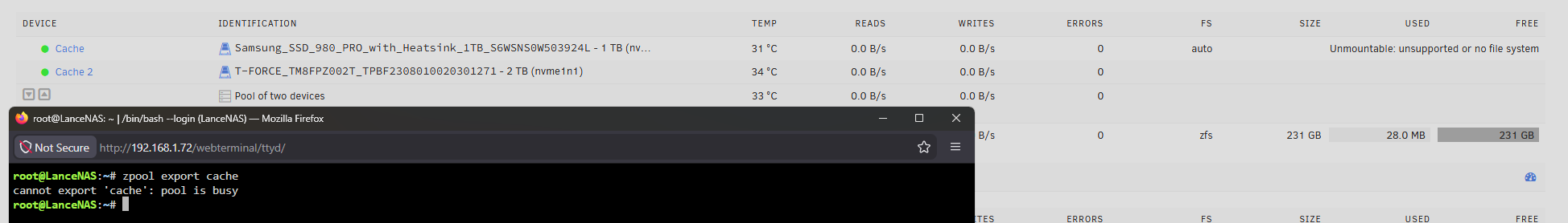

  10. Data has been successfully backed up to another drive. Is the format process just a simple stopping the array and pressing format on the GUI and then copying the /mnt/cache backup?
  11. This should still be ok right?

  13. How do I backup a pool? My plan (if it was only one NVME) was to clone it to my PC and then then restore it onto the reformatted drive. Here's what I get after running the commands: I can't access the server anymore
