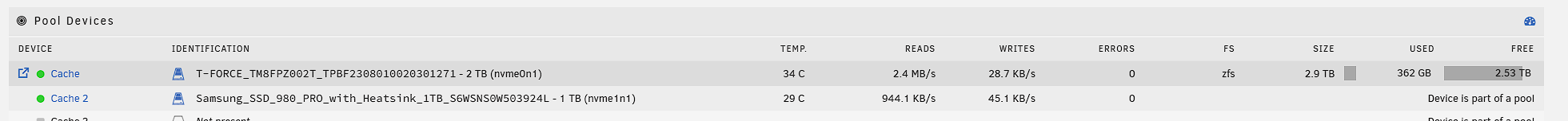

  1. To preface, I was trying to figure out why my system kept crashing when I was starting the array, the issue has been solved here: https://forums.unraid.net/topic/198699-array-stuck-mounting-cache-724/#comment-1622395 But now, all of a sudden I was unable to start the array (because docker auto started) yet again. It starts when I disable docker, so I thought my docker img file was corrupt. I have re-created it and installed gluetun container just fine. But when I re-install the aforementioned container, the server just crashes during the install portion. I have attached my diagnostics (syslog enabled) TIA lancenas-diagnostics-20260519-1501.zip
  2. Yup lol, it is copying the files without restart when the samsung drive is removed from the pool.
  3. I have removed the samsung drive from the cache pool and will try with the T-FORCE NVMe as the only device in the cache pool

  7. I fear it may be the Samsung NVMe I have in the cache but am not sure. Smaller directories copy fine but when I try to copy everything in, unraid crashes. Syslog turned on and diagnostics attached. lancenas-diagnostics-20260512-0206.zip

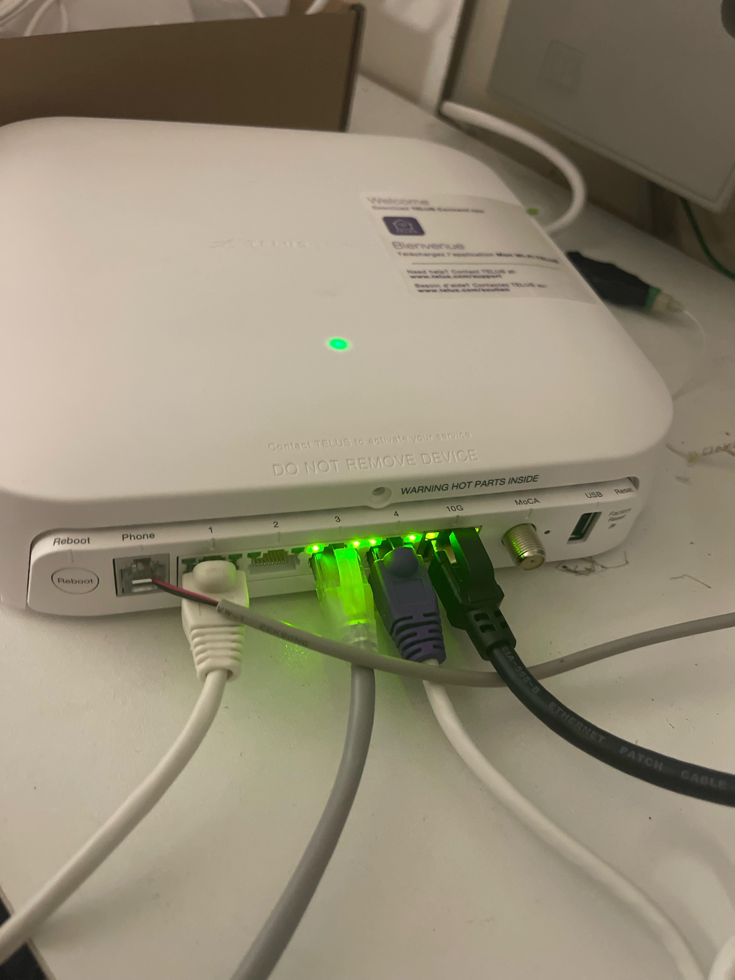

  19. Thank you again for the detailed guidance. I've done everything up to the userscripts you created as I need to read up more about when they should be run (cron) and the pros and cons of them. My docker was already using the xfs img and macvlan enabled. To add, every test I have been running has been over LAN. The equals sign just indicates that my access points, host windows pc and unraid are all connected to 2.5G unmanaged switches. The access points are all Wifi 6 asus routers that have been flashed with OpenWRT Your assumption here I asume wifi > openwrt > unmanned swtich > unraid. How I have it: ISP Modem > unmanned switch - > openwrt/unraid/hostpc (all on same level) Also, the port that all the switches/devices are connected to on my ISP modem is 10G: Just ran another test and seems like nothing has changed:
  20. I am still sort of new to docker so that bridging is enabled because all my docker containers not part of the *arr network are on there, is there a different recommended way to set it up? And for the bonding, I can disable it. I don't think I am using it for anything. Also, how do I disable bond0/bonding? My network diagram: ISP Router (Technicolor NH20T) -> 2.5G unmanaged switch -> Unraid = 3 Open WRT Dumb Access Points running in wired backhaul. I don't see the need to have one of the access points run in router mode for me as the ISP router already has 10G ports. And as for the docker images, I have tried moving files over with docker disabled and got the same results.

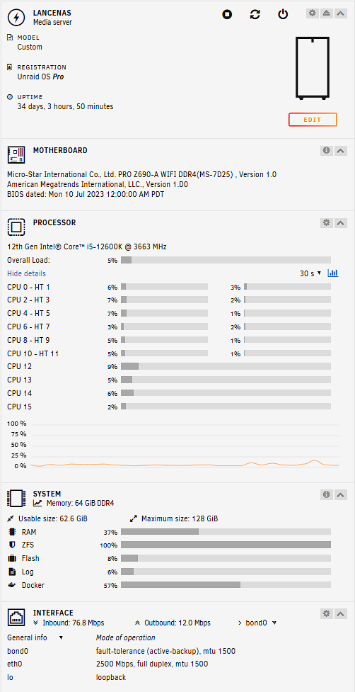

  21. Also, after changing the settings you recommended... iperf3 seems to be slower?

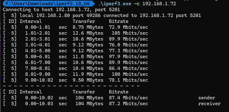

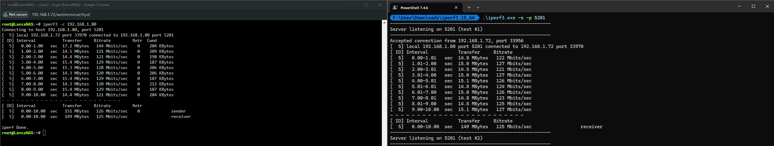

  22. First of all, thank you for the in depth instructions. Unfortunately, I tried all the steps except Jumbo frames as I think some devices don't support it and nothing has changed:
