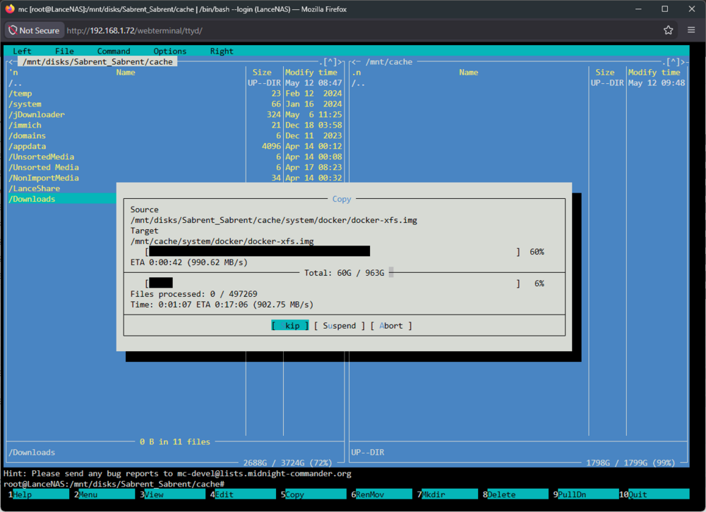

If it only imports read-only, after doing the import, start the array and copy from /mnt/cache to the array (or another pool), you can use, for example, Midnight Commander (mc on the console)

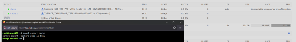

This should still be ok right?
Yes, it's normal for the WebGUI to show unmountable when it's imported manually.

If all the data is copied export the pool first
zpool export cache
Then stop the array, click on the first pool device, and "erase pool", then start the array and format it.

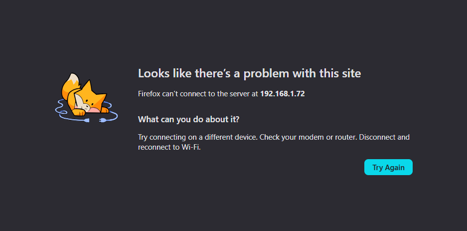

I'm getting the above error
1 hour ago, JorgeB said:
Server restating on its own is usually a hardware issue (or bad power); enable the syslog server and try again.
I fear it may be the Samsung NVMe I have in the cache but am not sure. Smaller directories copy fine but when I try to copy everything in, unraid crashes. Syslog turned on and diagnostics attached.
lancenas-diagnostics-20260512-0206.zip
Nothing relevant is logged in syslog-previous, if you can, try using a different device, but typically, even if it's bad, that should not make the server restart
