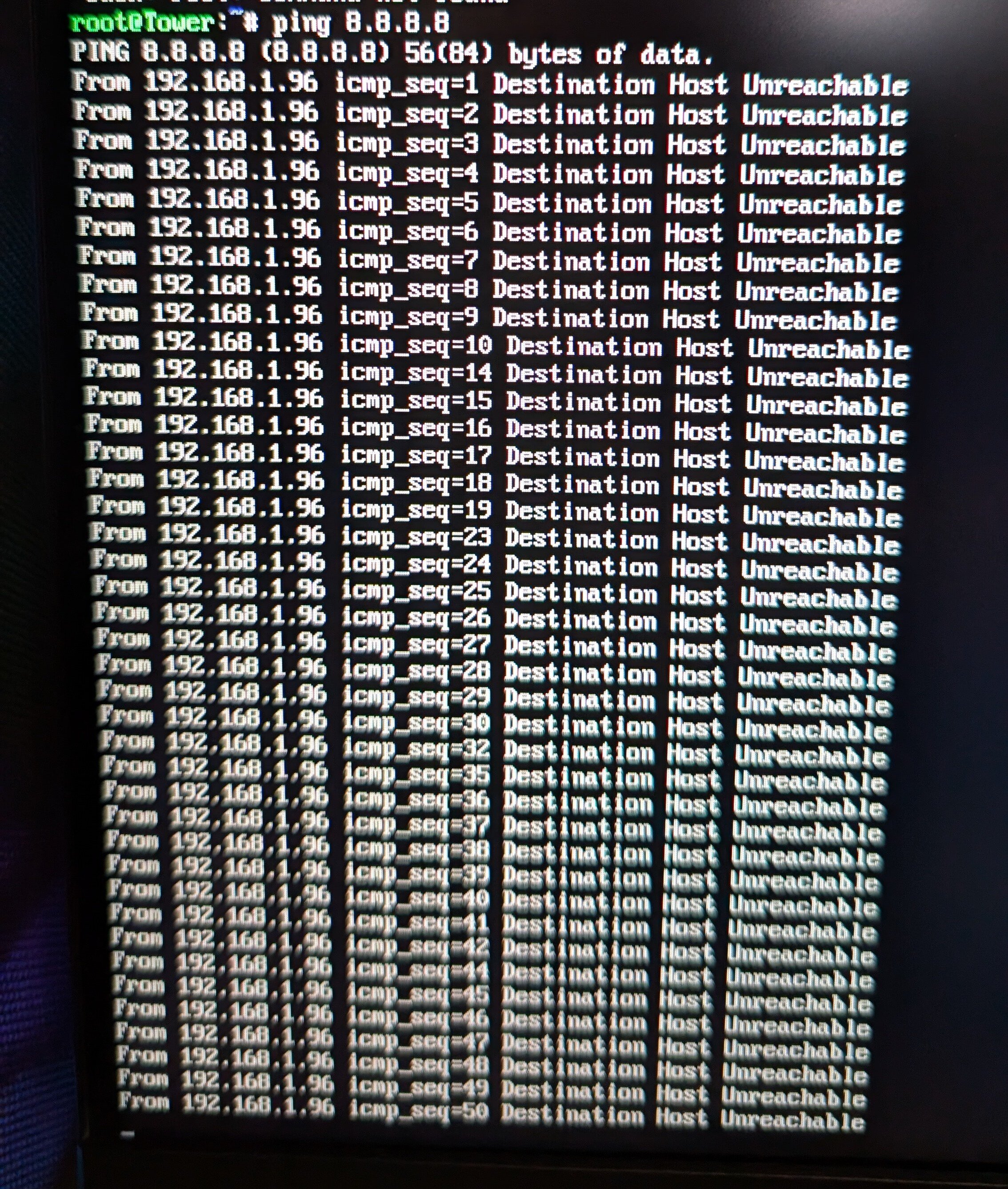

I've read somewhere it could be a problem with a realtek ethernet driver?

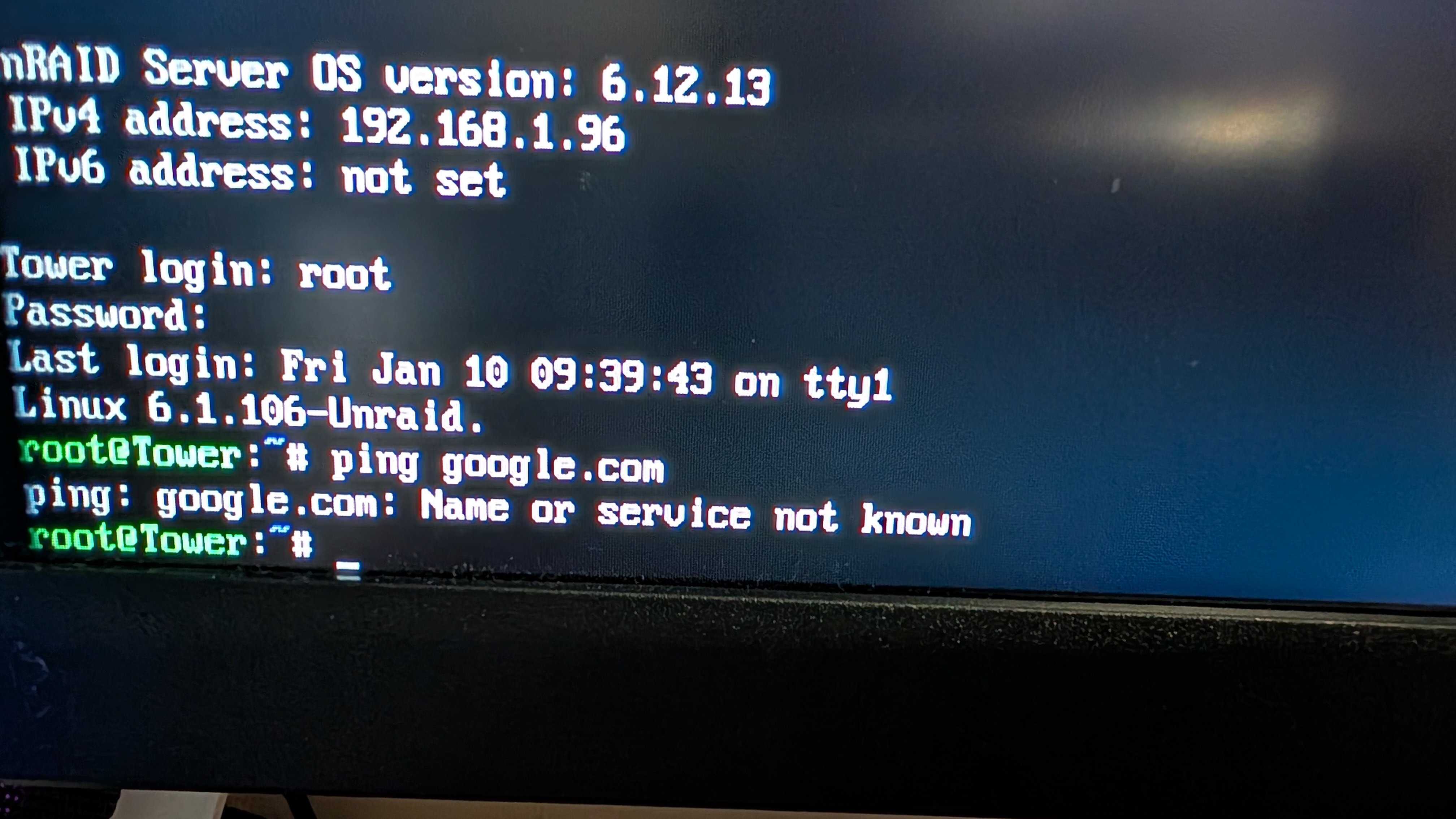

You are using the stock Realtek drive, that one should be fine, see if you ping Google for example from the CLI after the issue happens, to confirm the problem is with the server.
Try 'ping 8.8.8.8' instead.

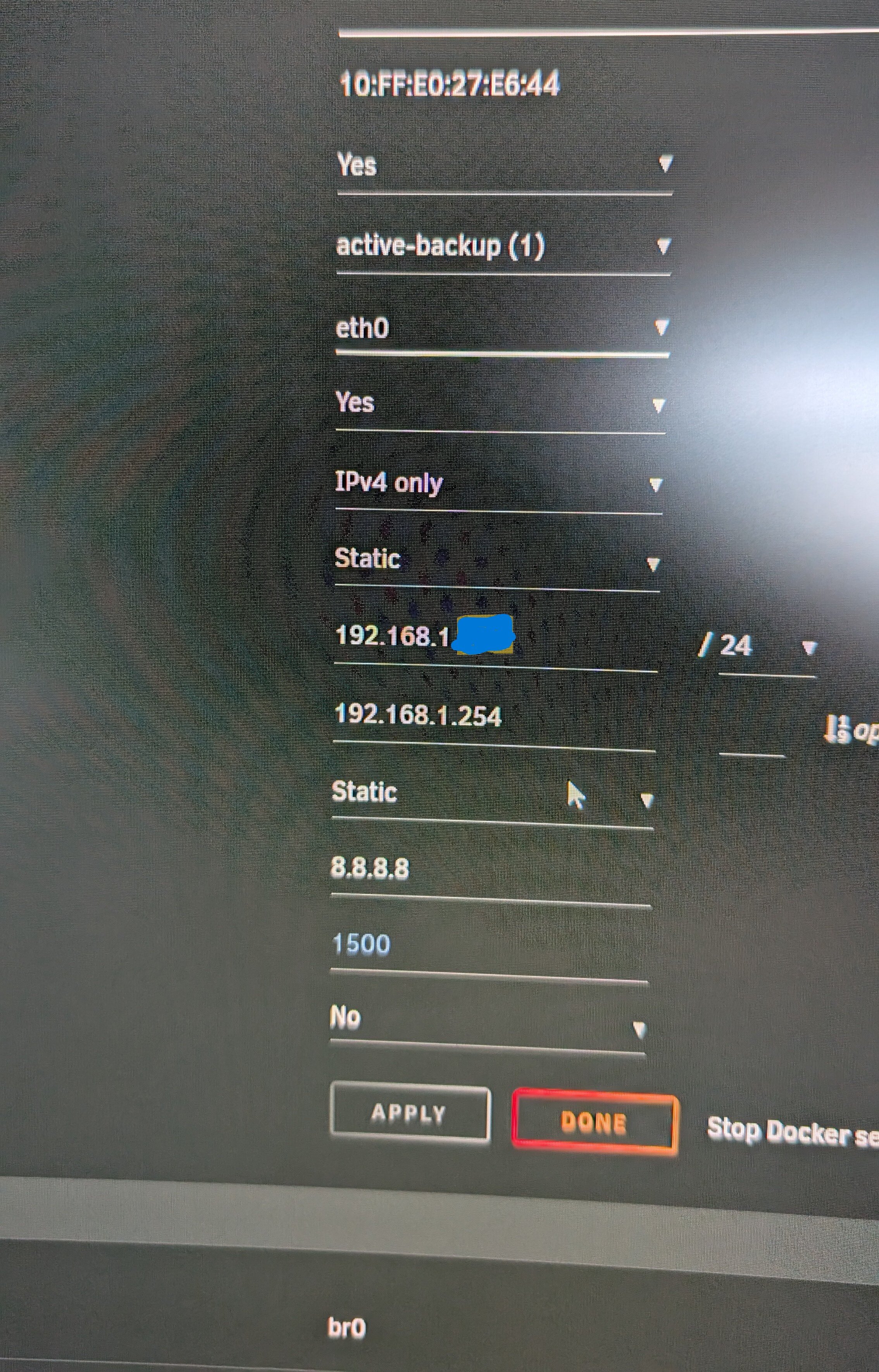

I changed IPv4 DNS server: to 8.8.8.8 and now its working, is that a safe setting to use?
It's fine.
