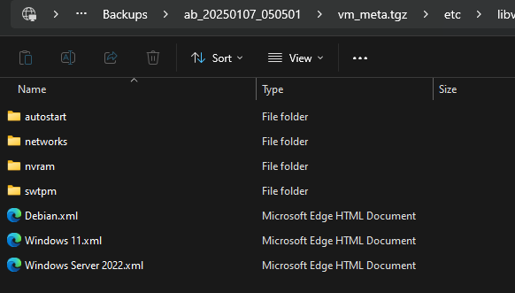

I'm hoping this is my last issue.  My VMs won't run.  My windows 11 VM appears to run but i can't actually get RDP or the console to open.. Debian flat out wont' start, something was corrupted. I have backups I think:
How do I go about restoring these?  And just in case here's my diagnostics as well.

I can't figure out how to restore the VMs though like I was able to with the Dockers.

After all the fixes I've had to do to get everythign else working I'd rather just wipe out the VMs and start from scratch if there's no way to restore them from the backups created by the Appdata Backups plugin.
AFAIK Appdata Backup doesn't backup VMs.
