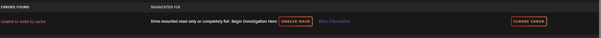

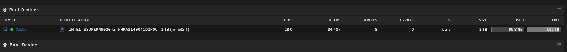

Hello, the dockers will not start. I ran Fix Common Problems and there is an error "Unable to write to cache Drive mounted read-only or completely full." It says that this means the drive is currently full or the mounted read-only. The drive has a lot of free space and I'm uncertain how to check if the drive is set to read-only. This happened while I was watching plex, so I'm uncertain how something could have been changed. I've included 2 screen captures and the diagnostics file. Any help is greatly appreciated, I am a beginner user of Unraid.

The pool has filesystem issues, and since btrfs was detecting data corruption, start by running memtest.

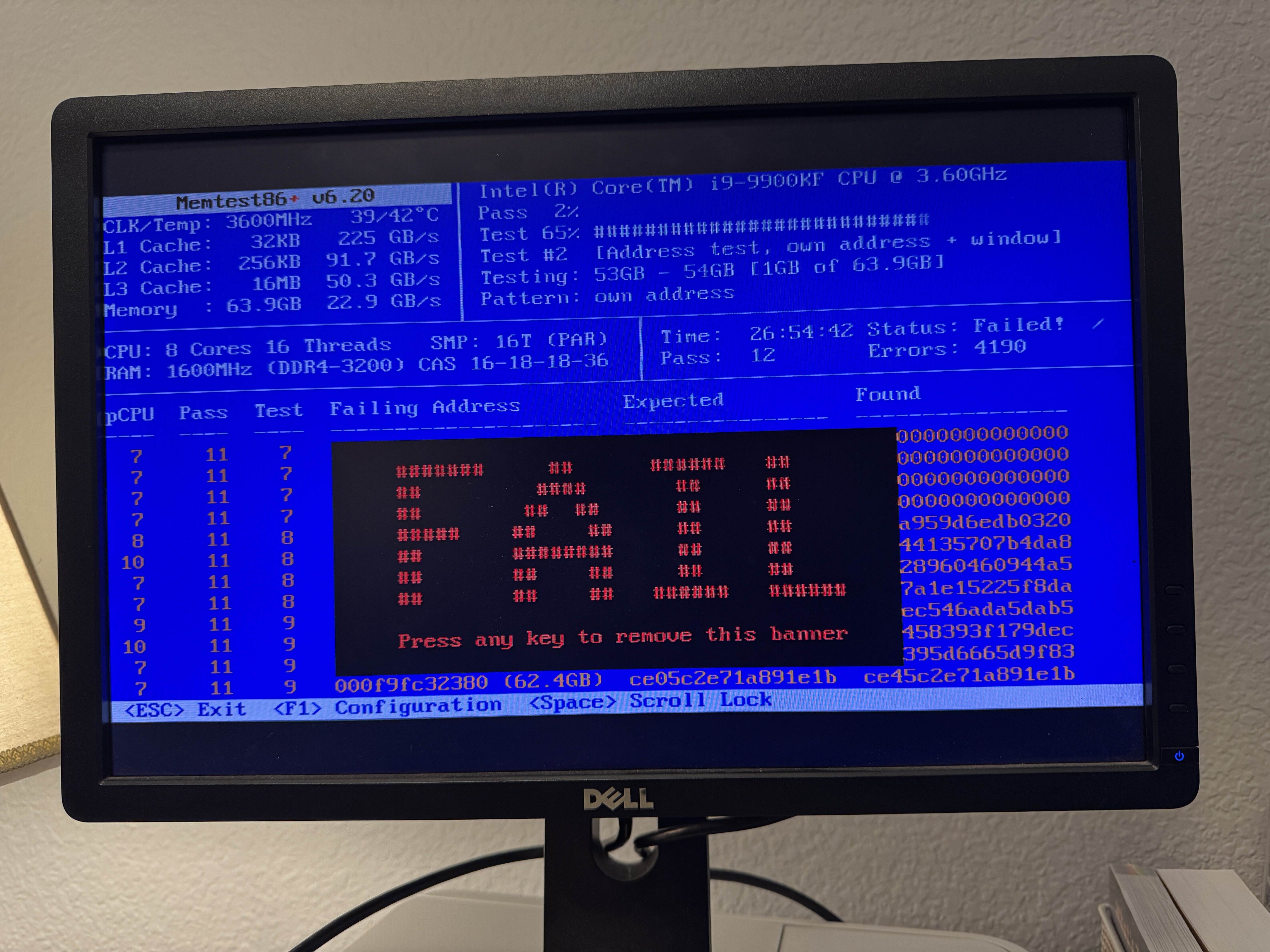

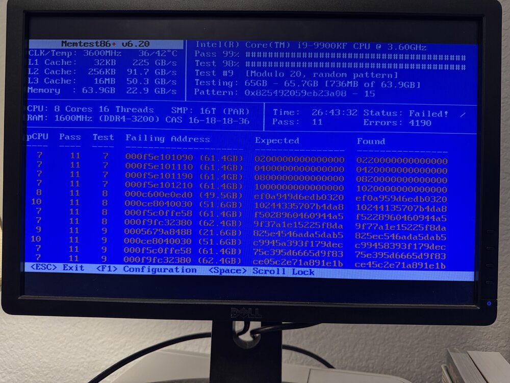

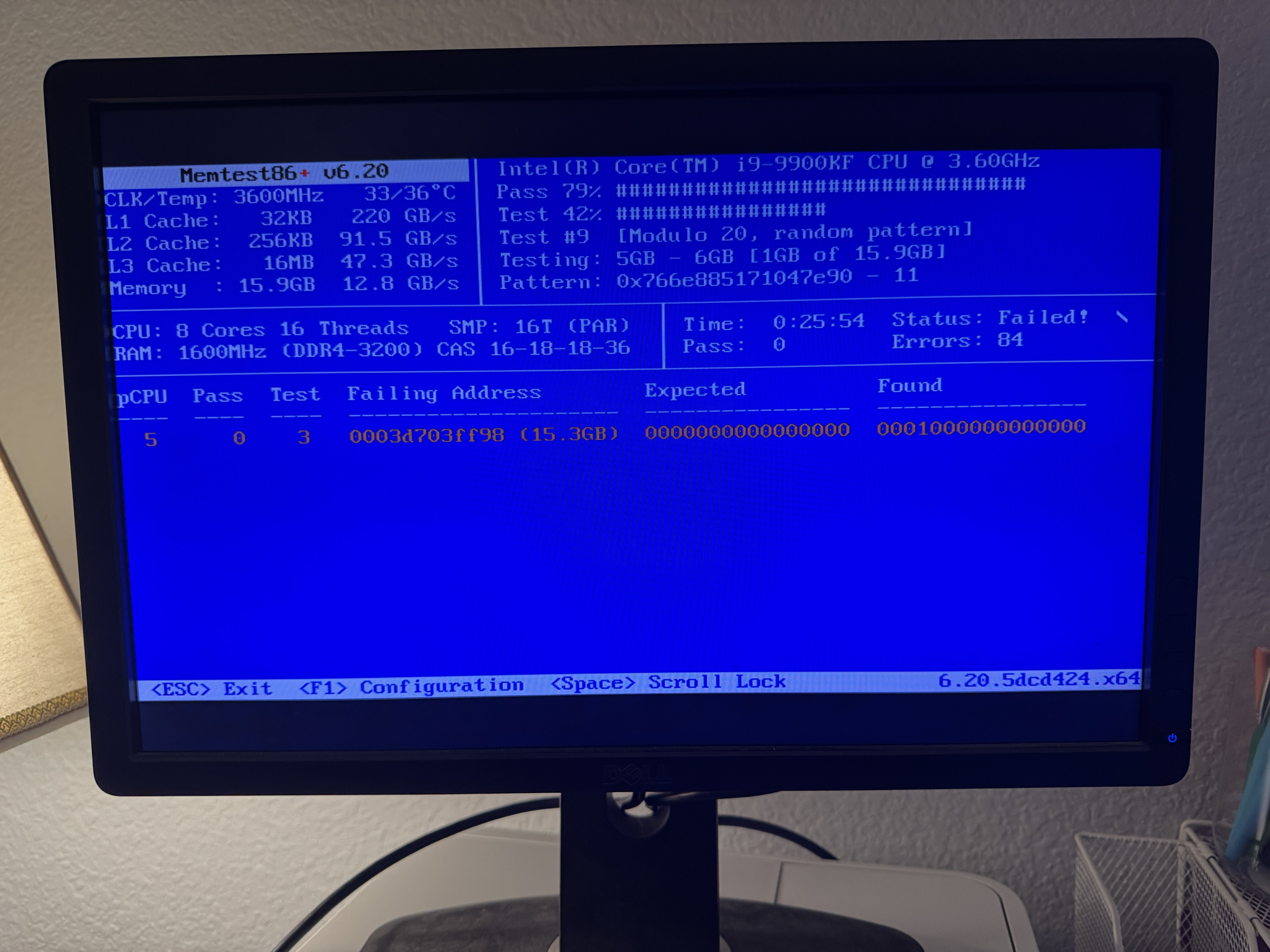

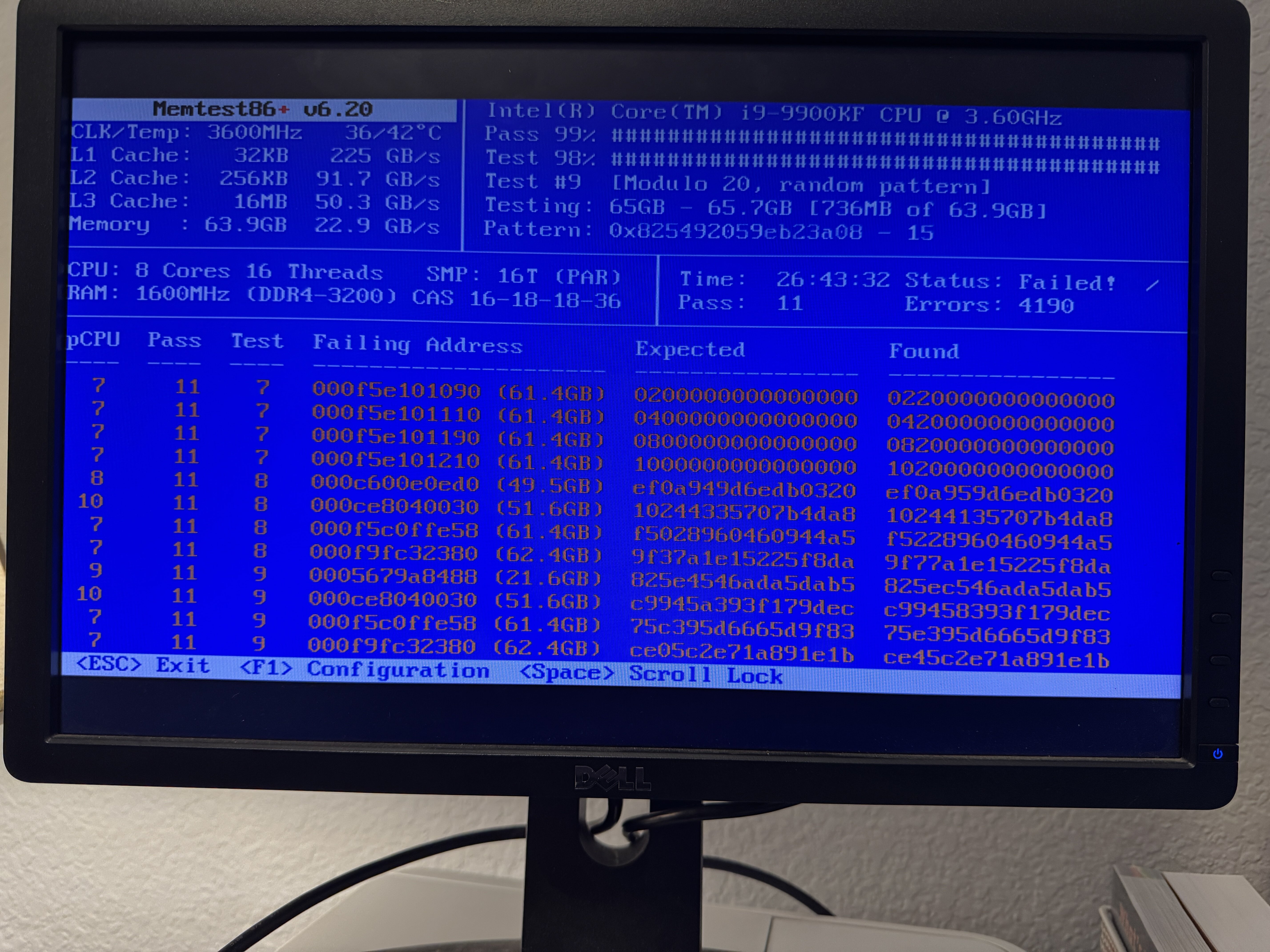

 I am currently running the memtest and it has been running for 27 hours.
Even 1 error is too many so you definitely have a RAM problem.
You shouldn't even attempt to run any computer unless RAM is working perfectly. Everything goes through RAM. The OS and other executable code, your data, everything. The CPU can't do anything with anything until it is loaded into RAM.

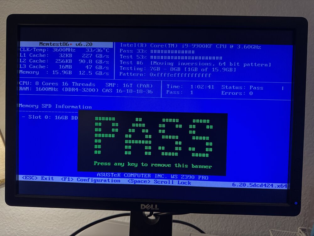

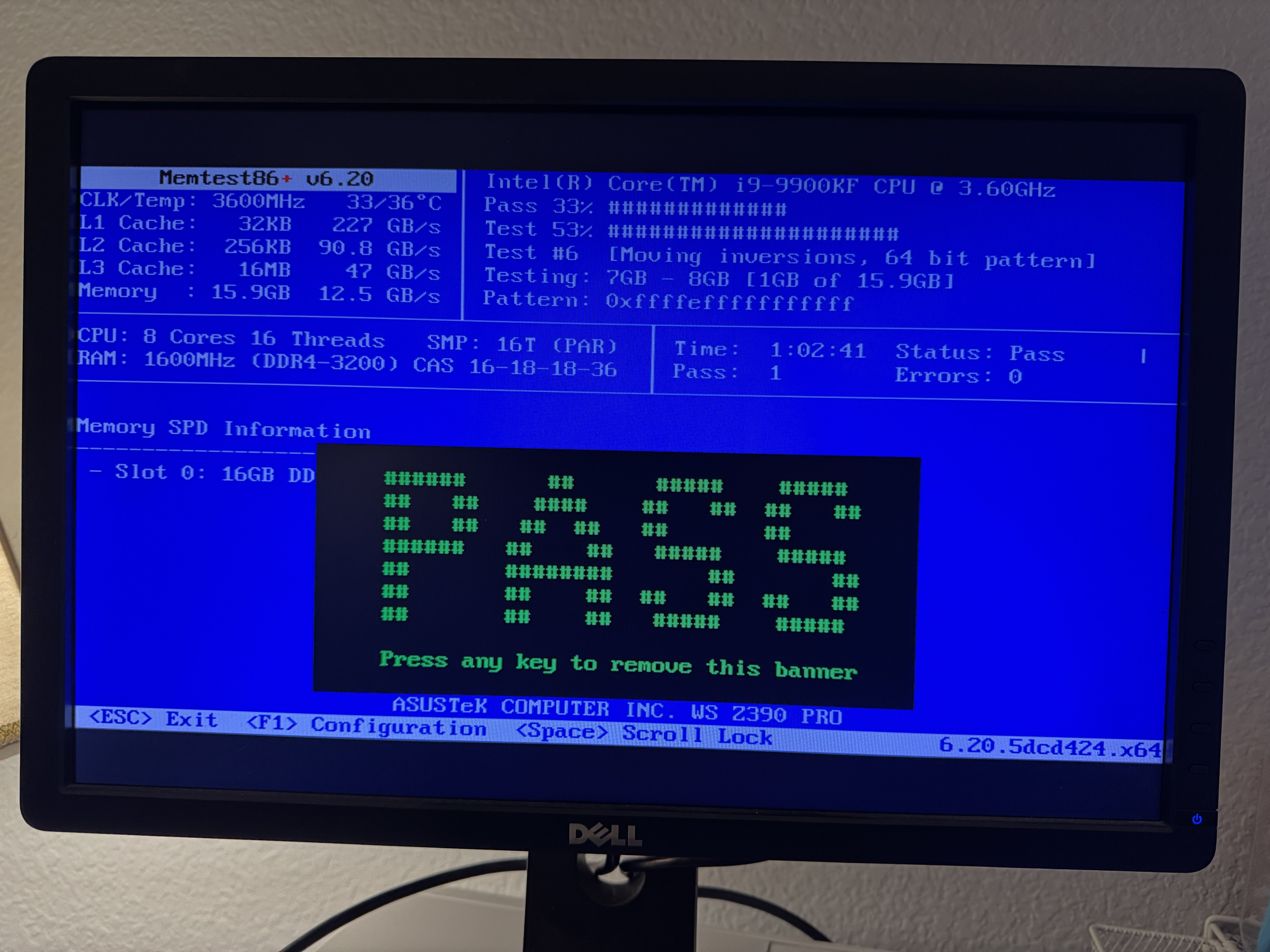

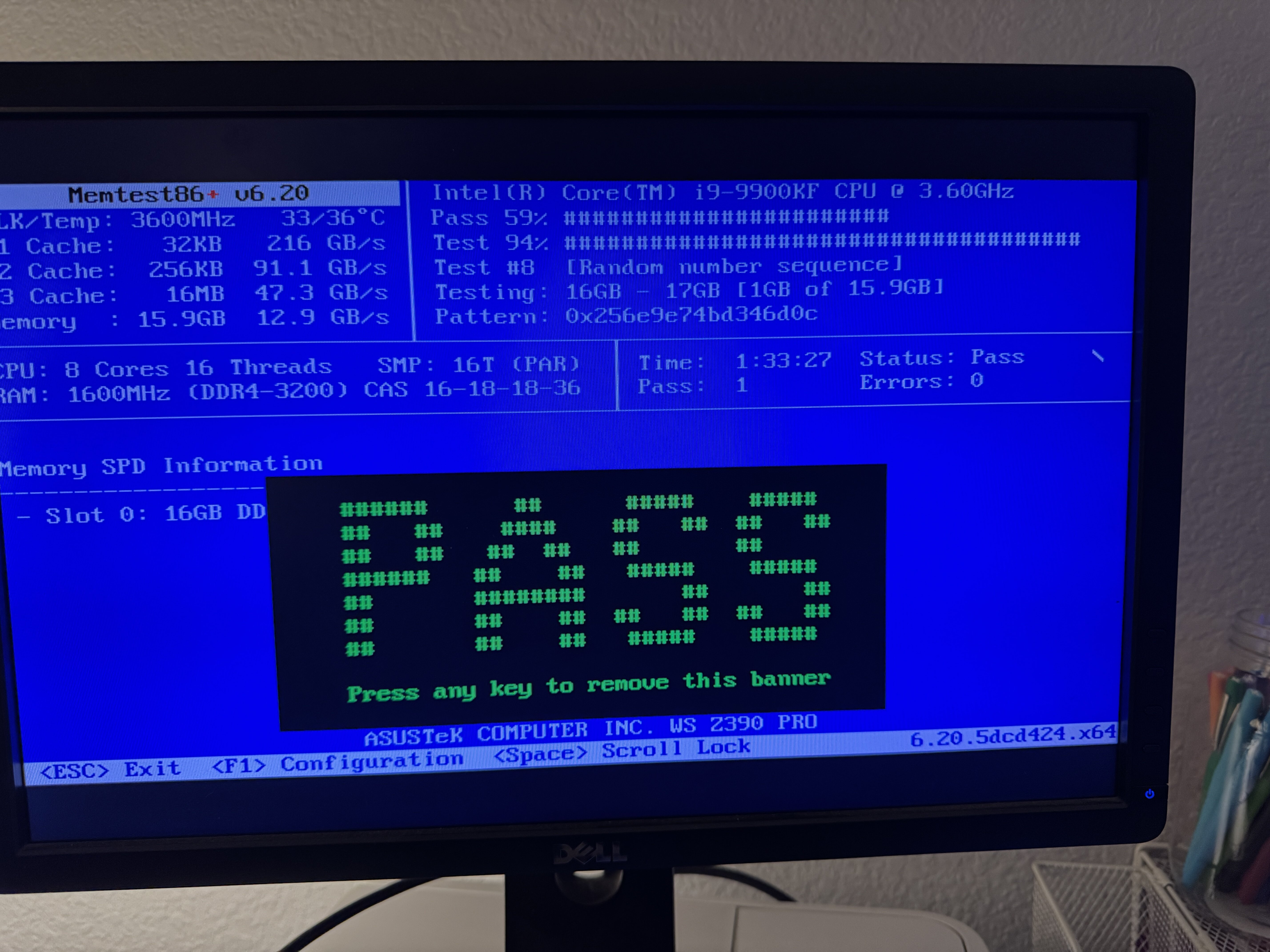

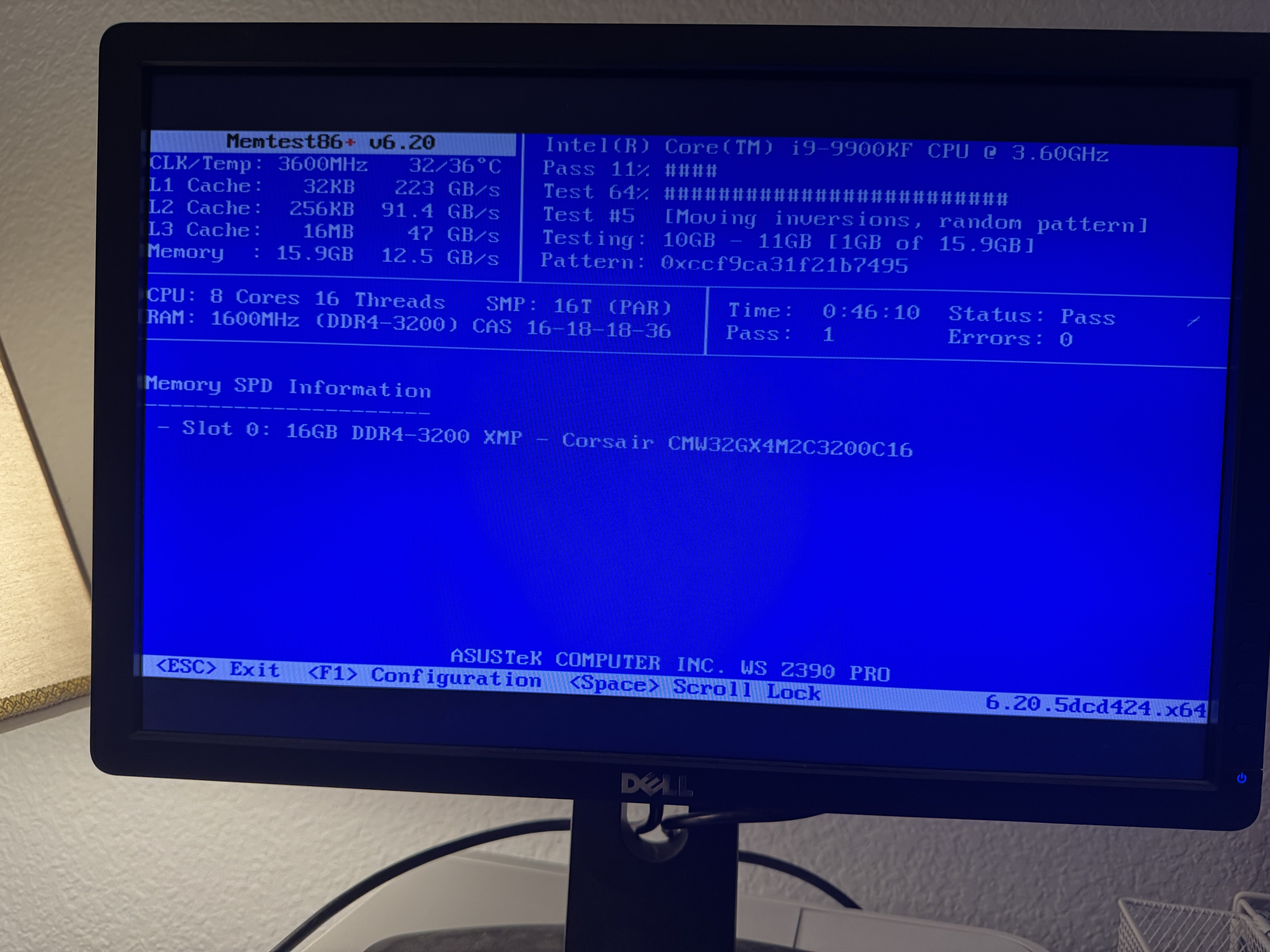

I tested each one separately and they all passed except for one. I started the server with 2 sticks installed and the dockers still do not start. I still get the same message in "Fix Common Problems"
Fixing RAM is the first step in being able to fix other problems. Fixing RAM won't fix the damage already done to your data from the bad RAM.
