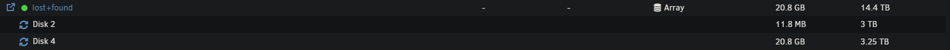

Go to User Shares, click Compute... on the lost+found share. Post a screenshot and new diagnostics.

Lost and found shows data on 2 and 4. 3 is still unmountable. I am begining to wonder if I need to drop it from the config and just 000 it as any critical data is backed up.
I already knew that. I wanted to know how much.

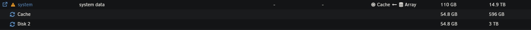

Do Compute... on the system share also. It seems to have some data on disk2 and not all on cache as it should.
