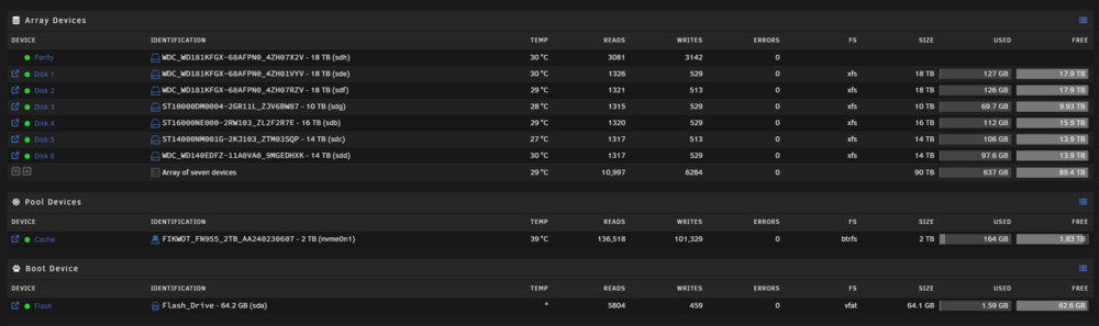

My Unraid was running perfectly. I updated to v7 earlier this week and had no issues. Today, I came home from work, and all the data on all my array devices was gone. I don't know what to do. There was 60-70Tb of data loss. The little bit of data that is there is probably from sonarr and radarr redownloading.
can someone advise what I should do?

It does look as though your drives were re-formatted, not that someone got in and just deleted the data. The reason I suspect a reformat is look at the number of reads and writes, if someone was manually deleting the data, those numbers would be in the millions/billions. It's also possible you rebooted/restarted the array and cleared the read/writes just before taking the screenshot.
