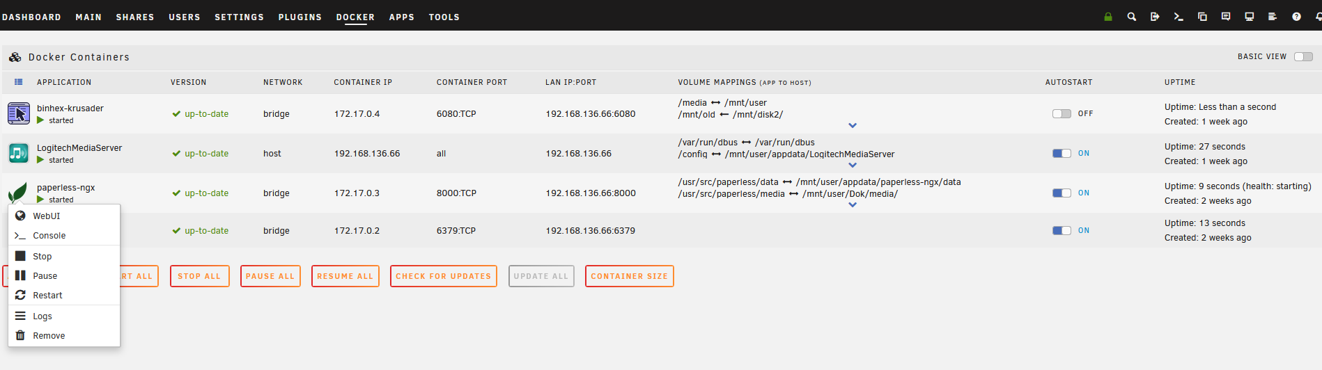

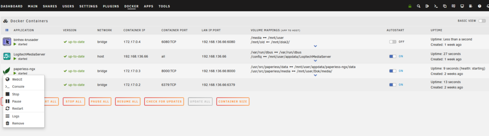

While trying to fix another problem, I realized that the option to "edit" a docker container is not present in my unraid installation (see screenshot).

Templates for your containers are stored on the flash drive. Did you lose them? They can't be edited without the templates that created them.

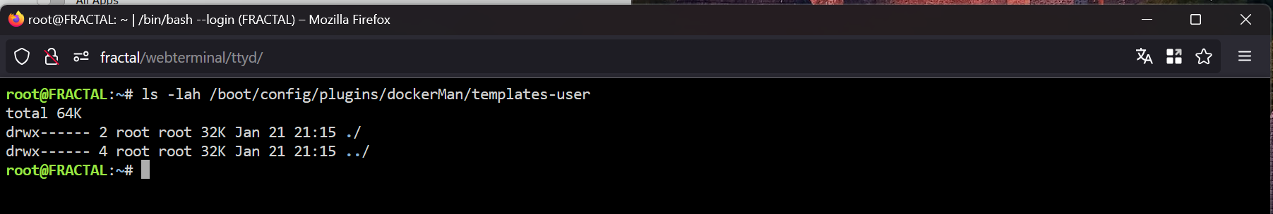

What do you get from command line with this?
ls -lah /boot/config/plugins/dockerMan/templates-user
An empty folder:
Looks like you lost them somehow. Did you change flash drives perhaps? Or do a clean reinstall to flash? Do you have a recent flash backup you could check to see if that folder has anything in it?

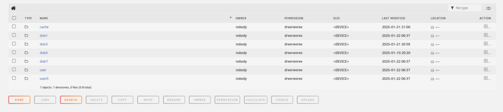

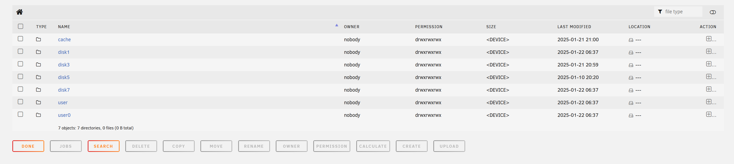

PS, while browsing the file system, I found these two folder called user and user0, I'm not quite sure what these do - is there supposed to be only one? The contents seem similar though partially with different timestamps.
user is the user shares, user0 is the user shares excluding all files that are on a pool and not on the array. Probably better if you don't mess with any of that without specific advice.
