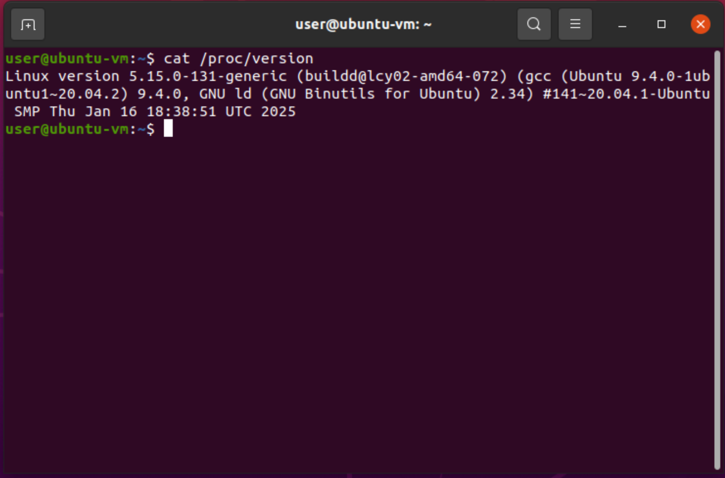

2 hours ago, ich777 said:
As already said, maybe it‘s the filesystem.
What Kernel was the Ubuntu machine using?
5.15.0
  • Replies 55
  • Views 3.6k
59 minutes ago, peace-keeping-villa8590 said:
5.15.0
This is by todays standards a really old kernel.
What filesystem are you using on ubuntu?

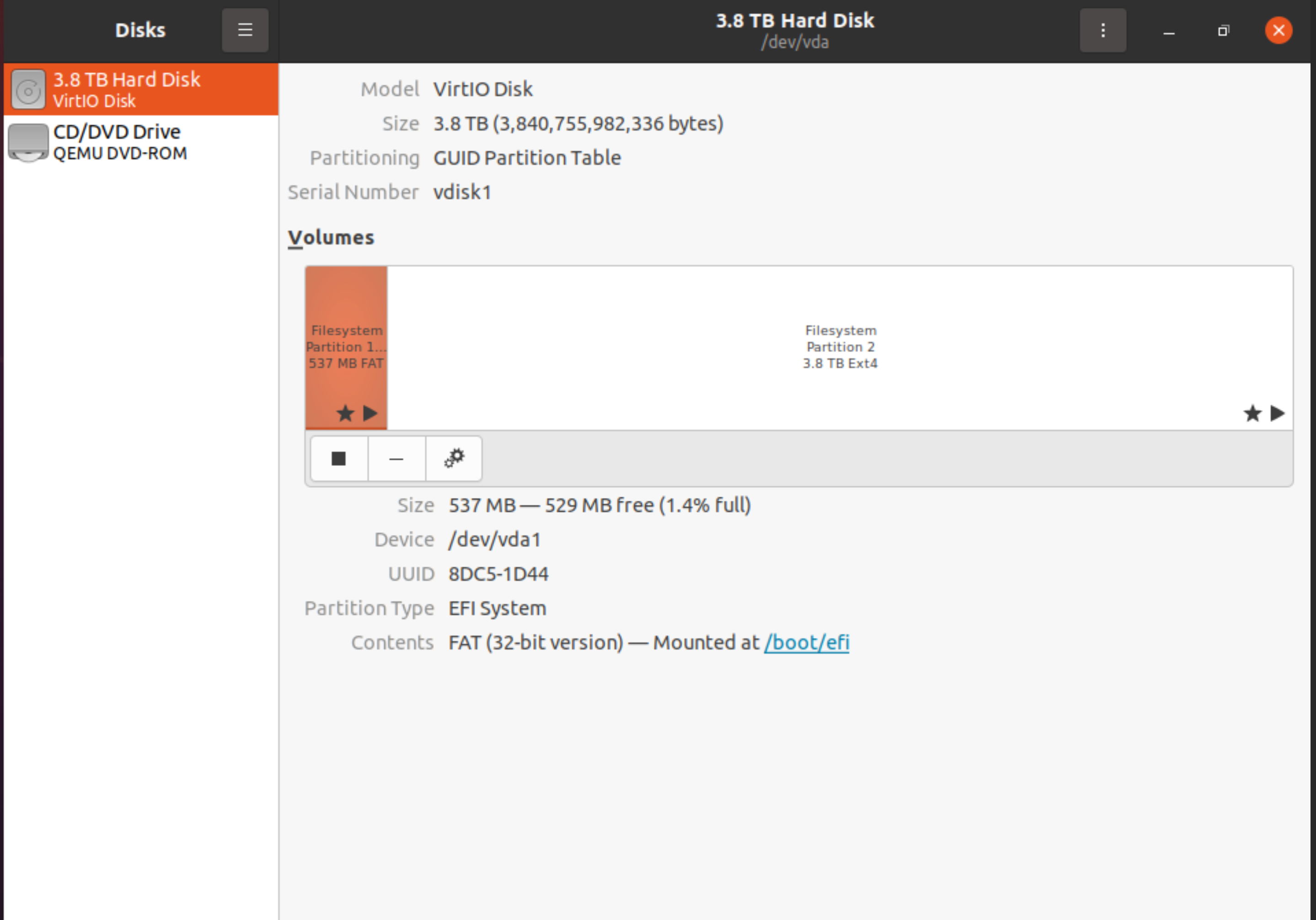

Ext4 I think but it also says "Contents FAT..."

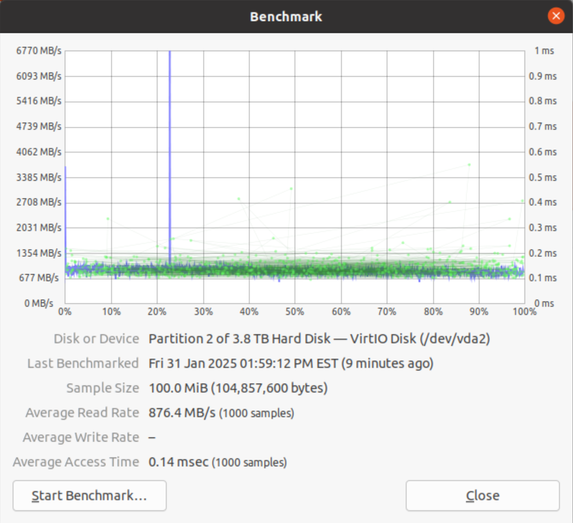

On 1/31/2025 at 7:51 PM, peace-keeping-villa8590 said:
Did you yet try the other things that I recommended?
I used dd to do write test in Unraid.

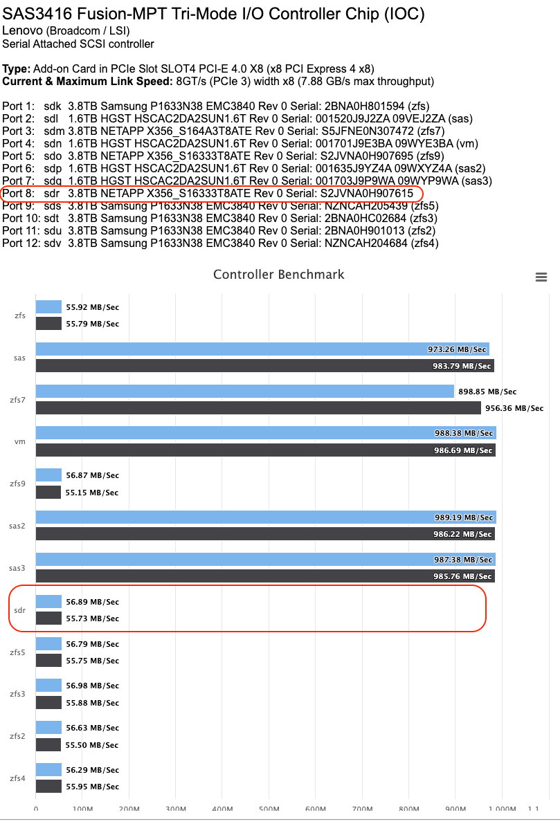

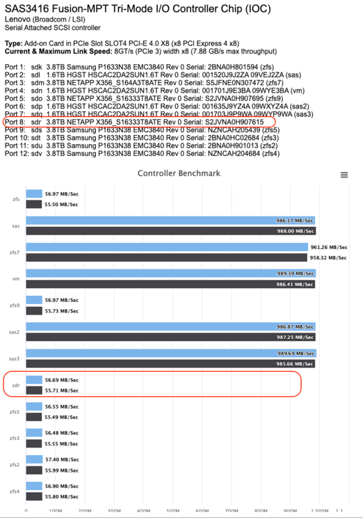

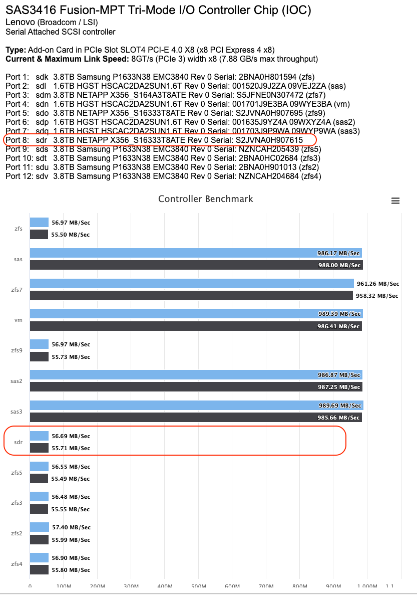

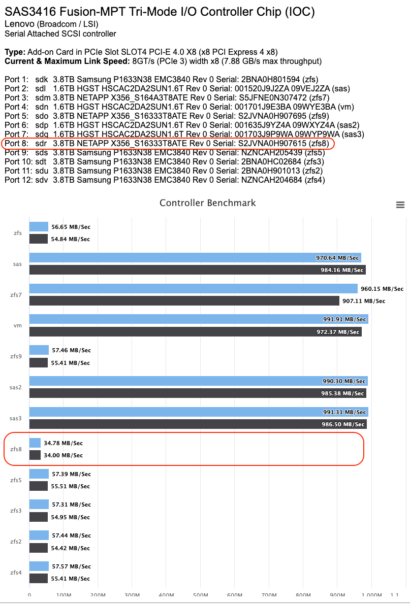

On 1/28/2025 at 12:41 AM, JorgeB said:
This is very strange since one of the devices is performing much faster than the other ones, I assume that if you swap cables/ports, the issue follows the devices?
I moved a drive to a different backplane and now the drive ^ is the only device connected to this HBA (9300-16i)
The drive is Dell EMC branded but will not accept the firmware.
During some research, some of which was saying SAS SSD cacheing is handled by the HBA. My theory is, the SSD's firmware isn't allowing the drives cacheing process to work since it's connected to a non-Dell HBA. Thought's?
It's a possibility, and it would make sense.
I received a Dell H330 and no change in performance. I did some research on the controller these drives use and from what I gathered, it uses a Samsung proprietary in house controller. I thought it was interesting because newer models use sourced controllers.
I would recommend trying with another Linux OS running a similar kernel, if it's the same, there won't be anything that LT can do.

I did this test a few times to fill the zfs cache afterwards this is the result. I made a one drive pool, test_pool, and did the fio tests against it.
That will basically just test the ARC, though the results are far from great, I would recommend creating a single volume pool with one of the slow devices, and then just read/write a large file to it, using SMB or another local device, then compare with Unraid by repeating the exact same thing.
