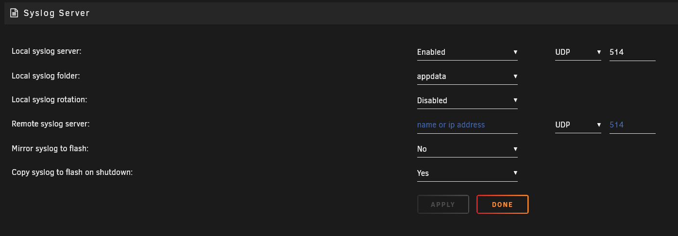

It's enabled. It doesn't look like it added anything to the diagnostics this time though. I've attached it here.
syslog-previous
You need to set the IP address, it can send it to another or it can send it to itself.
Didn't realize I had to set that up. I guess ill need to let it run until the problem happens again?
