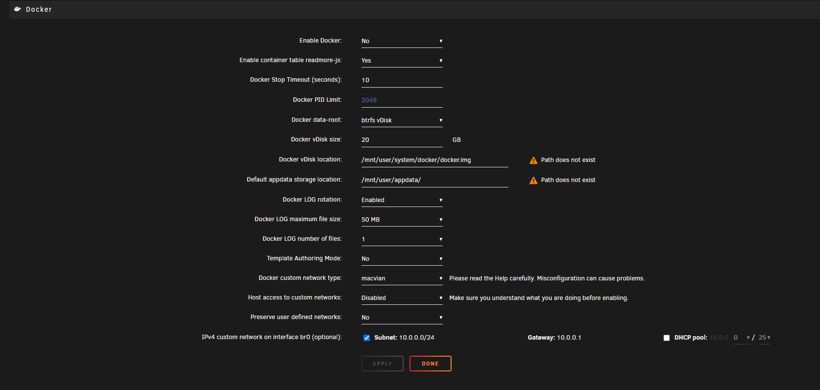

I would expect those to be auto-created when you enable docker - have you done this yet?
I recommend leaving those disabled until you get cache working again, so those don't get created on the array.

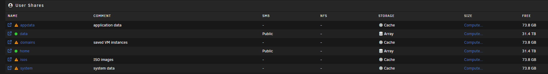

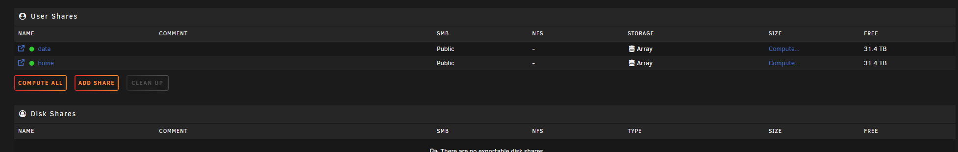

Unfortunately appdata, domains, system shares have not been created for my by default. The system is completly new and fresh just as of yeasterday evening, I have made no changes or started anything but the pairty check on my array and added and cache drive.
The pairity has just finished its works and everything seems fine, but these share you're speaking of ahs not been created.

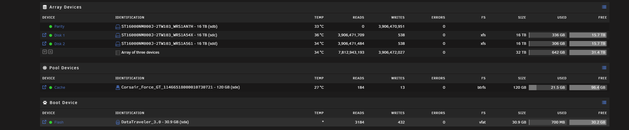

Here are the new diagnostics and the latest images of the system.
What am I doing wrong?
1 minute ago, trurl said:
Alright, let's try it. I must have missed this.
Any suggestions on what to do with my cache drive? Would you recommend puting docker paths on to the cache instead of the array?
Thanks
The paths you already have specified in those settings should result in them being created on cache.
/mnt/user/... are the user shares, which include all array disks and all pools.

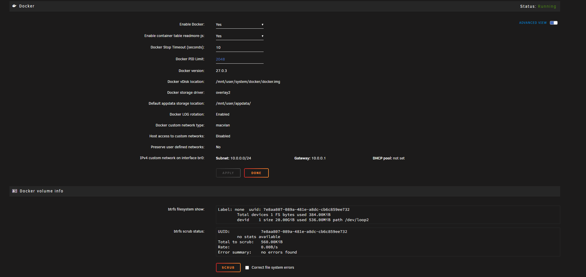

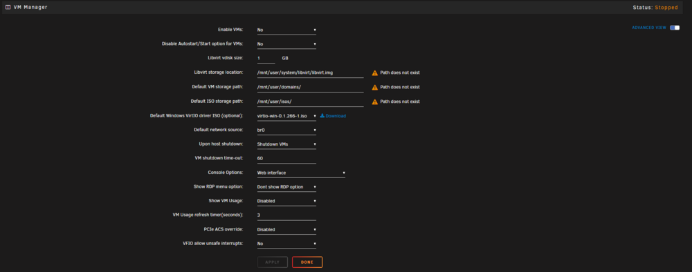

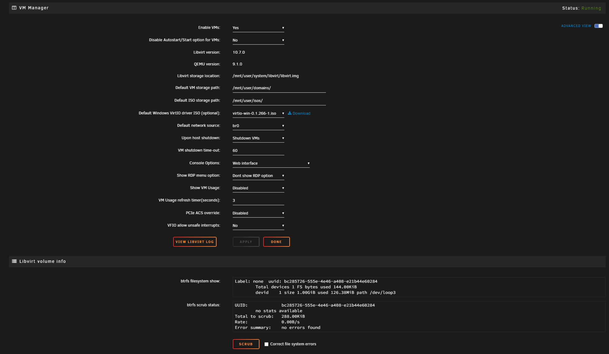

Enable Docker and VM Manager, then post new diagnostics
Thanks you.

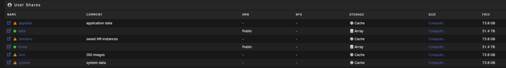

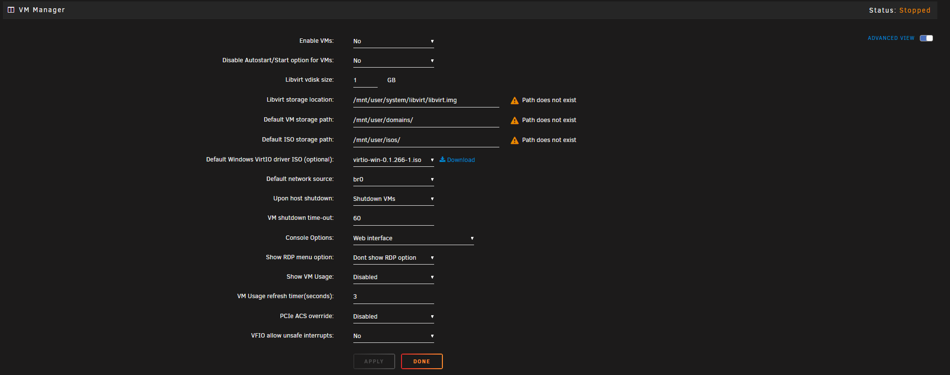

I took a bit of time because I was going through the settings trying to learn along the way. I hope I did set this up correctly.
Thanks again for helping out, very much appriciated :)
Edited by Tobbo
Looks good!

I just need to add a account that is not public to the VM's, I can see the warning in the system right now.
So if I understand this setup correctly now the docker and vm files will be shared on both the array and the cache, but the cache is preferred over the array as a first location for storage?
I guess it's time to setup my first docker container :)
Thank you so much for all the assistance it's been of great help and good for understanding the concept of how things work!
