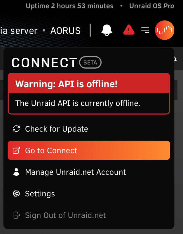

Red triangle with new version 2025.02.06.2108
A soon as I installed the new version I got a red triangle at the top of the UI.  Clicking on it gives "Warning: API is offline!".   In the settings it says "Disabled until you have signed in" but the Sign in button is disabled.  Log is attached.  Rebooting didn't help.  Uninstall/reinstall Unraid Connect plugin didn't help.  Running unraid-api gives "/usr/bin/env: ‘node’: No such file or directory".  At some point the settings page said I needed to add my internal IP to my unraid machine as an extra origin.  I did that and it didn't help.  Trying to register the server through account.unraid.net gives a "Sign in Failed" error.

I'm running into the same issue as well.
I tried to reload nginx which seemed to be fine. I then did a restart and got this...
root@AORUS:~# /etc/rc.d/rc.nginx restart
rc.nginx: Restarting Nginx server daemon...
rc.nginx: Checking configuration for correct syntax and then trying to open files referenced in configuration...
rc.nginx: Stopping Nginx server daemon gracefully...
│ id │ name               │ mode     │ ↺    │ status    │ cpu      │ memory   │
rc.nginx: Nginx server daemon...  Stopped.
rc.nginx: Starting Nginx server daemon...
Starting the Unraid API
ExecaError: Command failed with exit code 127: /usr/local/unraid-api/node_modules/.bin/pm2 start /usr/local/unraid-api/ecosystem.config.json --update-env
/root/.bashrc: line 22: bind: warning: line editing not enabled
/root/.hishtory/config.sh: line 9: hishtory: command not found
/root/.hishtory/config.sh: line 75: hishtory: command not found
/usr/bin/env: 'node': No such file or directoryrc.nginx: Nginx server daemon...  Started.
root@AORUS:~#

Hello.
Having the same issue with version 2025.02.06.2108. No issues before I upgrade. I wonder if you solved somehow? My server is behind traefik and authentik and I wonder if there is an endpoint that needs to go as unauthenticated or something since I dont use the unraid ssl/subdomain.

It seems to have taken care of those particular errors but I'm still seeing the API offline warning.
I execute this from a terminal to get it going again.
But eventually it stops again.
Just to add more info, the output of the command to get the api going again.
root@AORUS:~# /usr/local/unraid-api/node_modules/.bin/pm2 start /usr/local/unraid-api/ecosystem.config.json --update-env
[PM2][WARN] Applications unraid-api not running, starting...
[PM2][WARN] App unraid-api has option 'wait_ready' set, waiting for app to be ready...
[PM2] App [unraid-api] launched (1 instances)
│ 0  │ unraid-api         │ fork     │ 0    │ online    │ 0%       │ 174.5mb  │
root@AORUS:~#

In my case, I used to bypass the login form by commenting out the auth-request.php line in /etc/nginx/nginx.conf.
Since the update of the Unraid connect plugin, bypassing the auth caused the issue with the API warning. So performing an autologin solves it for me ( and most probably for everyone using a reverse proxy )
This was one problem solved, but I checked today and saw the triangle again so right now i am also on the same boat as you guys 😅 I saw that there are some reports on Discord about this too so it looks like a general issue. ( API working briefly after login but then shows triangle) i will have a look later to see what the problem is and if there is anything we can do to solve it.
I solved my problem.  The 'node' command not being found was the key.  I had a typo in my go file that was causing the PATH not to get setup correctly.  When I fixed that Connect started working as expected.

The part that was causing my problem was this:
echo "export PATH=$PATH:/tmp/bin:/usr/local/emhttp/plugins/tailscale/bin" >> /root/.bash_profile
Not escaping the dollar sign was causing the PATH to just be hardcoded to whatever it was when the go file ran.  The corrected version is this:
echo "export PATH=\$PATH:/tmp/bin:/usr/local/emhttp/plugins/tailscale/bin" >> /root/.bash_profile

I'm surprised we have seen any temporary fix or solution for this problem yet.  Seems like a significant issue the devs need to address.

With unraid 7.0.0 most of the above worked, and I could manually get unraid connect to run. But with 7.0.1, something has gone horribly wrong. After uninstalling and reinstalling the plugin, everything in /usr/local/unraid-api/node_modules/.bin/ points to something under /home/runner which doesn't exist.
I'm not sure how to proceed, though I'll try to dig as soon as I have time.
Maybe try this path for pm2. I haven't tried 7.0.1 yet but maybe this will work...
/usr/local/unraid-api/node_modules/pm2/bin/pm2
oh man. @rbroberts let me check with the team. We caught this issue during testing--sorry that it actually made it out, especially without an immediate fix/update.
funnily enough @Gex2501, changing the path we used for pm2 was part of the fix.
const PM2_PATH = join(import.meta.dirname, '../../', 'node_modules', 'pm2', 'bin', 'pm2');
i'm also seeing this issue, but on only 1 of my servers..
what should i change to get this fixed and where do i change this ;)
