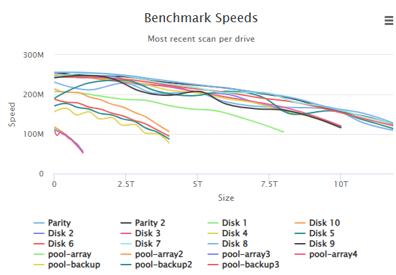

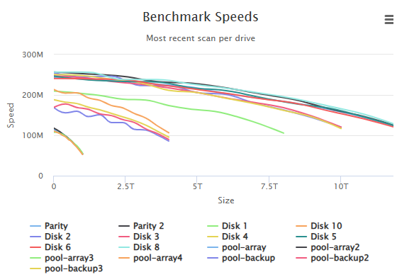

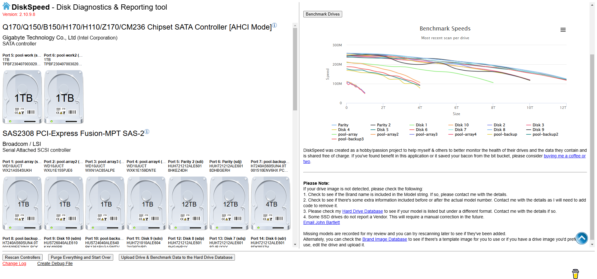

I said in the original post that I had ran Diskspeed on v6 months prior to upgrading to v7, then I ran it again a few days ago. The direct drive access looks identical between the two.
This is the drive speed from Feb 3rd, under v7

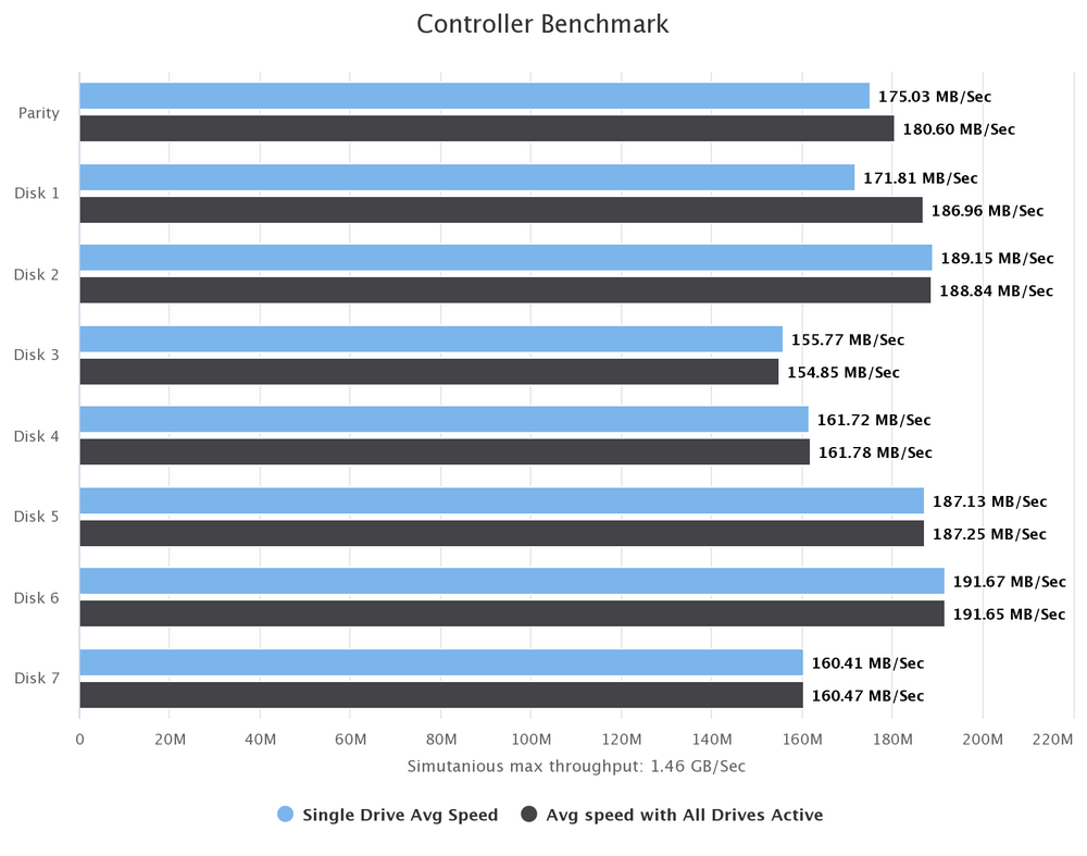

It's good to confirm there are no controller bottlenecks, it kooks like this:

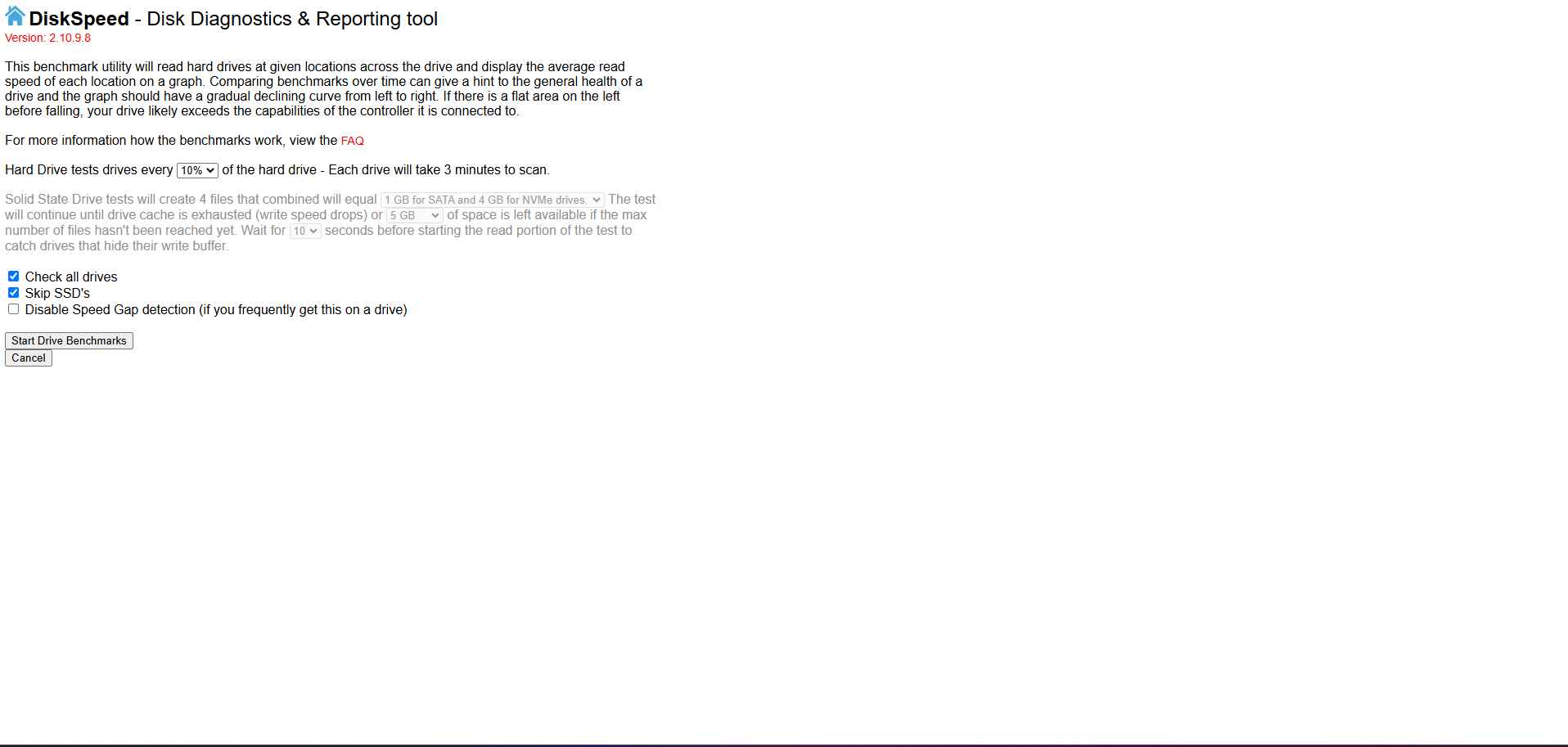

I don't see an option anywhere on it to test the controllers. I see Rescan Controllers, which reads the data from the controllers and drives, and I see "Benchmark drives".
If there's a "Controller Test" or "Controller Benchmark" link somewhere on one of those two pages, I'm not seeing it.
Screenshot2025-02-12171733.thumb.png.9d4e5bd3fb3e08bc42cb04b6622c64d7.pngScreenshot2025-02-12171753.thumb.png.a50879c3778853c92f885a79e8d26162.png
I just ran another benchmark. At no point did I see anything whatsoever about controller tests.

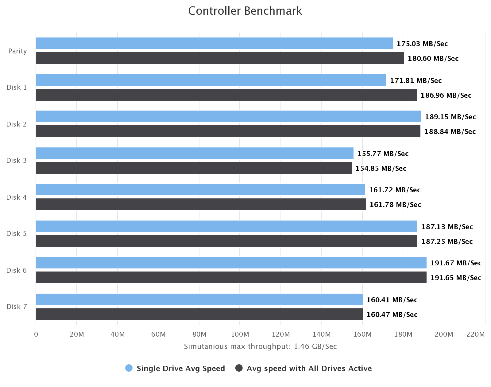

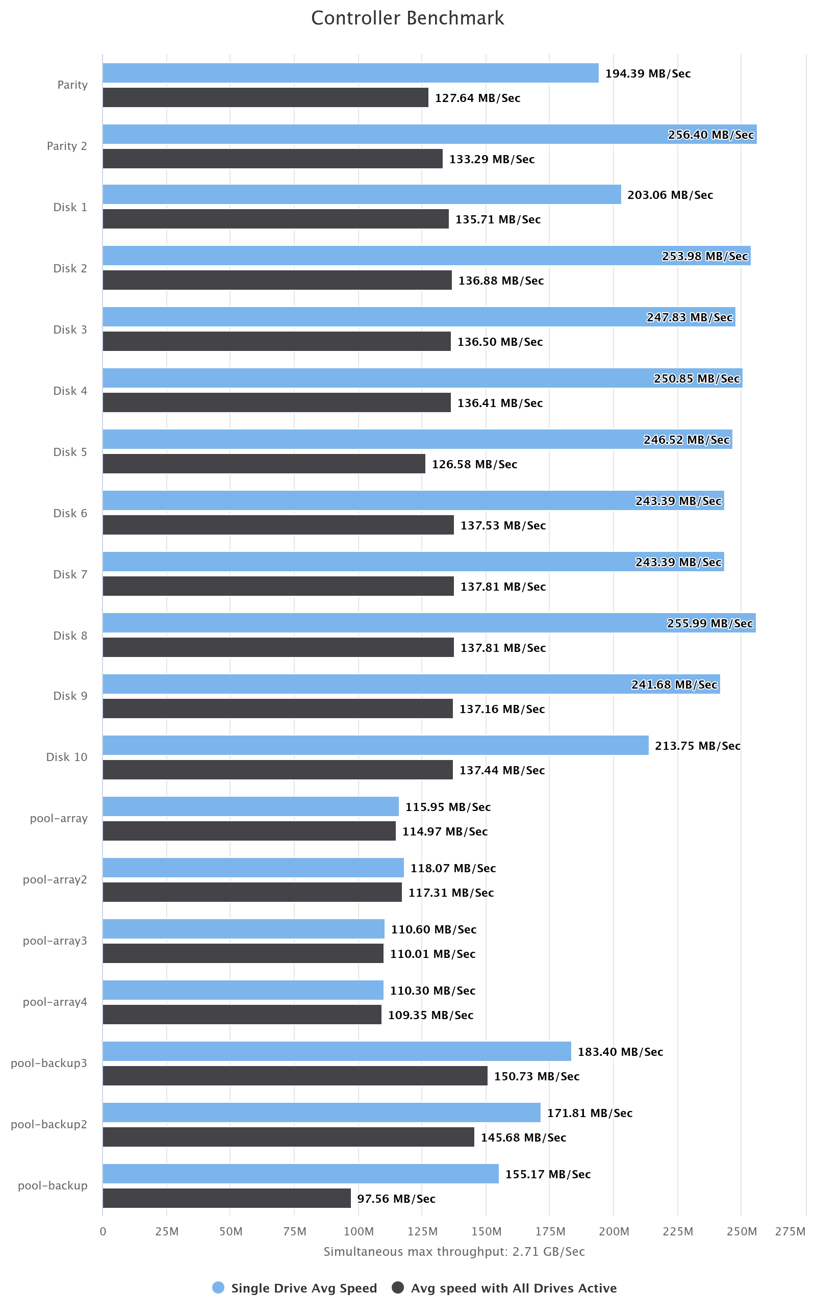

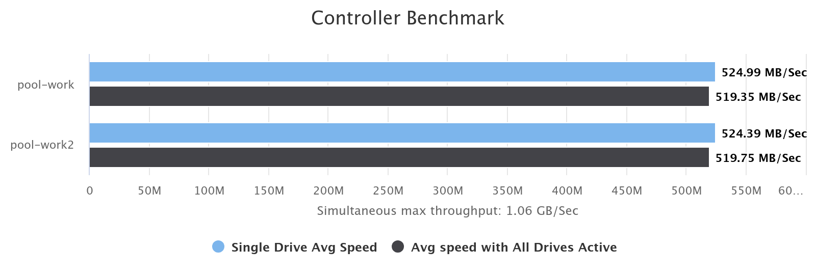

I don't have the container installed to confirm, but IIRC you click the controller, then you'll see the test option.
I found it. There's a really small "I" in blue beside the controller name.
Tests do show a controller bottleneck, but still a lot faster than the speeds you are seeing, so something else is going on.
