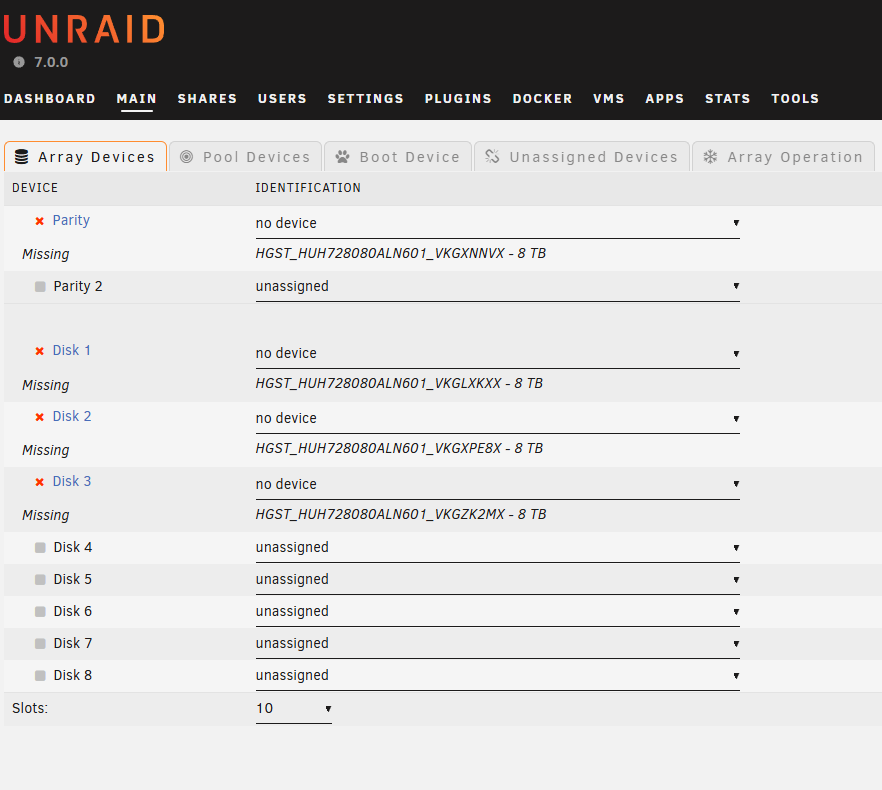

I have an unraid box I installed in 2019. Bought a surplus 3U server and it has been running flawless. I have performed updates in the past and today I tried to apply update 7.0.0. When the update completed all my array devices show "no device" for my drives.
Searching I found other posts with similar issues. My setup works on 6.12.8 so I am not sure the problem is hardware related. There is a BIOS update for the motherboard but the fixes appear to not be related to my 7.0.0 update issues.
Any assistance is appreciated.

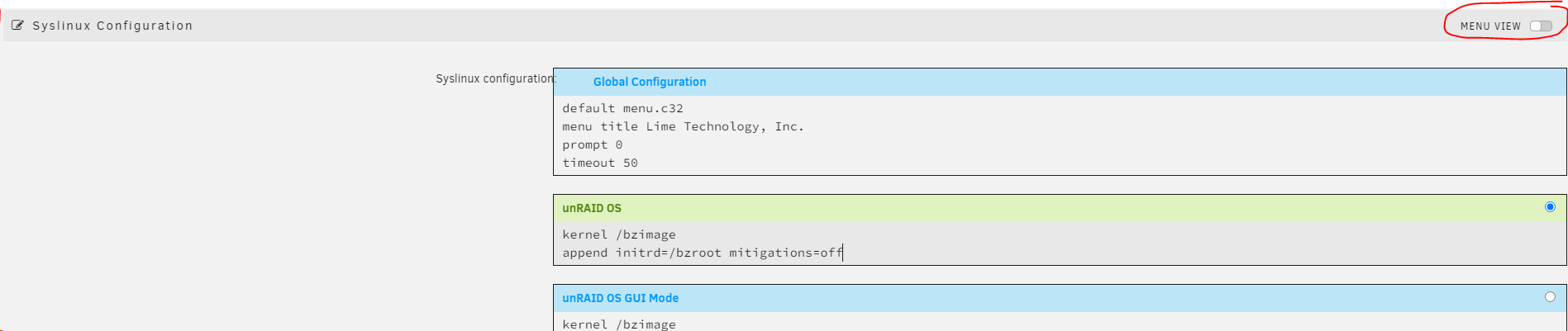

Another thing worth trying, click on the flash drive, then scroll down to the syslinux configuration section, and add this to the default boot option after /bzroot:

Yes missed that you add it below, it may be easier if you switch to menu view, then add to the default boot option, the one in green, after /bzroot like the mitigations option I have.
If it works, you can also add it to other boot options you may want to use in the future, like safe mode
Not quite - it needs to be added to the end of the append line rather than on a new line    You need to do this for each of the boot options you might want to use.
