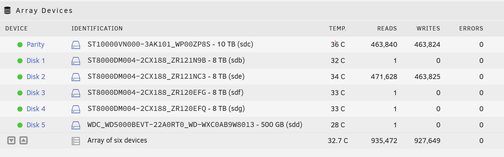

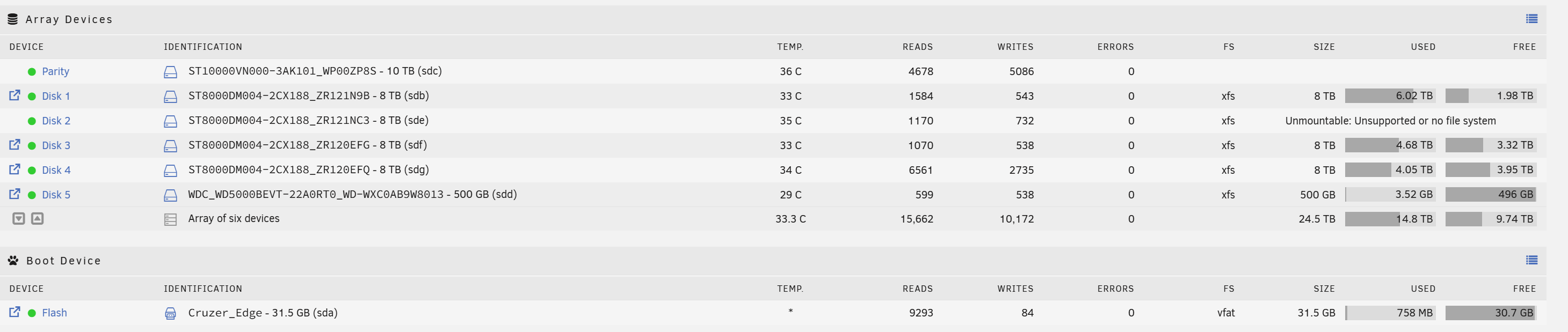

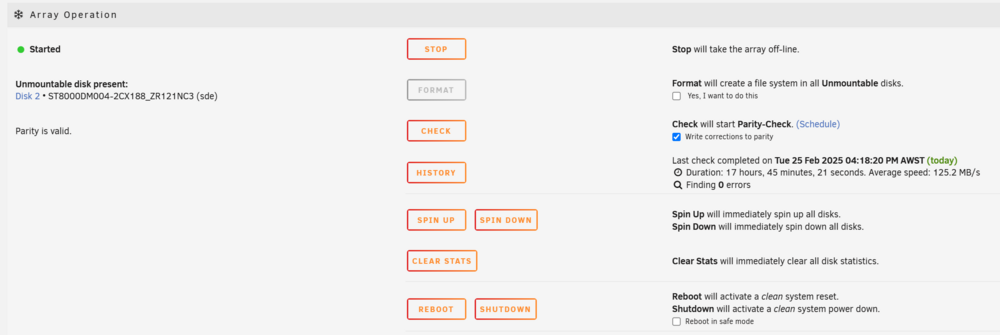

Not that my original issue is resolved, but:
Now that I have rebuilt a whole drive, can anyone explain this?
Disk is 100% rebuilt, but unmountable?
Was the disk showing as unmountable before the rebuild?  Were there any errors during the rebuild?
Regardless you should run a Check Filesystem on that drive.
It showed unmountable some attempts, but happily wrote to it.
Other times it seemed fine.
It wouldn't let me format the drive before rebuilding to it; that option was greyed out no matter what I tried.
It will rebuild a disk that was unmountable if that is what you mean by "wrote to it".
Probably because you didn't check the box to enable formatting. And a good thing to. If you format a disk before rebuilding it, a formatted disk will be the result of the rebuild.

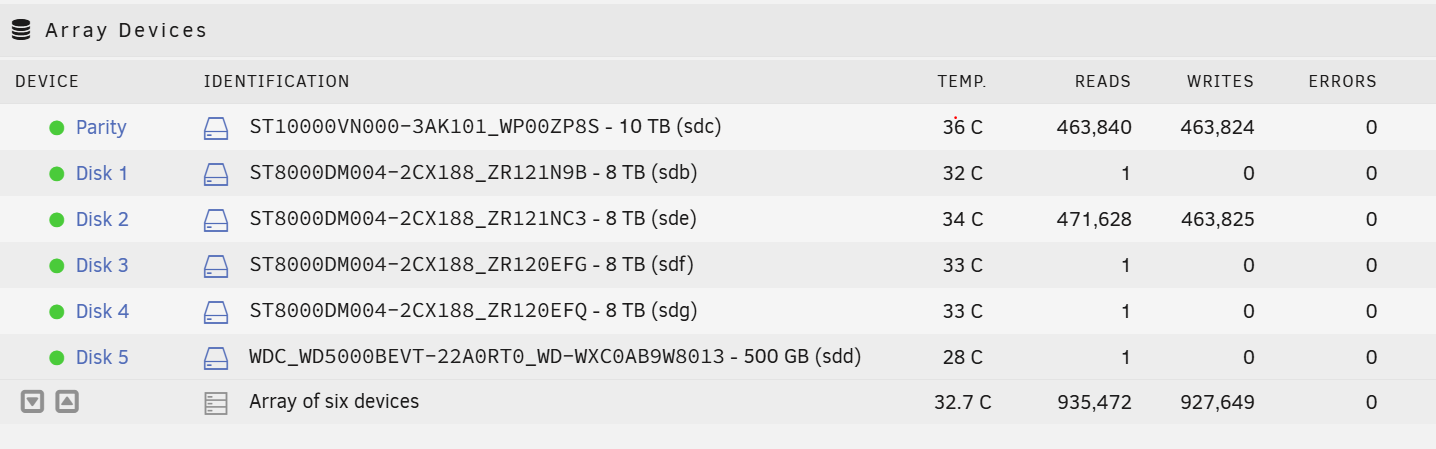

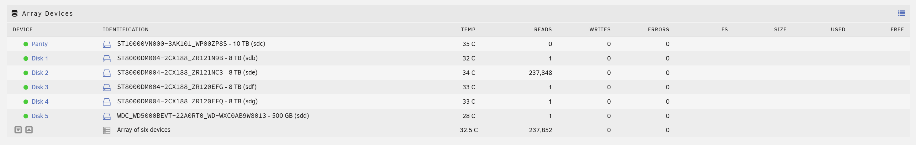

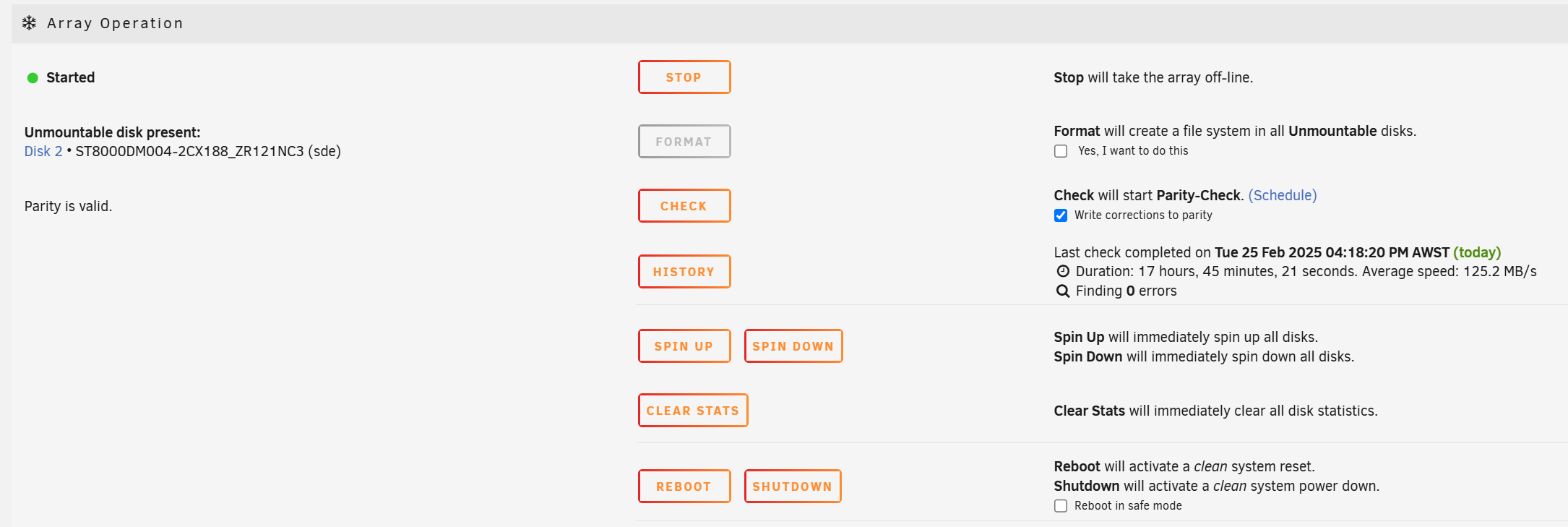

Oddly, just running the filesystem check, now it (Disk 2) appears as:
Am I correct in thinking that nothing changed and now it magically mounts?
You are still in Maintenance mode, so nothing is mounted as you can tell from the fact that no disk is showing anything in those last columns.
Did you do check filesystem without -n? Can you post the output?
