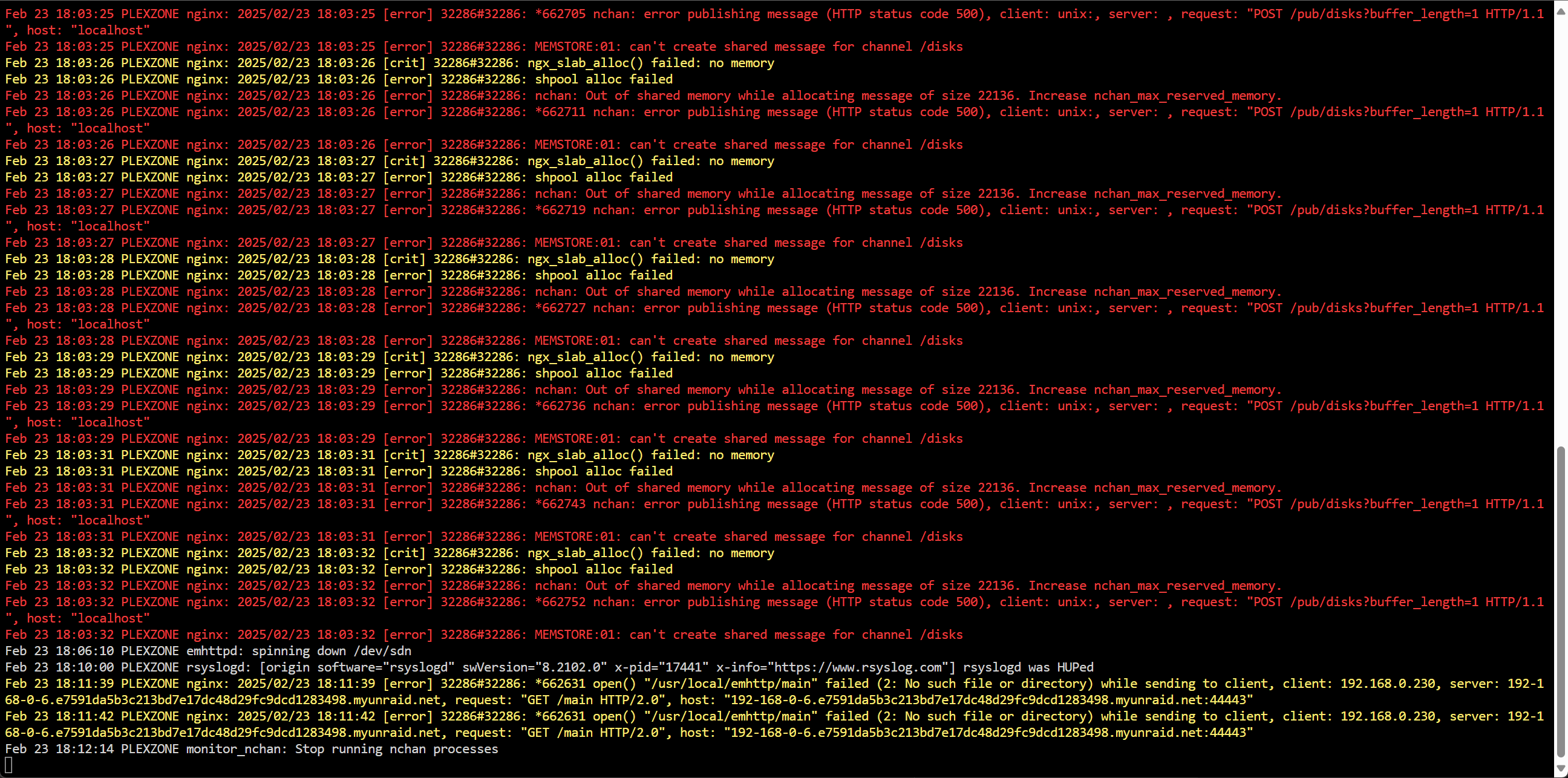

And some memory problem? (I have the cache plugin installed and I have 128G of RAM with a load of 50-60%):
nginx: 2025/02/23 18:03:13 [error] 32286#32286: MEMSTORE:01: can't create shared message for channel /disks

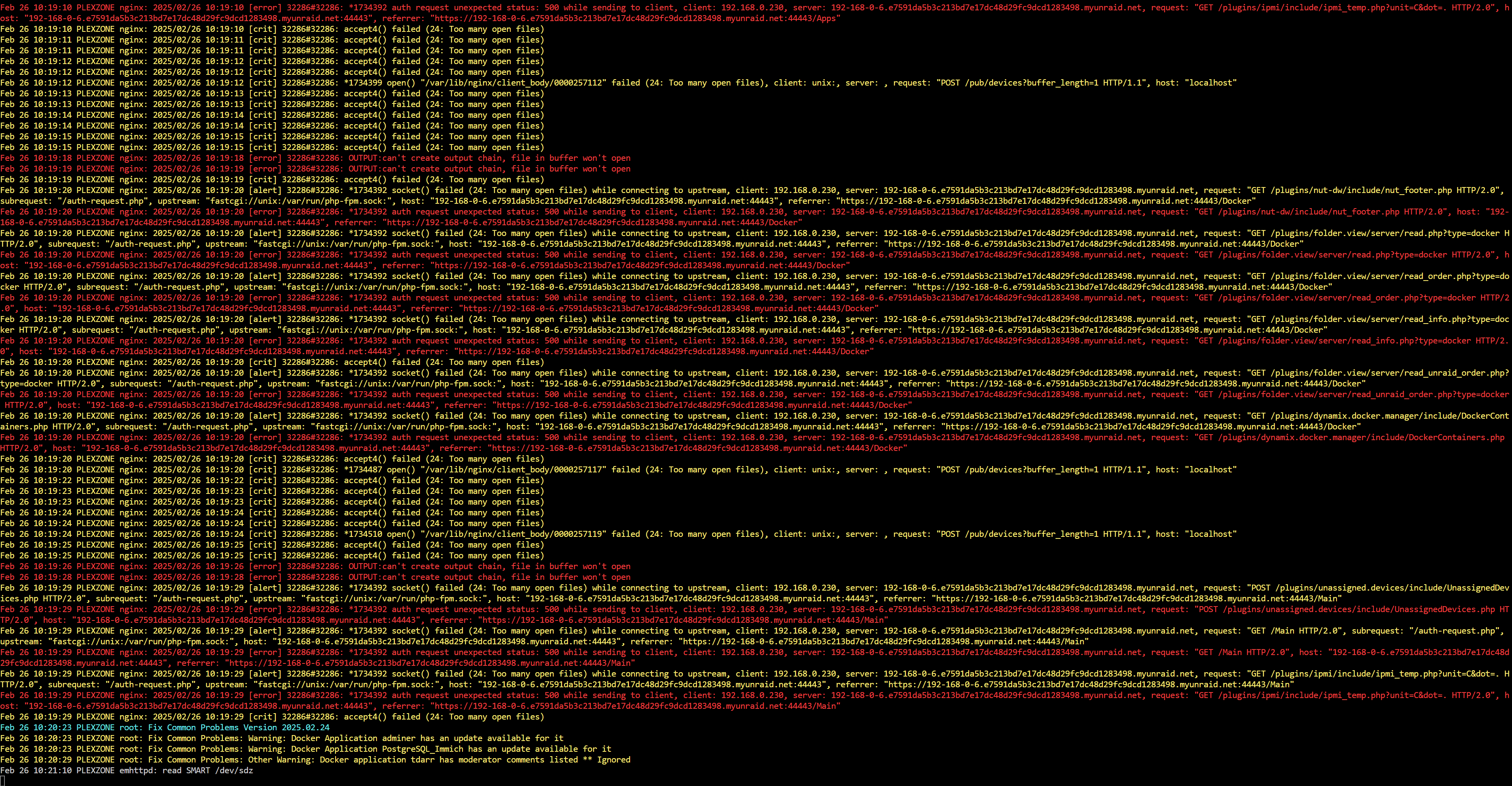

But the error below is back and the UI for the Docker section is unresponsive?
I have included a new diagnostic file below (I haven't installed any new dockers! but maybe some update have broken something? or the mover running is generating these errors?)

1 hour ago, casperse said:
so I just deleted the plugin and the mover works again.
The update was for the Connect plugin, those errors are not from the mover plugin, though the mover not working is usually that.
server: , request: "POST /pub/disks?buffer_length=1 HTTP/1.1", host: "localhost"
Feb 23 17:53:58 PLEXZONE nginx: 2025/02/23 17:53:58 [error] 32286#32286: MEMSTORE:01: can't create shared message for channel /disks
Feb 23 17:53:59 PLEXZONE nginx: 2025/02/23 17:53:59 [crit] 32286#32286: ngx_slab_alloc() failed: no memory
Feb 23 17:53:59 PLEXZONE nginx: 2025/02/23 17:53:59 [error] 32286#32286: shpool alloc failed
Feb 23 17:53:59 PLEXZONE nginx: 2025/02/23 17:53:59 [error] 32286#32286: nchan: Out of shared memory while allocating message of size 22132. Increase nchan_max_reserved_memory.
For these, try upgrading to 7.0.1, there's a change that may help.

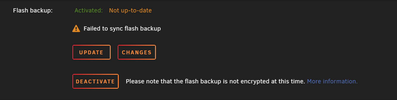

Yes it seems that v7.0.1 helped, but after update I keep getting this:
Any idea why the Flash backup stopped working everything else looks fine 🙂
Did you try pushing the UPDATE button?
Yes update buttom more than once just keep turning the "time" icon for a day

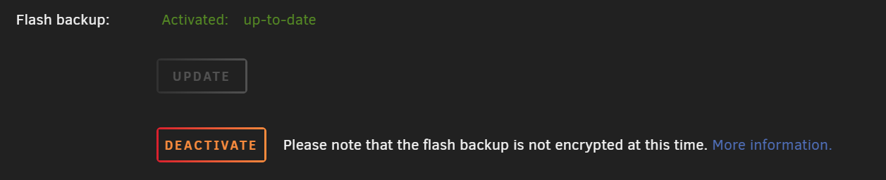

Seems its working now. Maybe some connectivity problems to connect?
