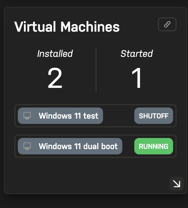

Unraid connect displays the correct information, so this looks like an unraid UI issue on some sort.
