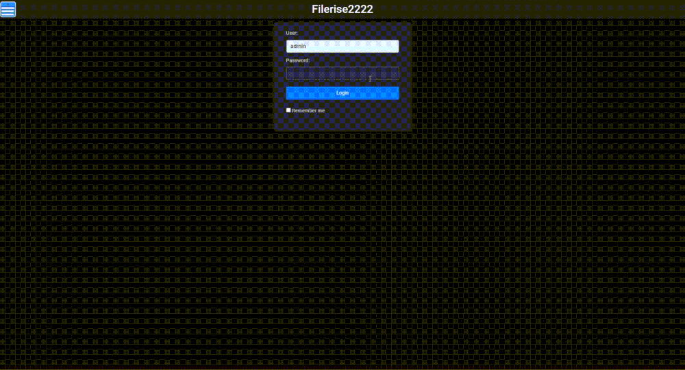

i dont know , i have try it now with edge ( this one is never in use ) but here the same thing. the upload fails if i drag and drop a file bigger then 2 mb
- if is the browser smaller then fullscreen the slider jumps wild while change the size
Sorry it was my fault. I changed the dockerfile from ubuntu 22.04 to 24.04 few days ago which increased the php version from 8.1 to 8.3. This made the TOTAL_UPLOAD_SIZE param not work. This is now resolved.

i dont think the issue comes from cache something its maybe from the slider himself, but this issue is only if i have the browser in smaller windows then fullscreen, i have updated it again before creating this gif. also  i think the conection from  my unraid is maybe little bit slow, but that is not the reason of the bugs

I adjusted headerTitle so it display globally and update properly on page loads
I adjusted max columns depending on screen sizes so that twitching issue you experience should be gone when columns didnt fit in window.
https://github.com/error311/FileRise/commit/853d8835d94809b52de230141b9f43c053ac004a
the fix for the header works. but the galleryslider still jumps

@Eichhorn I figured out the twitching/glitching issue with gallery view slider. It occurs when the browser scroll bar goes away. I haven't found a good fix I like yet but still looking into it.
