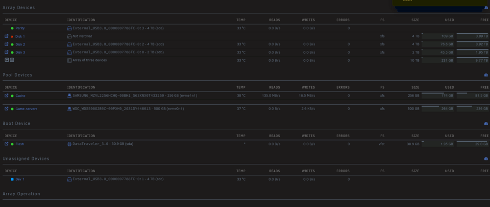

It looks like this
First, it will report that disk 1 is disabled, but in reality the whole JBOD would be disconnected, resulting in all of the devices to be missing. So when I turn the JBOD on and off, the disks will be back like what the screenshot shows with the disabled device recognizable.
EDIT: To add context, I look at System Devices to confirm that the whole JBOD is disconnected. So do you reckon I have to rebuild the disk by unassigning and reassigning it back? I'm quite terrified to do that actually cause it might ruin the disk/s if it again disconnects the JBOD if I start the array.

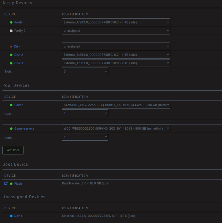

Disk1 is really disabled, that will not happen just because the drives were missing at boot. There must have a been a write error in the past. The first step is to rebuild disk1
Start the array with disk1 unassigned and post new diags to see if the emulated disk is mounting.

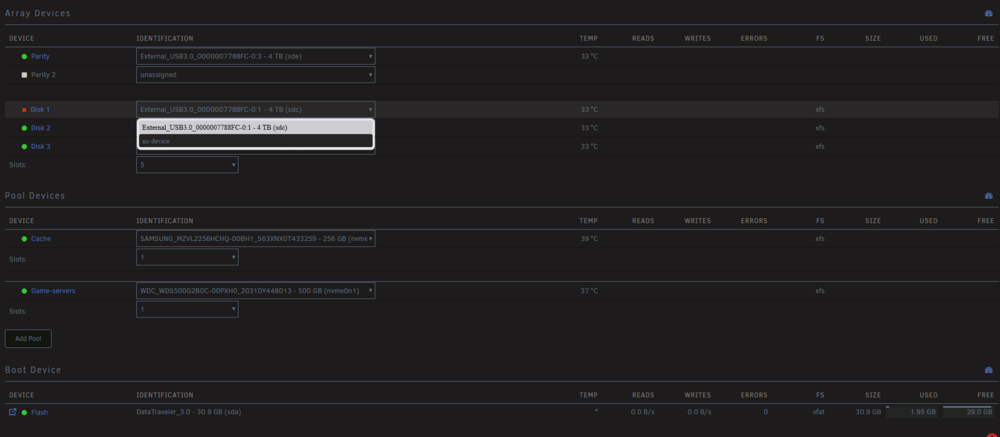

This is what it looks like after unassigning the device and starting the array. Also attached are the new diags. I've stopped the array since and tried reassigning the drive but it wont mount, so let me know what should I do next.
sefserver-diagnostics-20251226-1640.zip
Edited by Sef Sagun

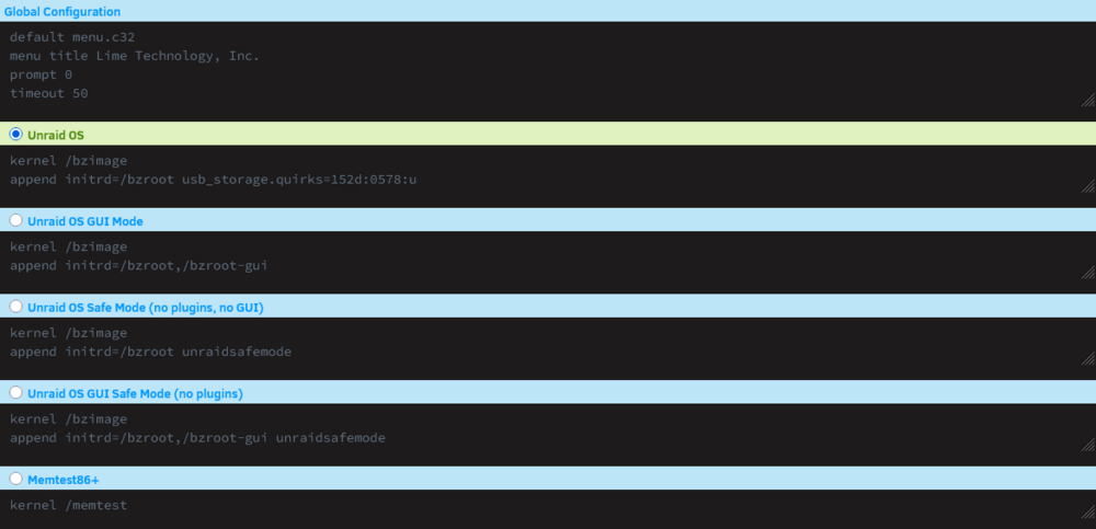

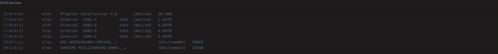

Okay, so I think I've found out why the unassigned device is not mounting. As you can see in the screenshot I sent above, it clearly says its one of the 4tb disks. But when I check the identity of the device, its the 2tb disk. So this goes back to the issue of the disk ids changing. The JBOD also disconnected, I think, since the mount location changed from sde, sdb, sdd to sdf, sdg, sdh.
I do have the usb_storage.quirks= set in the syslinux as seen below, but yeah. I dunno why it keeps disconnecting or what.

The quirks are correctly applied; and none of the USB devices is using the UAS driver, so the issue is not that. It's just a USB enclosure that won't work correctly with Unraid, if you really need USB, I'm afraid you will need to try using a different enclosure.
