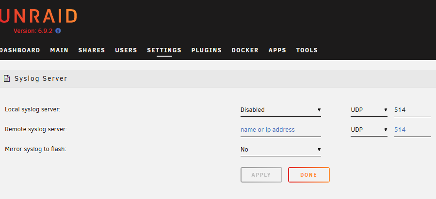

This is how it currently looks.  I've also tried the "Mirror syslog to flash" settings and using the remote syslog server to point to my NAS.

With these settings the syslog server is just listening for syslog messages from OTHER servers.
If you set the Mirror to Flash option to Yes then you should start getting the syslog appearing in the 'logs' folder on the flash drive.
If you set the Remote syslog server setting to your servers IP address then you should get a syslog file appearing  in the location set as Local Syslog server, although maybe you have such an old Unraid release this setting is not available so not sure where it gets put.
I wonder if there is an issue with the very old release of Unraid you are using and Syslog Server.   With current releases there are a lot more settings relating to the Syslog Server.

Even after setting "Mirror to flash" it doesn't show a logs file or folder on the flash drive.
And when I say there are no logs, I mean there are no logs even when clicking the log button on the GUI.
I want to avoid trying to upgrade again for now because the problem happened on this version of Unraid and when I had upgraded to 7 there were some odd problems with the connected Plex server being unable to find media.  One problem at a time 😅 With how you worded your message I'm starting to think that the syslog settings were a red herring.
They could well be.    The 6.9.2 release you are running is about 3 years old and a lot has changed since then and I am not sure of any of them are relevant to your current issue.
