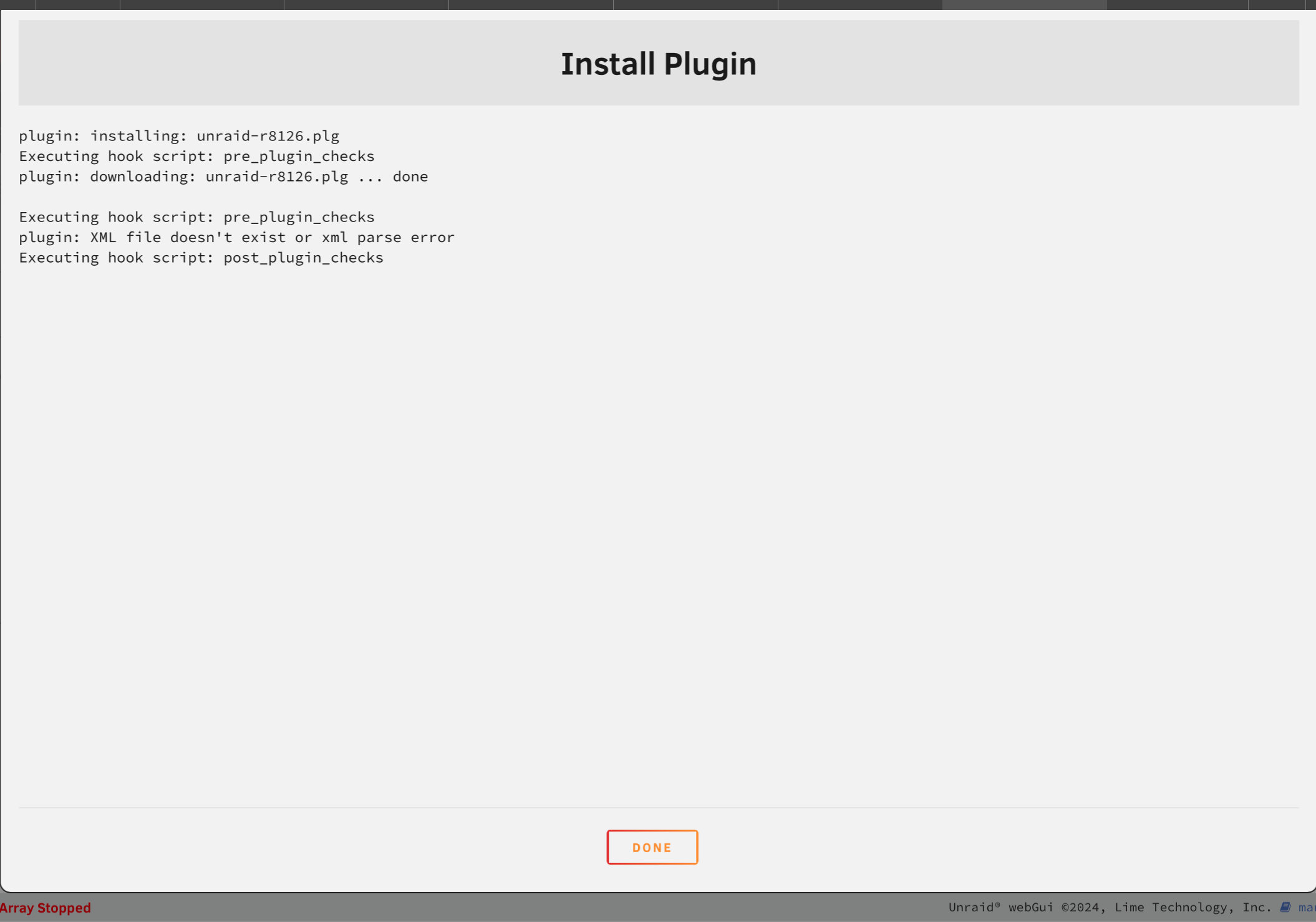

Since the machine that actually has the missing network device does not have the GUI, the suggestion was to put the thumbdrive on a different computer temporarily and download and install the plugin there. I attempted this on my other UnRAID box, by manually adding the plug in, however the plug in failed due to an error, as shown in attachment.
I made the same attempt for the unraid-r8125.plg just to make sure the one I tried was not a half done one, however same error... And to be CLEAR, I checked and no plugins were installed after I ran either script.

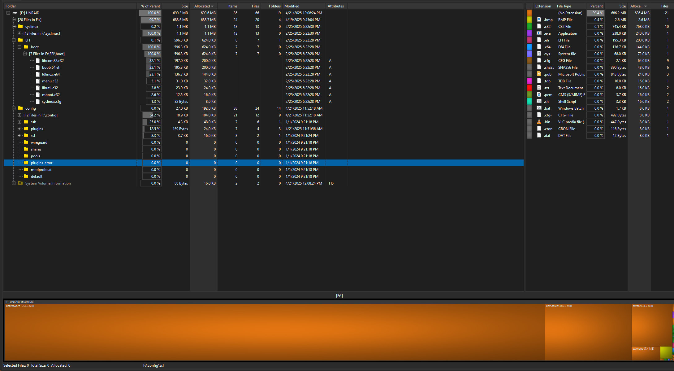

OK, so interesting update. I have no /logs or /boot/logs or EFI/boot/logs directory, or diagnostics.zip under any of the root level directories on the flash drive. See attached screenshot...
I have booted to UnRAID multiple times on the machine with the missing network adapter, as well as one time on my fully functional box, that has internet connection, and where I installed a "trial license", and then attempted the plugin installs, since it had networking. So this UnRAID thumbdrive has been active.

There's no driver for the NIC you have in the stock Linux kernel, you can install the Realtek 8126 plugin, the easiest way is to boot the flash drive in an older PC with a supported NIC, install the plugin, then boot with the server.
Did you read the thread? I tried that… See the giant screenshot where it failed…
Edited by BitPusher
Link to post above…
Sorry, missed it, you should try again using a different flash drive, just to rule out any issues, and if it's the same, report the problem on the plugin support thread:

Just a heads up, the issue was that manually adding the plugin (as described in other posts), was not working. This was a clean install, so after I added Community Apps (on the machine with internet access), and searched under “realtek” in Apps tab, then installed the correct version (r8126) there, plugin installed fine.
eth0 is now found and IP is assigned, and GUI is accessible.
