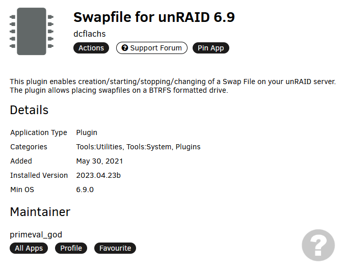

Thank you for this. I am starting by adding the memory limit function to many containers. Follow up question,
I see a Swap plugin in the CA, but it shows only or 6.9, not 7.0. is the swap function possible on 7.0?
one of my machines is hosted off-site, so adding ram is not a quick change.
it came out during 6.9 it works on v7 and above.
when I say swap plugin I mean this in the ca:
note the "Min OS" you need to be running v6.9 or above. that why it has 6.9 inthe tile as well.
