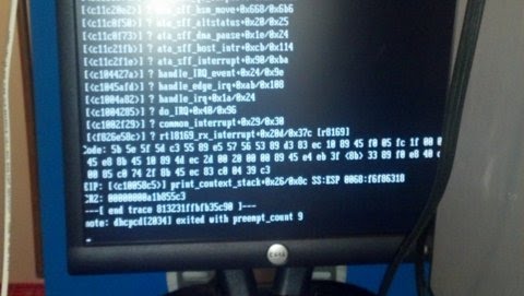

I lost power to my house.  After this, my unraid server will work for a while (about 20 minutes or so), then it completely disconnects from the network.  The server "box" is still running, but there is a flashing green light and an orange light for the network connection to the machine.  I took a screenshot of the server's user interface.  The server does not respond to keyboard inputs.
Does anyone know what this error is?

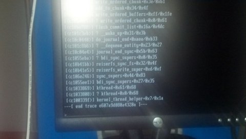

Yikes!  A different set of error messages.  And, control-C does not work.
