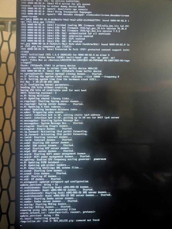

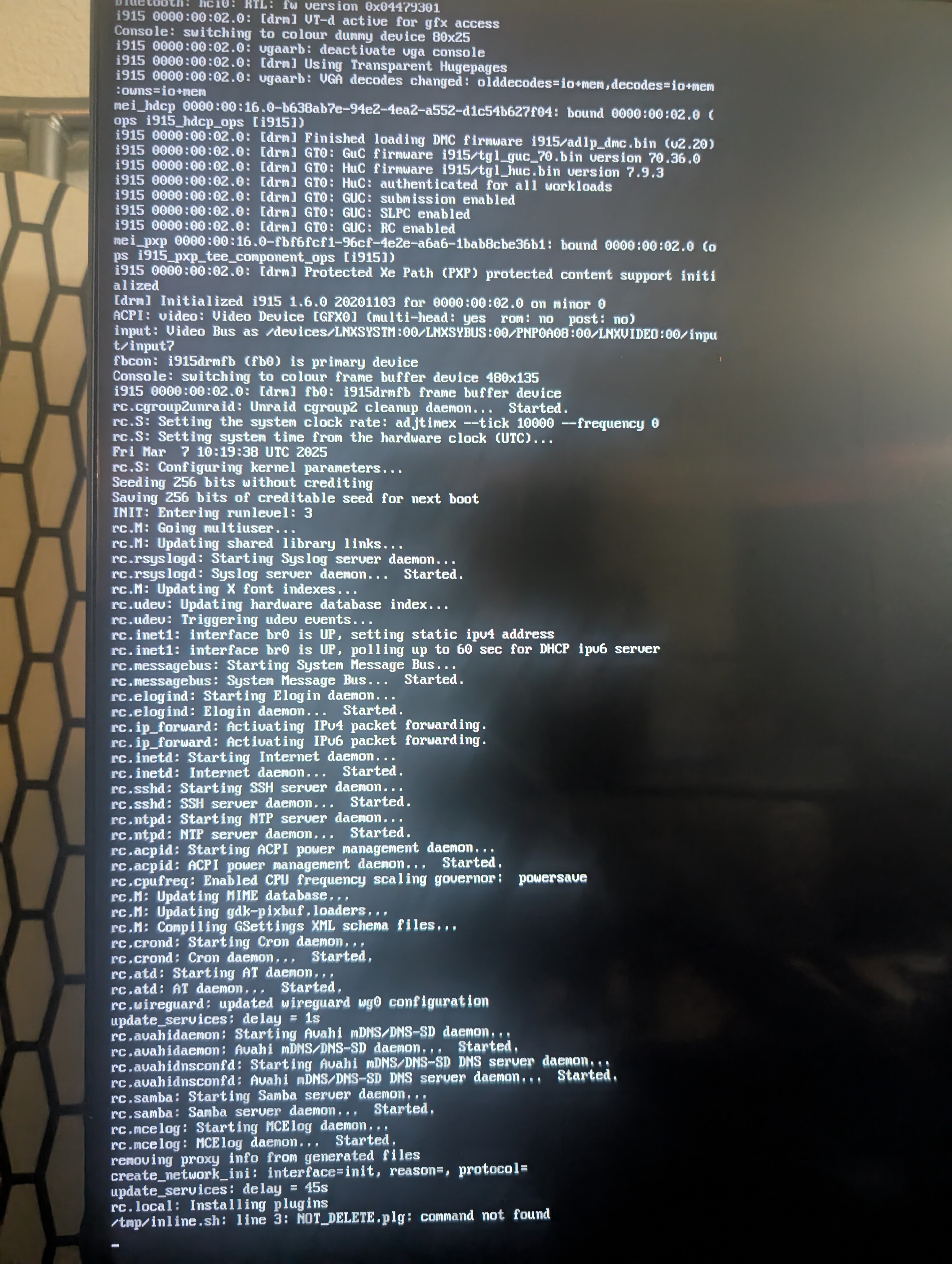

When starting up my Unraid server it gets stuck on
/tmp/inline.sh: line 3: NOT DELETE, plg: command not found
and does not go further in booting.
I can boot the server into Safe Mode, start the array, Docker, and my Home Assistant VM just fine so I suspect that it's something going on with my plugins.

If it boots in safe mode, rename and *.plg files on /config/plugins and retest, if it works, you can then try adding then back one by one.

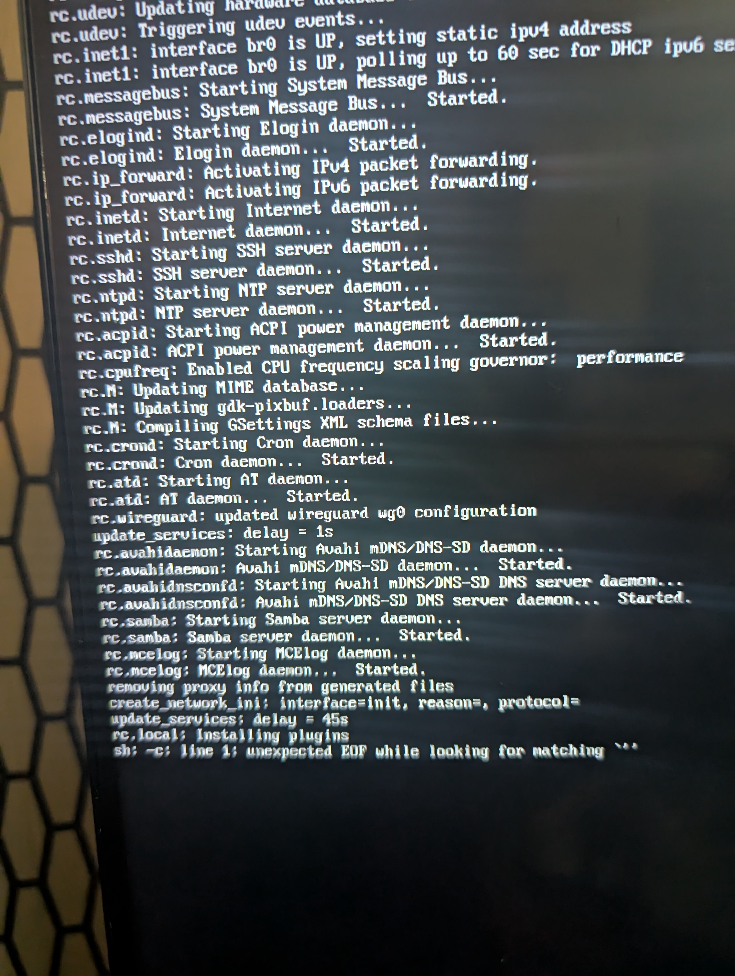

*Edit:* I prepended all the *.plg files with "0-" and the server hung at the same point during boot, but with a different message:
sh: -c: line 1: unexpected EOF while looking for matching `''
You need to change the file extension to be something other than .plg.   It sounds that this is not what you did?
Nope, it's not. I prepended the file names, not the file extension.
I'll reverse all that, change the extensions, reboot and see what happens.

I changed the extensions and rebooted, the system booted normally.
Should I revert the extensions, manually add the plugins, and reboot or just revert the extension and reboot the system?
You can just revert a few at a time and see it boots, until you find the problem.
